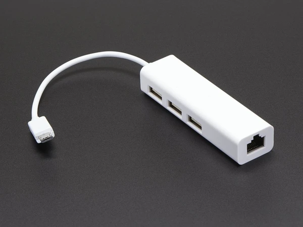

I couldn't get it to work either it kept freezing and ethernet wouldnt work with the 4k firestick I bought a fire tv cube and it works brilliant I have a u green USB hub with ethernet with a 128gb flash drive connected
Thanks. I’ve got a UGreen hub on order - did that setup not work with the FireStick then? If not sounds as if I need to get a cube instead.
No it wouldn't work with the firestick but worked first time with the cube. I just felt it wasn't getting enough power to it I had given up I bought a cube and thought I'll try it with that and works great
Great thanks. Have also ordered a 5V power cable to give the USB hub a bit more power but if that doesn't work then I'll look to getting a cube instead.
