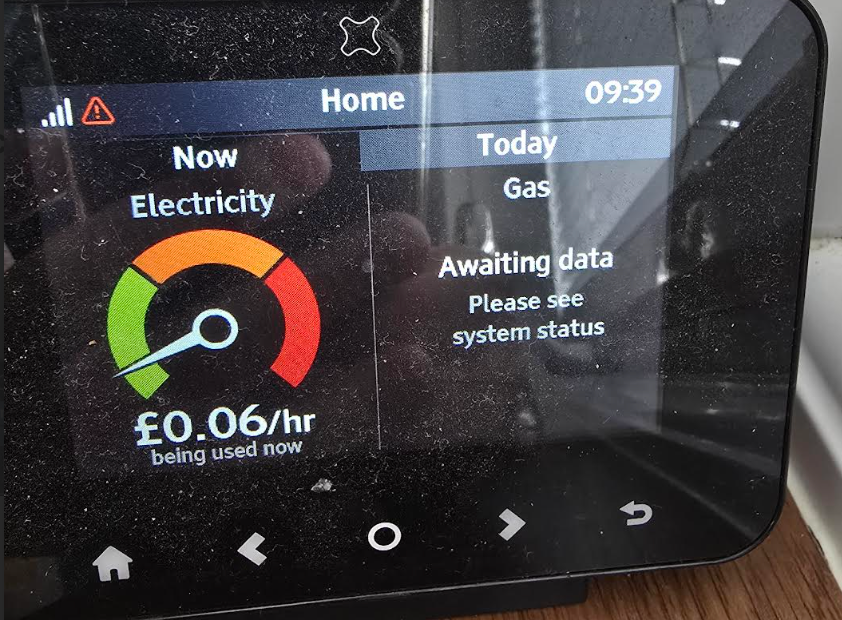

Our gas reading still doesn't make it to the display either still stuck on awaiting data.
Been like that since we got it.Octopus doesn't seem interested 🤔

Also my Ivie Bud instantly picked up the meter and now its showing £00:00 that's the first time in 6 months it's changed.

Gas smart meters are notoriously hit and miss. Once they stop waking up and stop connecting it’s almost always the case they have to be swapped. I know the industry now has something called Alt-Han which uses the internal wiring of the house to transmit the data. Just like a broadband booster that uses the power cables in your house.
