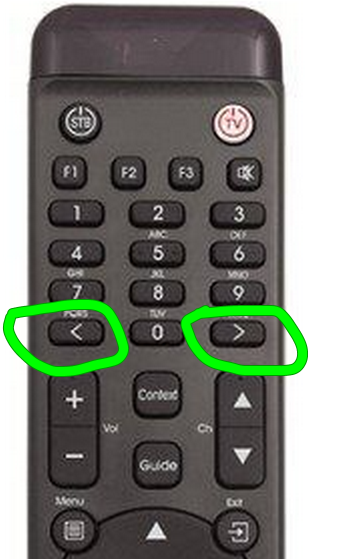

My understanding is that to switch between bouquets you use the < (pqrs) > (wxyz) buttons and for me, there's nothing to change as All is the only one.

From above it looks like I have the bouquets actually! Looking at the WilloBuild pdf the prev < and next > buttons should move between the bouquets but they do not on my Formuler F1:
Any thoughts on why the buttons are not working? (The worked fine with my previous GrogBuild)
