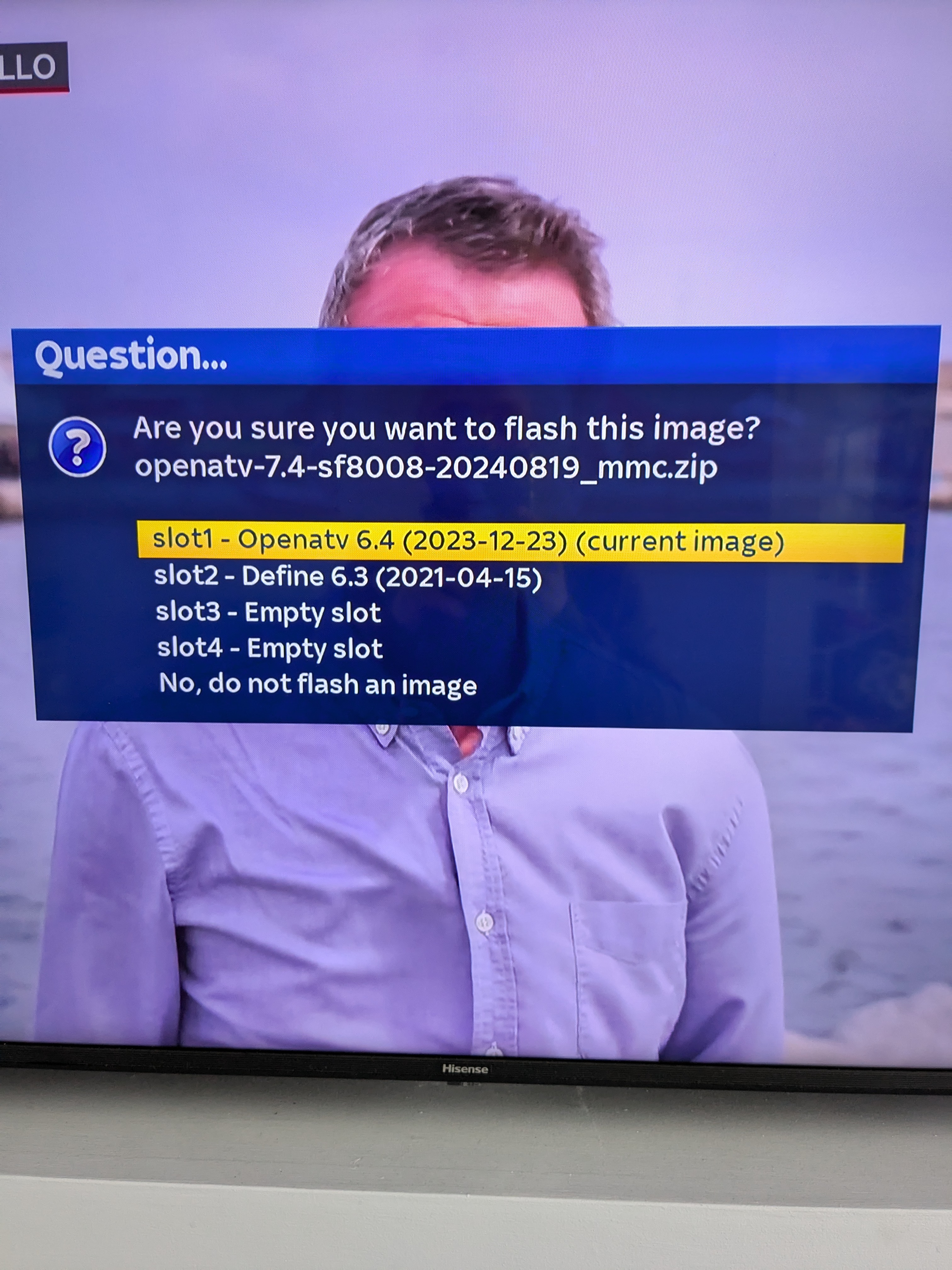

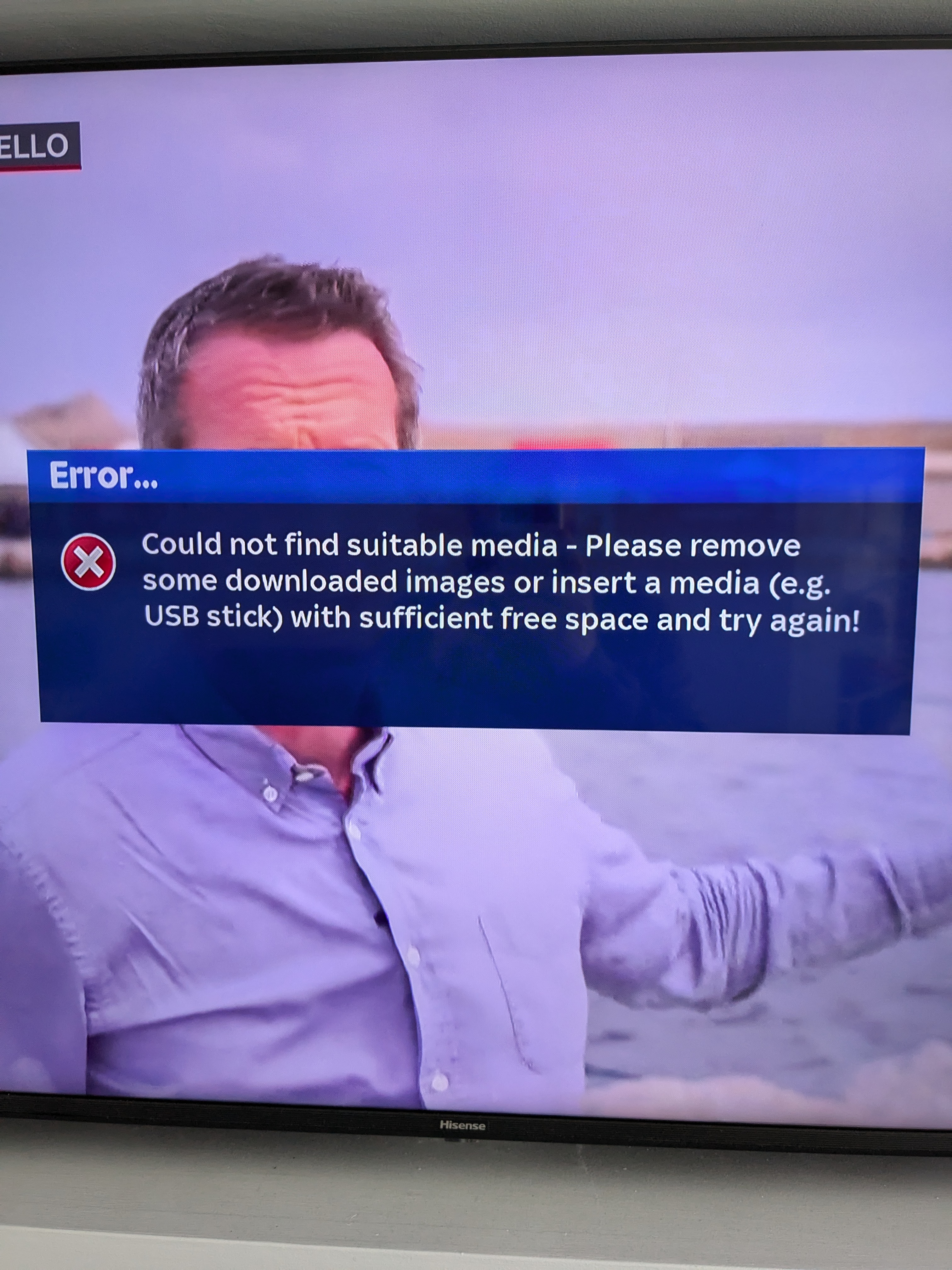

I think all of this may be to do with my 16Gb USB stick plugged into the back of my box. Tried to flash 7.4 online into both slot 3 and 4 of my box but get this error coming up. Surely 16Gb is enough for a couple of images?
Not sure what to do next without losing my existing setup? Also, what is define 6.3, is this required? Thanks

Yeah pretty sure I done that when installing Grogbuild. That's the usual procedure from Grog, WB etc.
That was ages ago the stick will be full since then. Take the thing out of the box format it again then remount and initialize it in the box before flashing openatv 7.4. Its not rocket science.
Put your receiver into deep standby, remove USB stick, reinsert it, switch receiver on again.
Then run the command I posted earlier.
You need to have a mounted storage device. I am 99.9% sure a fat32 device can be used by the "flash online" process. But that is besides the point, you formatted/initialised it in ext filesystem before.
The advice to keep formatting the device without establishing it is a filesystem issue is misplaced.
Define 6.3 is the other operating system not E2 leave that alone.
Thanks everyone for your help. All up and running now, it was obviously the USB stick. A low level format, initialise then mount and it was sorted. Still couldn't get Vix through Open ATV 7.4 but managed to FTP the Openvix MMC after sorting the USB.
