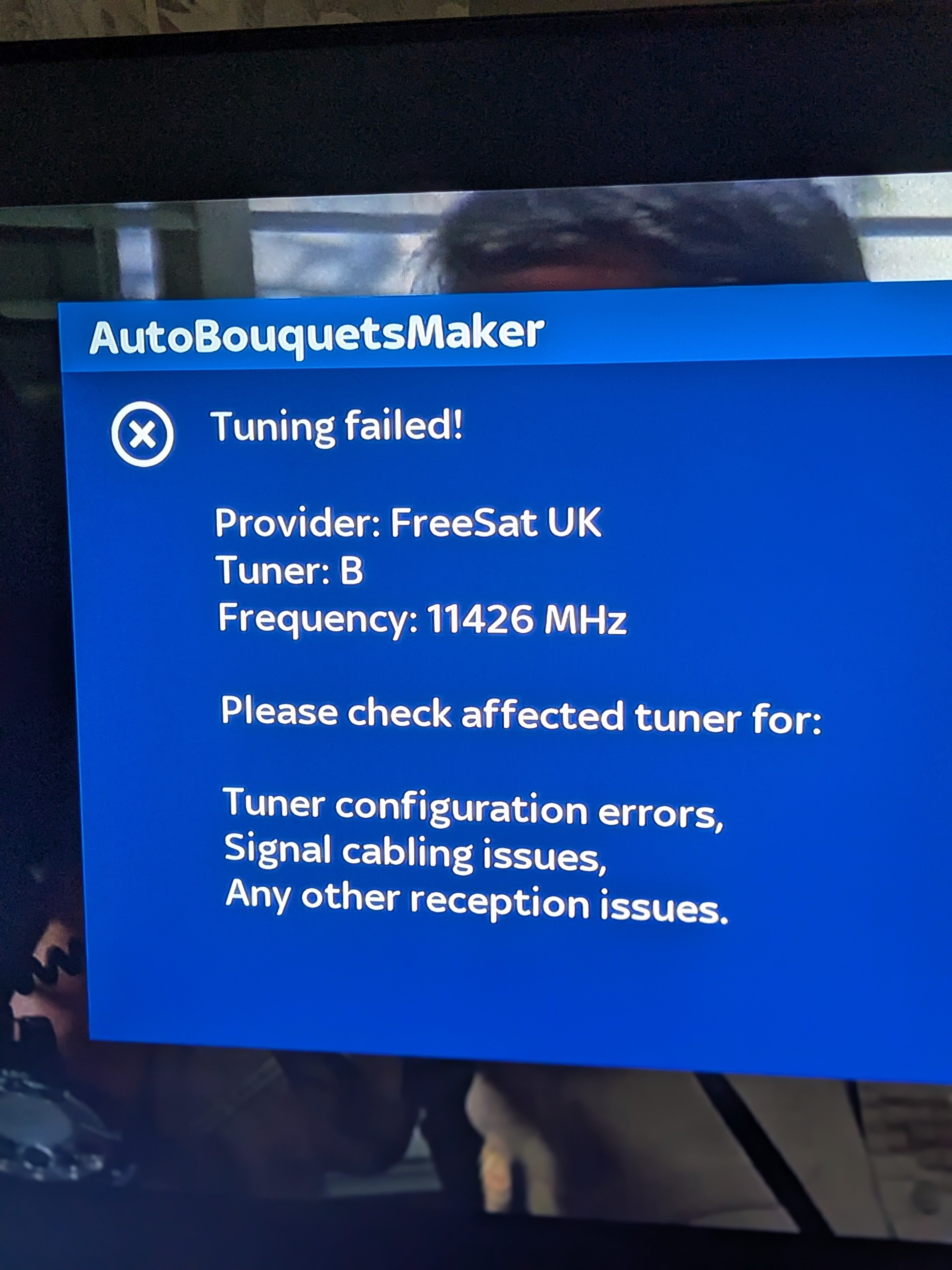

I know this is probably my fault, but when doing the autobouquetsmaker scanner I get this
You can check that frequency and see if you get a signal go menu, setup, tuners& scanning, signal finder, tuner make it B ie toggle with arrow key right, arrow down to tune and arrow right to change to user defined, then system make it dvb -s, frequency type in 11426, polarisiation make horizontal, symbol 27500. now you should see signal bar fill up. press green. You should get freesat and a few others but if nothing check cable at rear etc
it may be slightly different in your box as I dont know skin but you get the idea.
As an aside I would not use Freesat in ABM.
