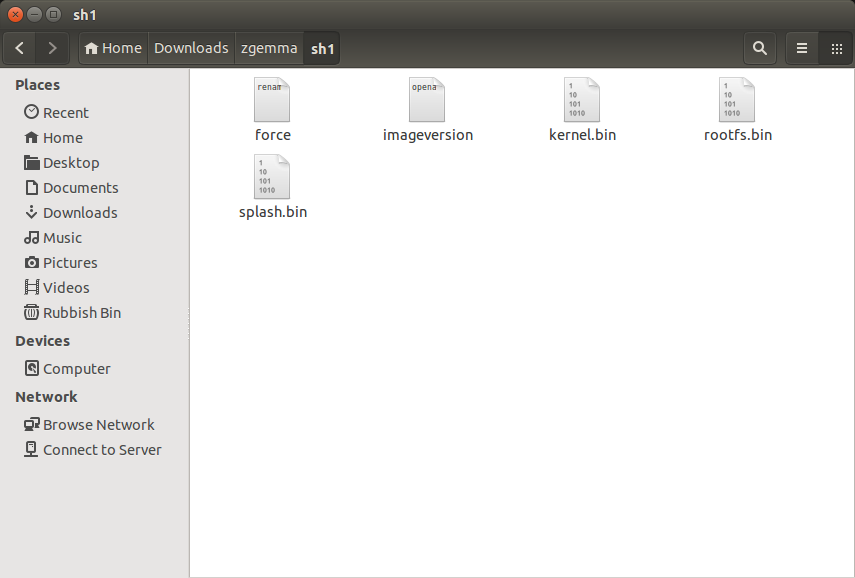

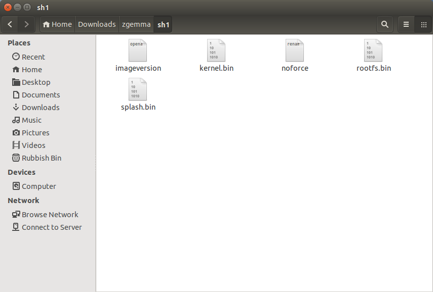

If it looks like thisScreenshot from 2017-10-17 13:20:43.png right click file and rename to force and it should look like thisScreenshot from 2017-10-17 13:24:04.png. When you rename it it will jump from third file in to first file as they appear in alphabetical order ( or at least it does that on a linux pc )
If it looks like thisView attachment 27093 right click file and rename to force and it should look like thisView attachment 27094. When you rename it it will jump from third file in to first file as they appear in alphabetical order ( or at least it does that on a linux pc )
