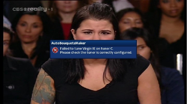

If I scan for channels using ABM, I get this error:-

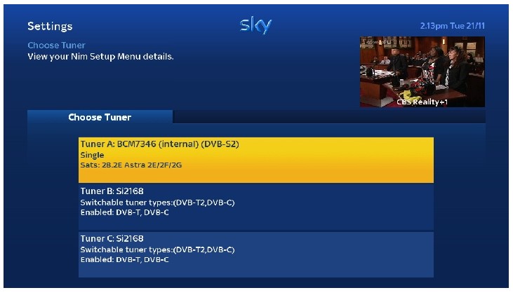

So, I go to Settings/SetUp/Service searching/Tuner config and see all three tuners are active:-

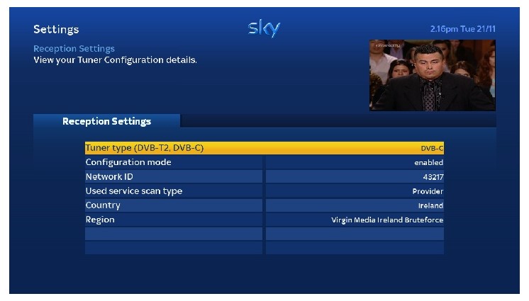

I then go into Tuner B and these are my settings:-

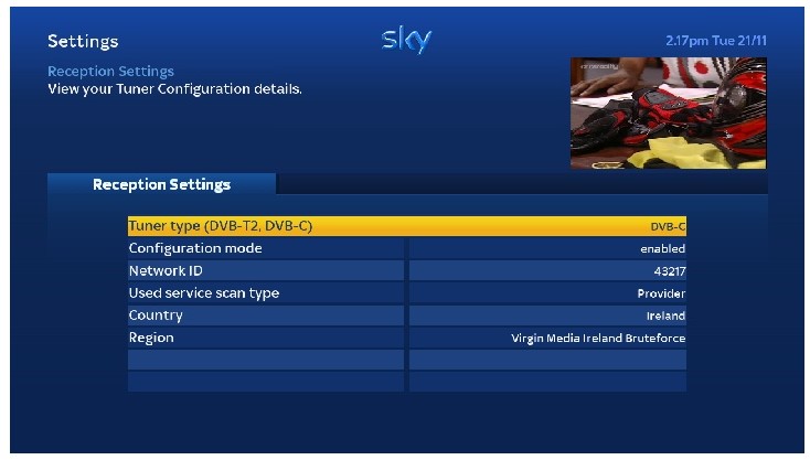

Then Tuner C and the Settings are:-

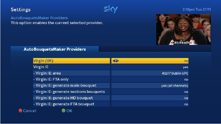

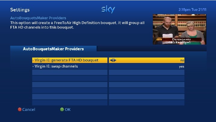

I then exit out and go into Providers, This is what I get:-
As a trial, I disabled tuner C, and the error message changed to "Failed to tune on tuner B".

go to menu, setup, service searching, autoboquet maker, configure
make sure its on Expert
other than that, all looks fine - though I do create separate boquets for the sections

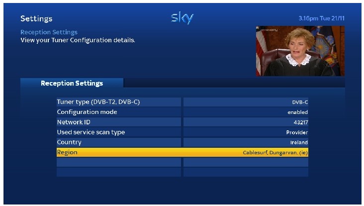

If users are saying previous ABM works can you try this cable xml https://github.com/oe-alliance/Auto.../AutoBouquetsMaker/providers/cable_ie_mk2.xml
It lives in usr/lib/enigma2/python/plugins/systemplugins/AutoBouquetsMaker/providers just copy all the text in that link and paste in cable_ie_mk2.xml and re can ABM
Areas changed modulation values what netid are you using?
Areas changed:
43217
43219
43220
43226
No mate and it's called ABM CustomMix Importer now.
Areas changed:
43217
43219
43220
43226
