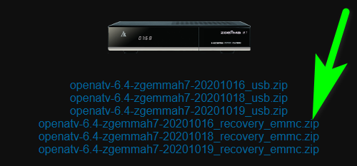

I found your thread and tried that but with the exception of i used open atv. would that have made a difference. I also have no clue what im doing lol
ATV is fine if that's your cup of tea. You must flash the recovery version by USB though and NOT the one that is labelled USB 🤔

You can only flash the recovery file by usb. The usb image needs to be flashed via image manager.
I know it sounds arse about face but that's how it is.
