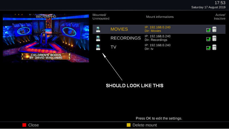

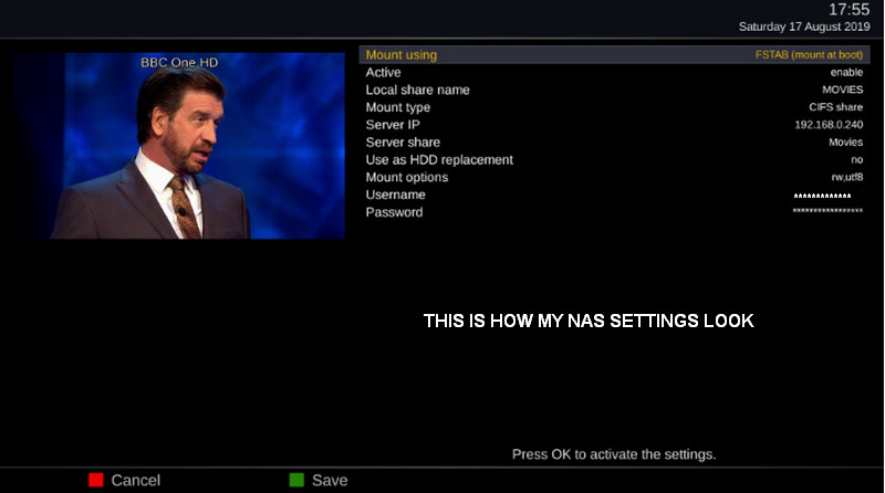

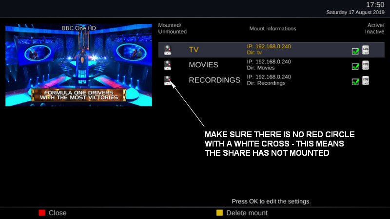

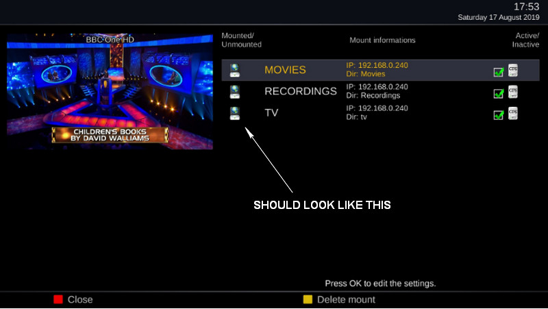

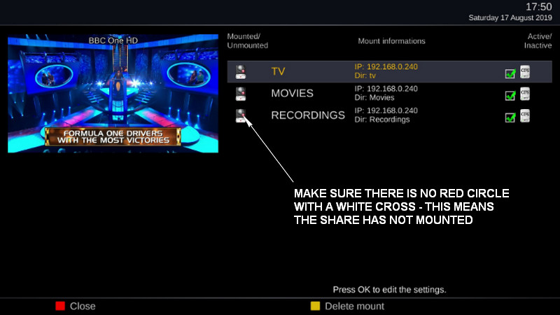

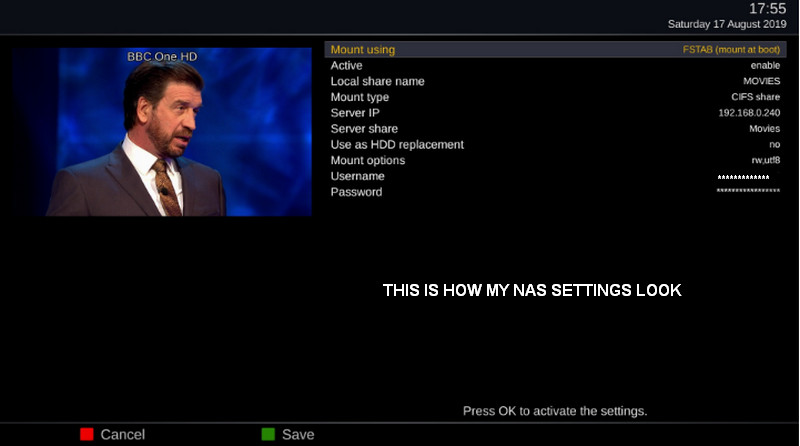

Im no expert but Ive set up my mount using FSTAB with mount type CIFS share and it works a treat. Maybe try changing yours to use FSTAB
