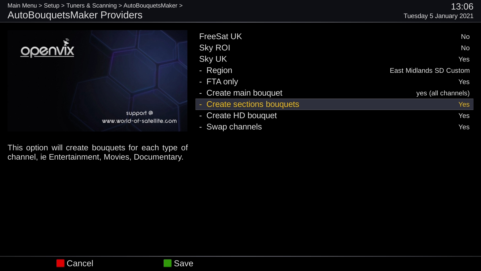

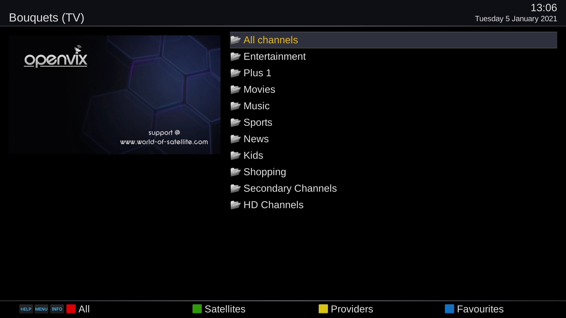

My only issue now is after the AutoBouquetsMaker scan all the sections have disappeared in TV guide, meaning entertainment,documentaries,sports, movies and so on, when I press the tv button on the remote in TV guide all the above are gone and replaced with All Channels, Favourites (TV), Last scanned.
No channels are in these locations apart from Last Scanned which has 11 that were scanned on Sat Finder.
Now to view any channel I need to press TV on the remote then the yellow button for Providers or green button for Satellites, this lets me see all channels and when I actually click into a channel only then can I select EPG on the remote and view everything.
Any idea how to get the different sections back like Entertainment/Movies/Sports and so on.
Willo3092
Have you set ABM providers section to show the bouquet sections?
