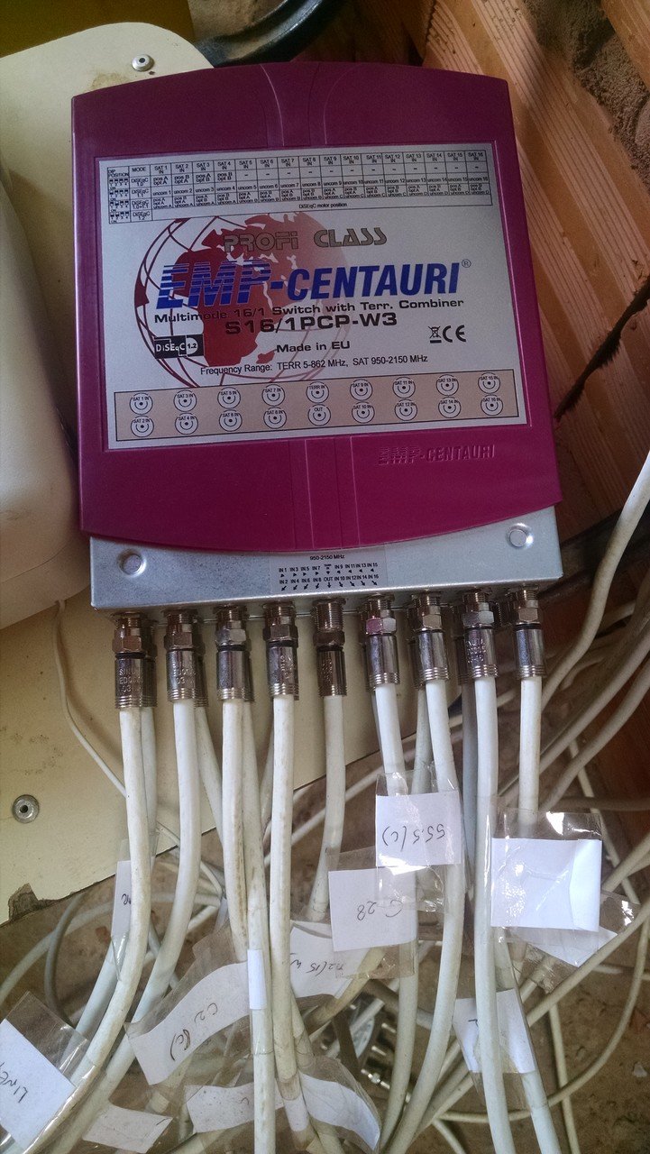

Toroidal dish you need multiswitch .Its lot of wiring and connections involved Also the installation pole needs to be 3 inches all standard poles are 2 inches
