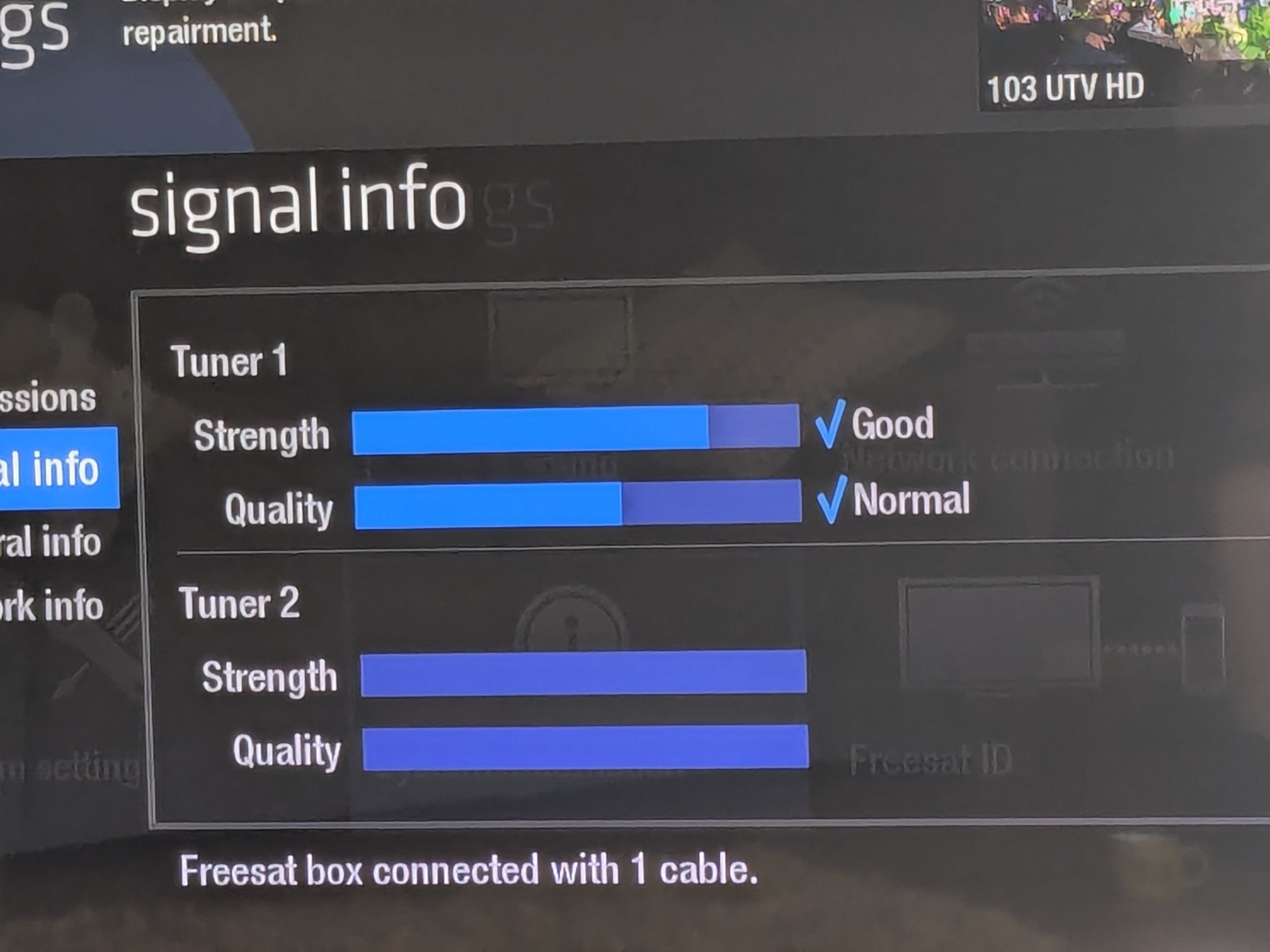

Yeah so on the humax box it gives you signal and quality (I think) in the settings the signal was registering at good (full bar)and the quality bar was two thirds full.

No there are no trees in line of sight, Im at work atm but ill check for sure when I go home for lunch, but I'm almost positive, one other thing that I noticed is that only one tuner is showing up, number 2 tuner isn't showing up (someone said this only shows when the box is recording) and it says connected with one cable
