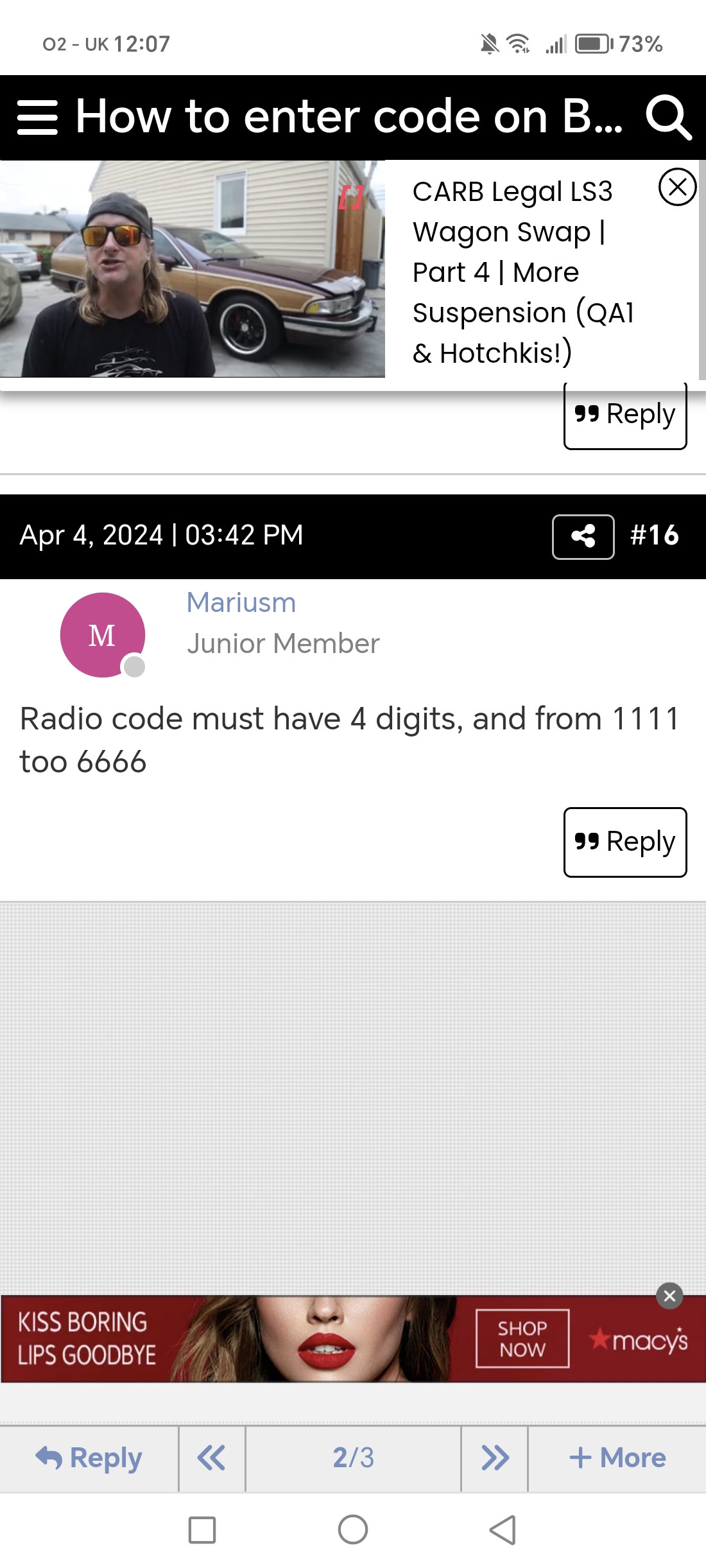

Maybe the codes incorrect. After a Google, it seems people that have had your problem, are getting second codes with numbers from 1 to 6 and obtaining results. Dident find anybody entering zero.... Paul

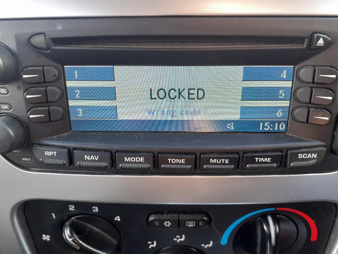

I have tried 3 code suppliers, at cost!, and all have given me 4104 ?
Seemed stumped then as you tube I've watched only shows 1 to 6 digits. I've seen you've posted elsewhere. But other people have also had codes with zero in and had to change. Sorry can't be of more help

Guess I'll have to buy a replacement. Doesn't matter what size engine is involved? I have 3.7 and can get an RB1 from a 2.8 diesel. ??

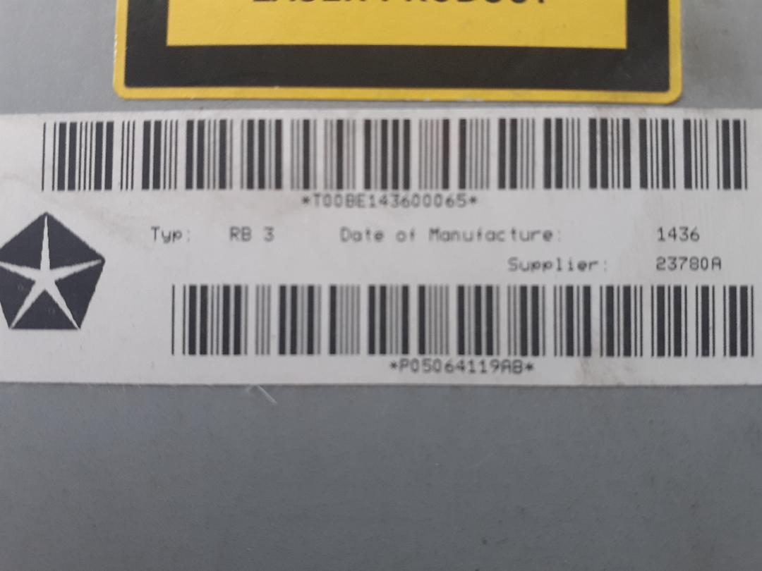

Are you sure you are giving the correct serial number as you have it typed as TOOBE143600065 however looking at the label on the radio it looks more like T00BE143600065
The Chrysler TYPE RB3 radio is a Becker BE6802 using a five digit code in the range 11111-66666
This means that that there should be another label on the casing with a different BE6802 Serial Number.
If you are certain there is no other label on your radio's metal casing then your code cannot be calcuated.
It will have to be taken into a Radio Decoding Service where they will open it up and decode it
