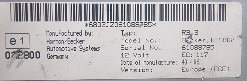

Also there's another label partially ripped off, near the scratched number:
The Chrysler TYPE RB3 radio is a Becker BE6802 using a five digit code in the range 11111-66666
This means that that there should be another label on the casing with a different BE6802 Serial Number.
If you are certain there is no other label on your radio's metal casing then your code cannot be calcuated.
It will have to be taken into a Radio Decoding Service where they will open it up and decode it
You are correct, label on the side - I missed it. Serial number 61085595. Also number 022800
When I entered numbers when I had entered 4 the screen immediately said 'wrong number', I didn't get to try 5 entries?
This is a example of the BE6802 label required
Sorry...I cannot read anything on your last photo....too blurred
