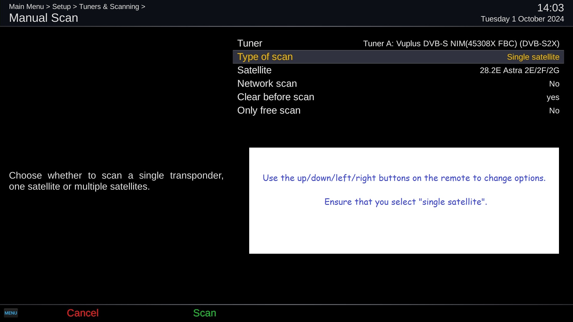

Please perform a single satellite scan and report back with how many channels you find. This will give a better picture of what you can receive. Do not use ABM. Please post a screenshot of the scanning options you have used if you want us to double check. Reason being, from past experience, people scan only one transponder instead of the whole satellite. If you have more than one tuner, scan on all tuners. I am sure you have an alignment issue, faulty LNB, PSU or other hardware issue.

Please post the results of your scan results.

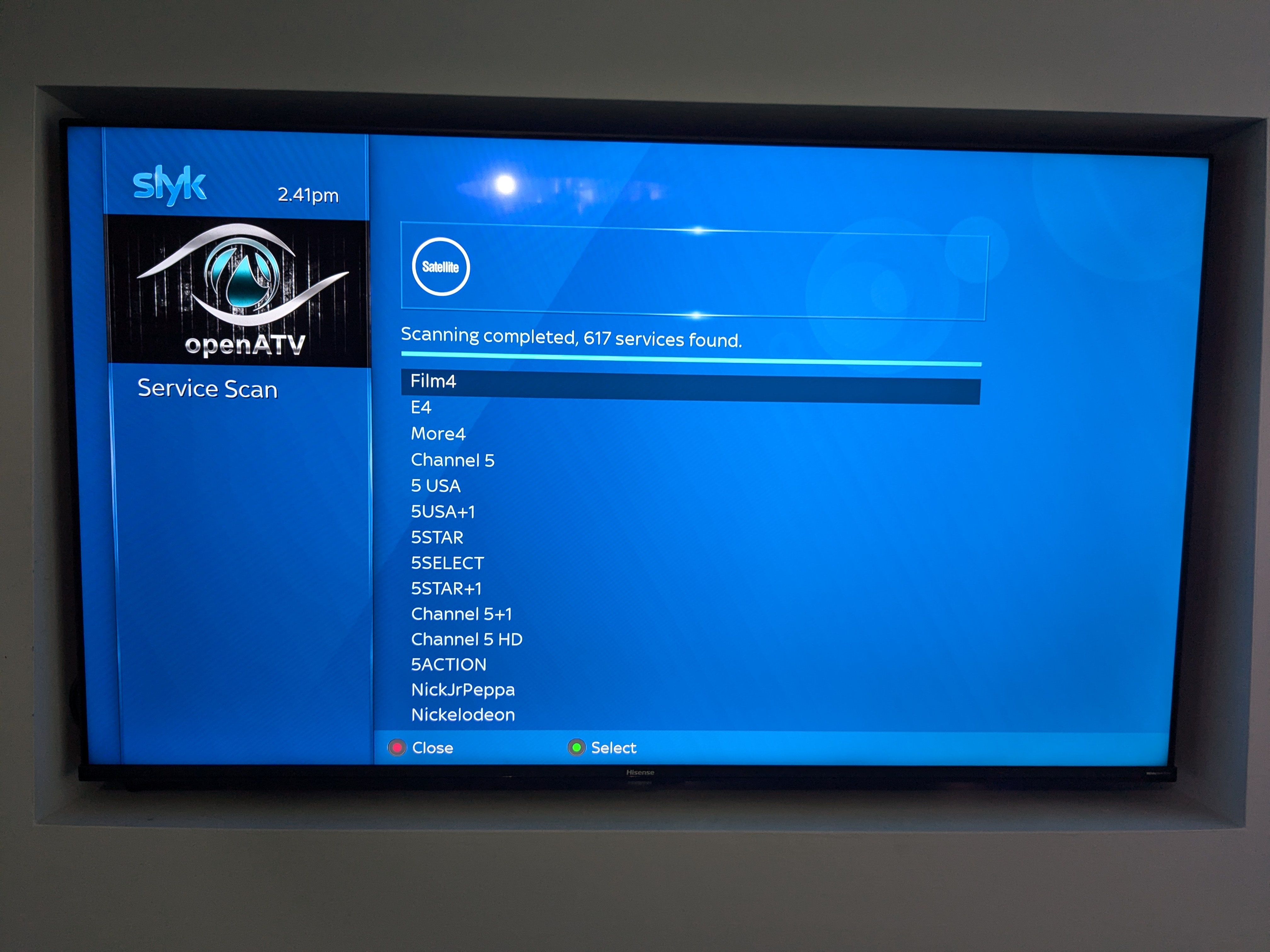

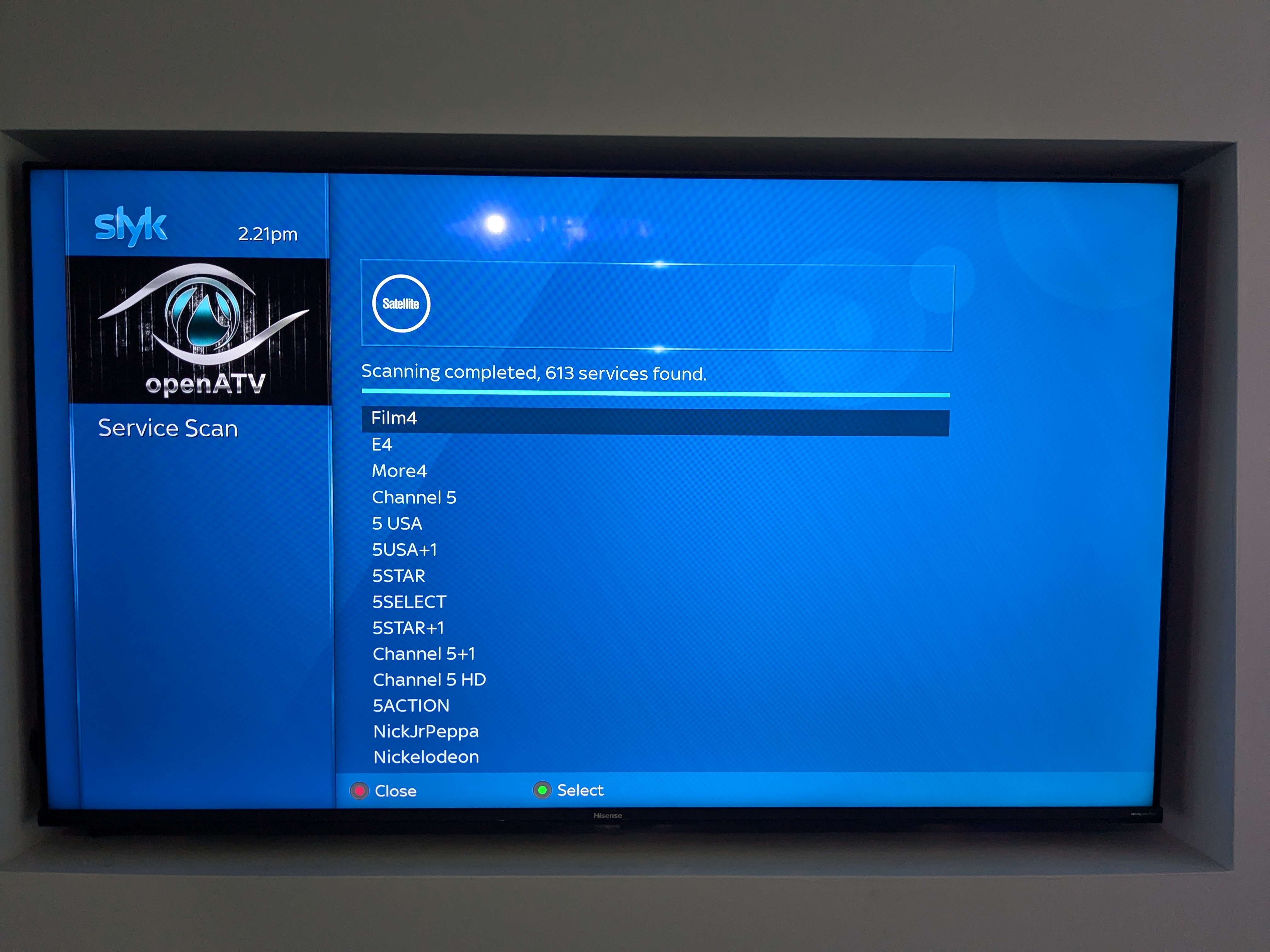

Done this earlier but only just getting a chance to reply now, apologies. Scanned both tuner A and B. B found slightly more channels.

You are missing over 120 channels (assuming your satellites.xml file is up-to-date. ABM reads SI tables, and does not use that XML file). To me, there is a minor alignment or other hardware issue. Could even be the PSU.
The tuners have differences in sensitivity so may account for why one receiver finds them and the other doesn't. Using the Zgemma, please post a screenshot of signal finder with one of the troublesome transponders selected.

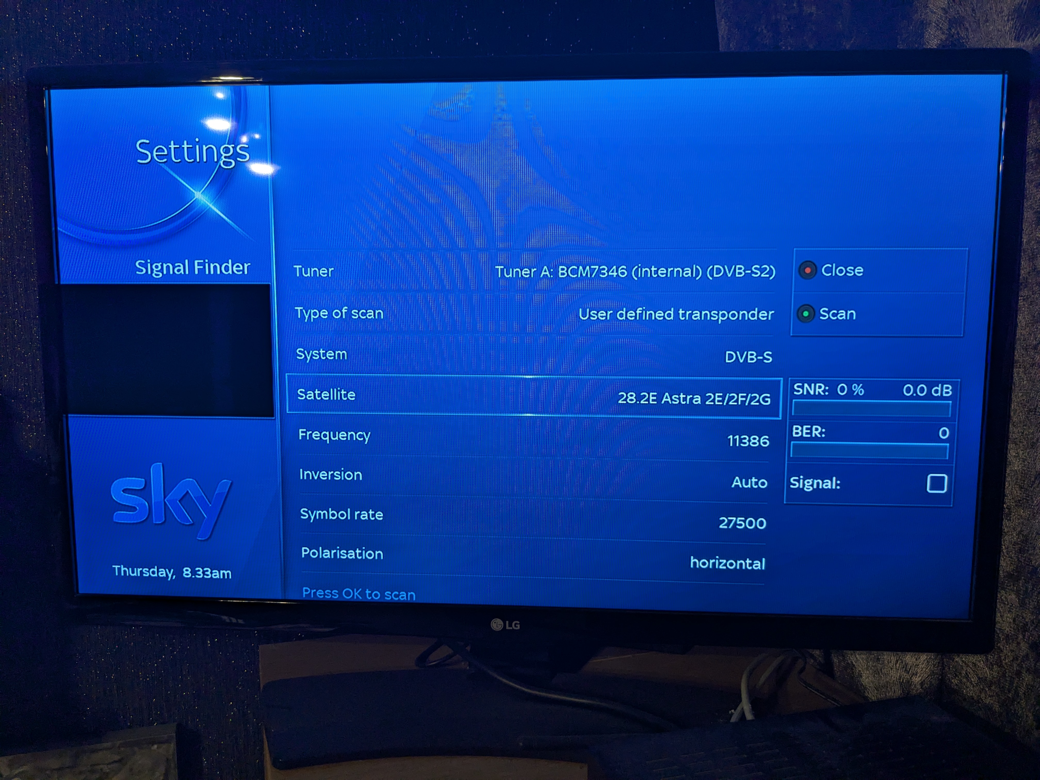

Looks like you could be right, see screenshot from old H2S.

You should change dvb-s to DVB-S2 as that is the new standard. use kingofsat to find the correct paramets. A lot of channels are moving from the DVB-S to S2. Hence old sky digoboxes that were dvb-s only are obsolete. a lot of channels have changed. Change 11386 to dvb-s2 and pause, you just put cursor on system and press right arrow.
To get all FTA channels i use SKY UK and ignore Freesat.
Using user defined parameters is prone to errors, the inversion in that picture is wrong too. You are better off using predefined transponder. If it is not listed, it's because the XML file does not have it.
