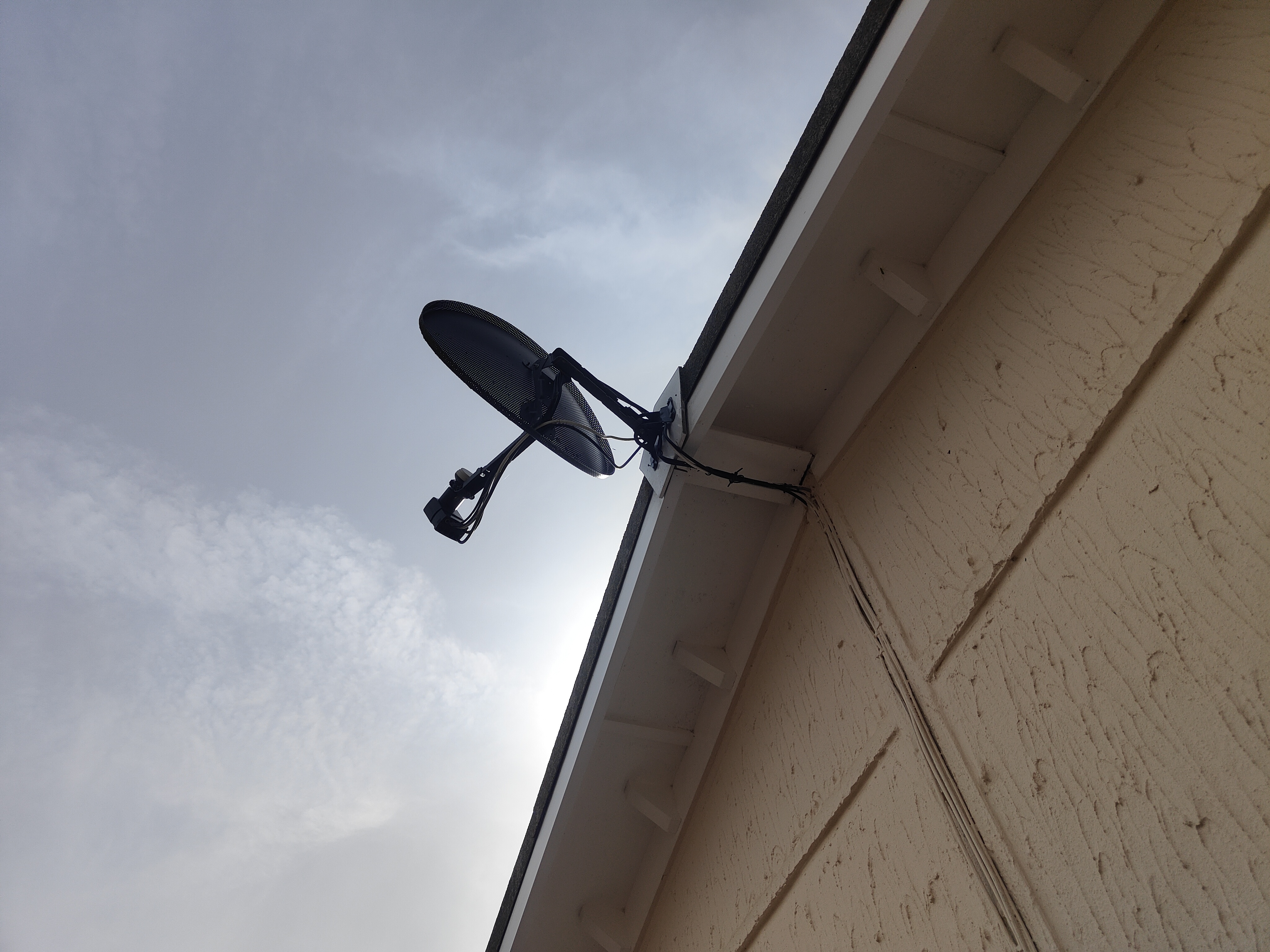

A bit of an aside, but if you have a Sky Q twin cable setup, you can actually use any box you like paired with the right switch. I got the "JOHANSSON 9725 SFU dCSS Switch" which takes the wideband signal from the 2 cables and provides 2 unicable outputs.
I wanted to get my feet wet with sat receivers, but I didn't want to have to change anything on the satellite end (and I wanted to keep my Sky Q box working by putting it in single cable SCR mode) so I got an Octogon SF8008.
Both the Octagon box and Sky Q box work together fine, had I known the SF8008 wasn't FBC I would have gotten another box. Later on I'll probably get a splitter so the SF8008 can at least have 2 tuners.
