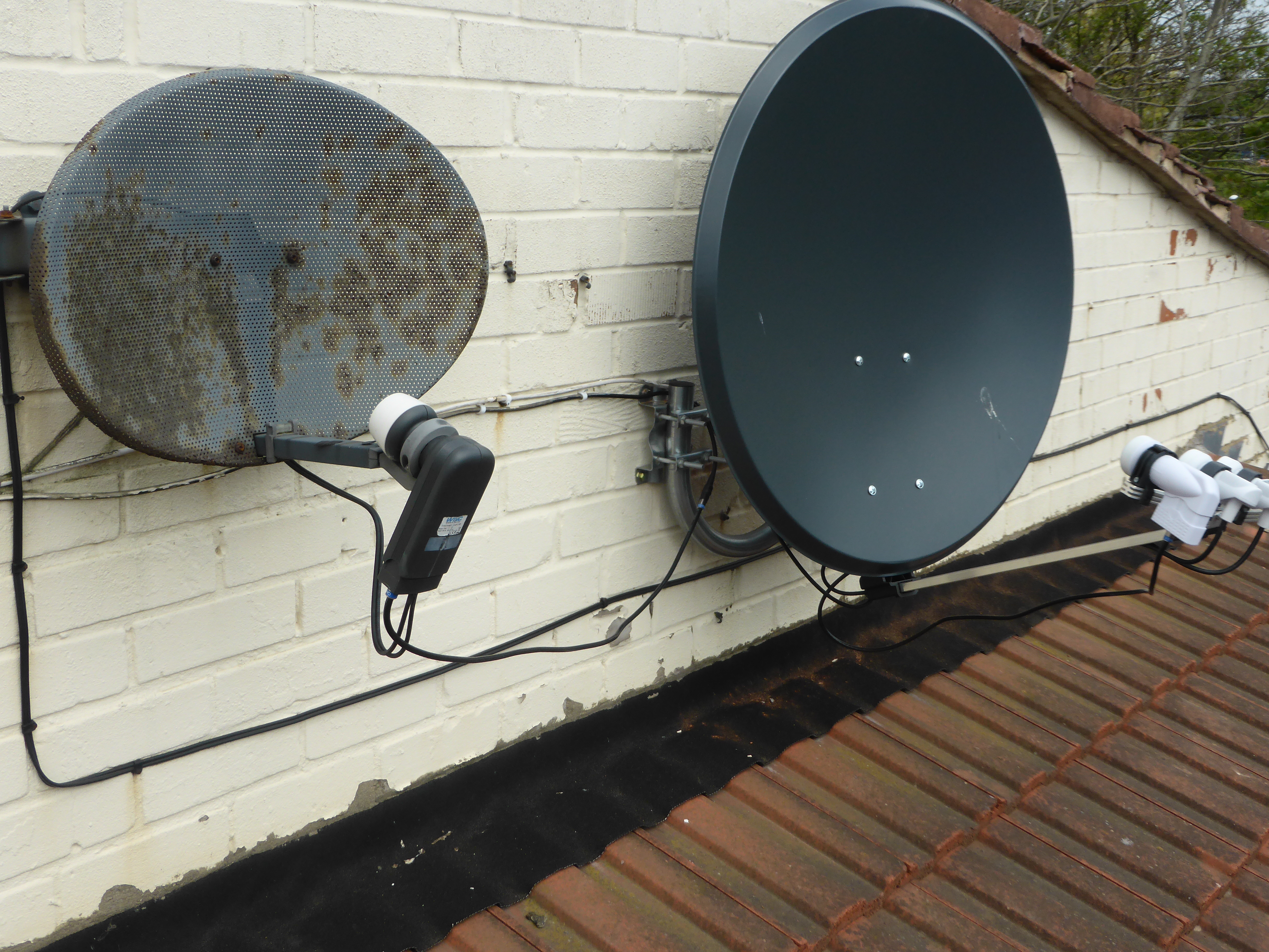

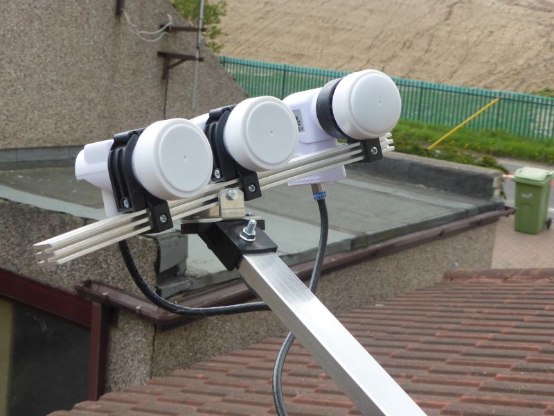

Heres my old one before i moved. Thats 28, 19 and hotbird at 13... later on I changed the hotbird one for a dual 6deg thing that added 16 as well.
Middle on is pointed at 19
Standard sky dish for the multirrom at the back beside a 80cm dish.. Location, Sunderland North East England
i had that lnb holder, but wouldnt fit the arm on my 80cm mesh dish so ended up getting the thinner inverto multi lnb holder.
Middle on is pointed at 19View attachment 56748
The prime focus l.n.b for 19east
I WOULD have installed it on the other side of the bracket then you have the opition to fit l.n.b for 23.5 east
I dint find much in English on 23.5 thats why i went for 13 and 16.. they were the days when a simple euro cline sorted it all out and my box was able to find original English feeds on most of the English/US programs
