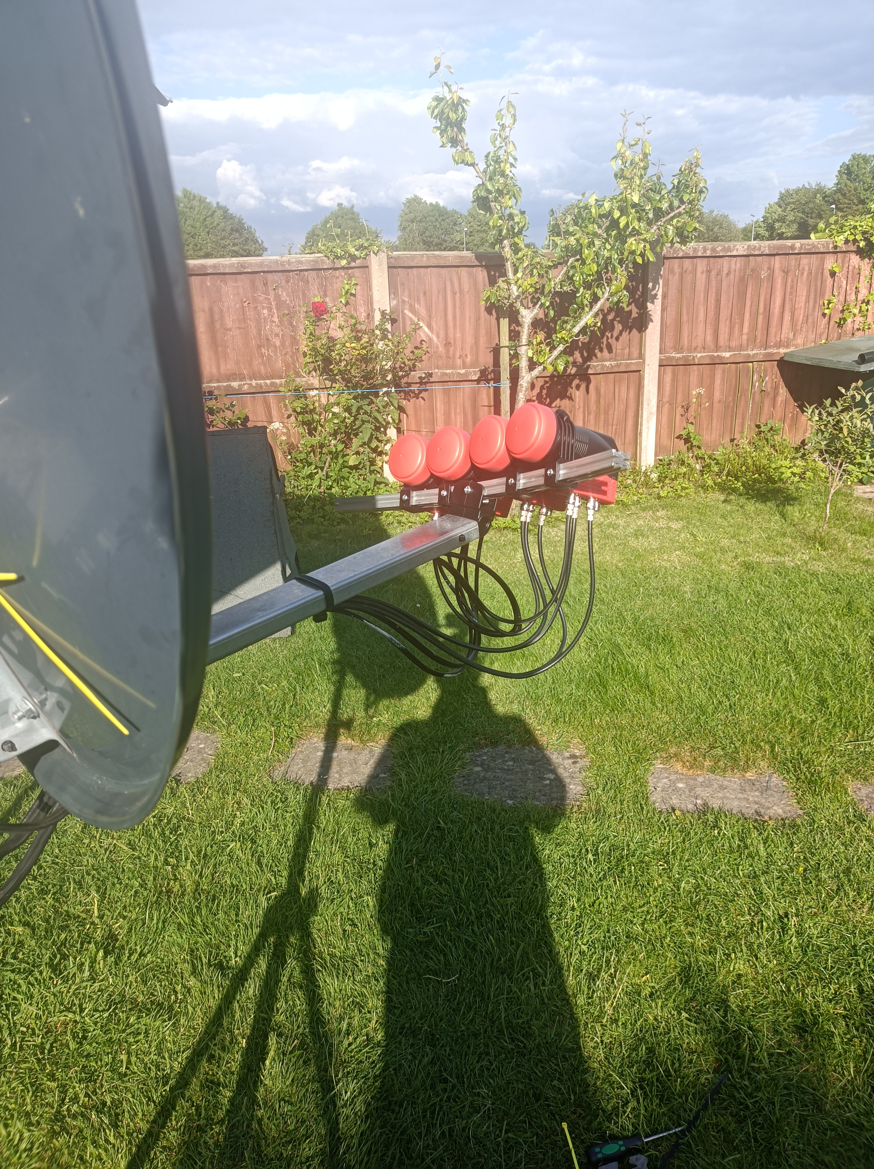

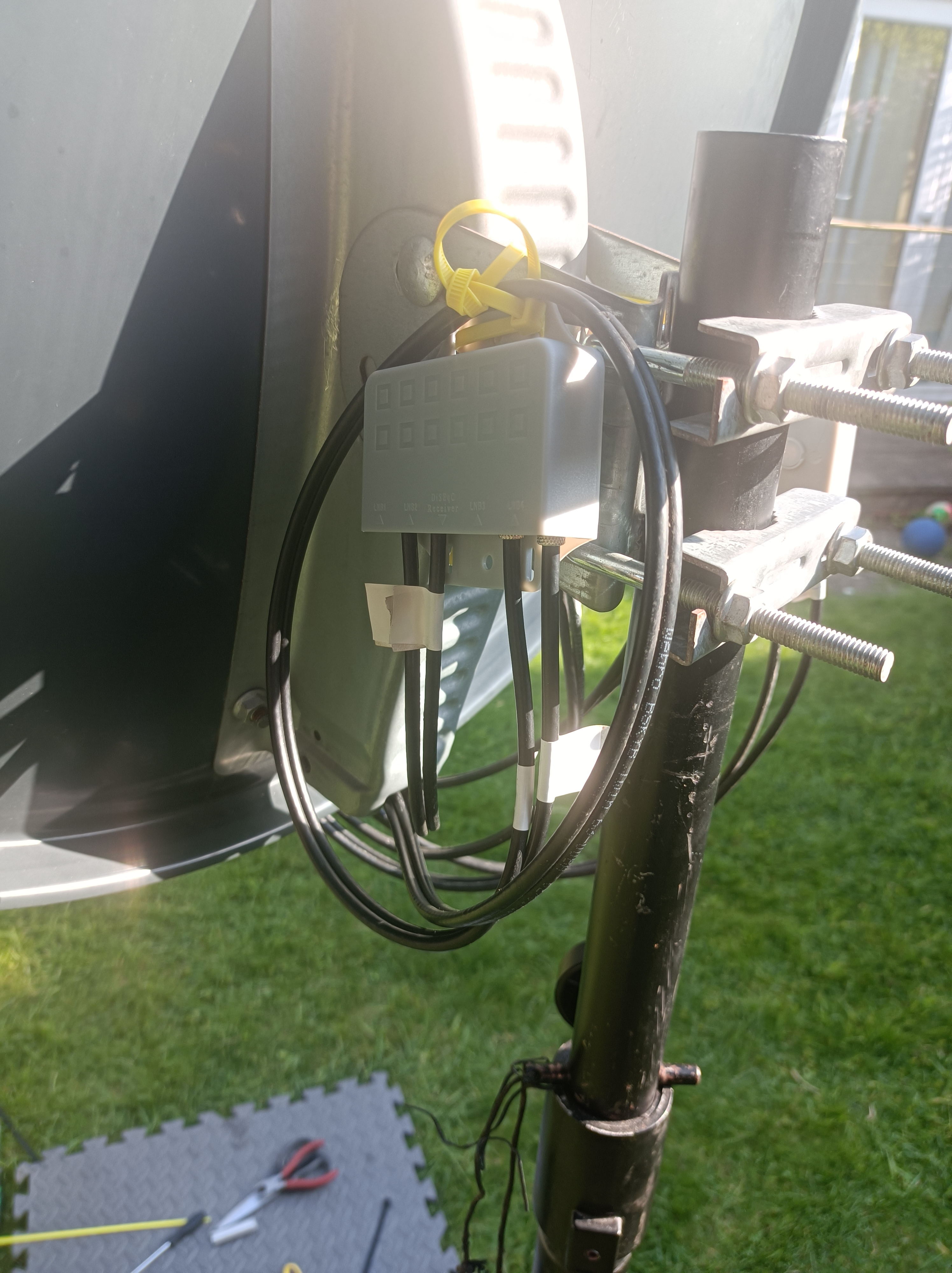

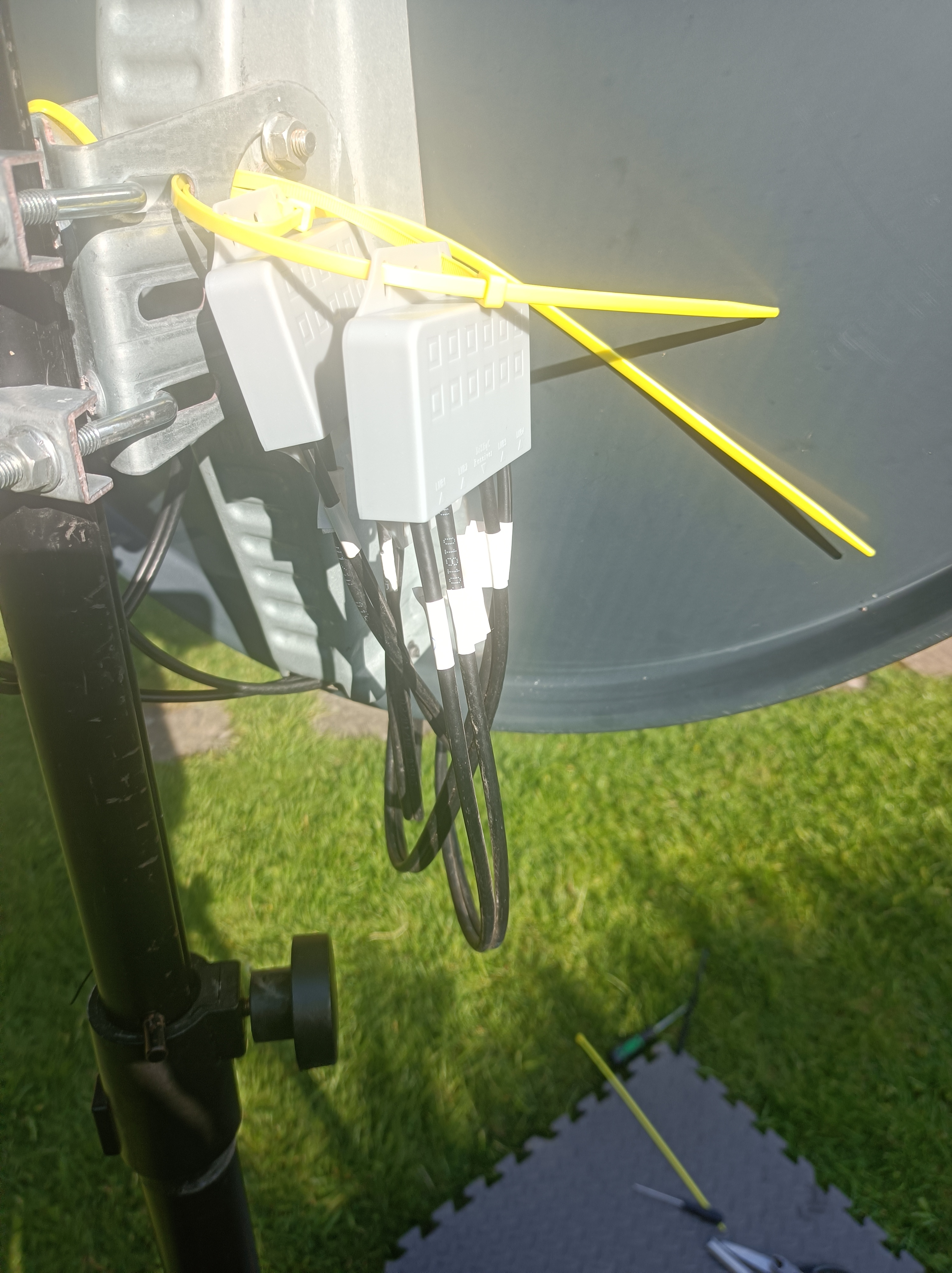

it was set up on a tripod. it was then fitted onto a bracket on the house after. easier to work at ground level than from a ladder. just attached to the house after then lined it up
ive already got a motorised setup.
this was set up as an easy to use option with the option to record simultaneously off different birds which motorised cannot do

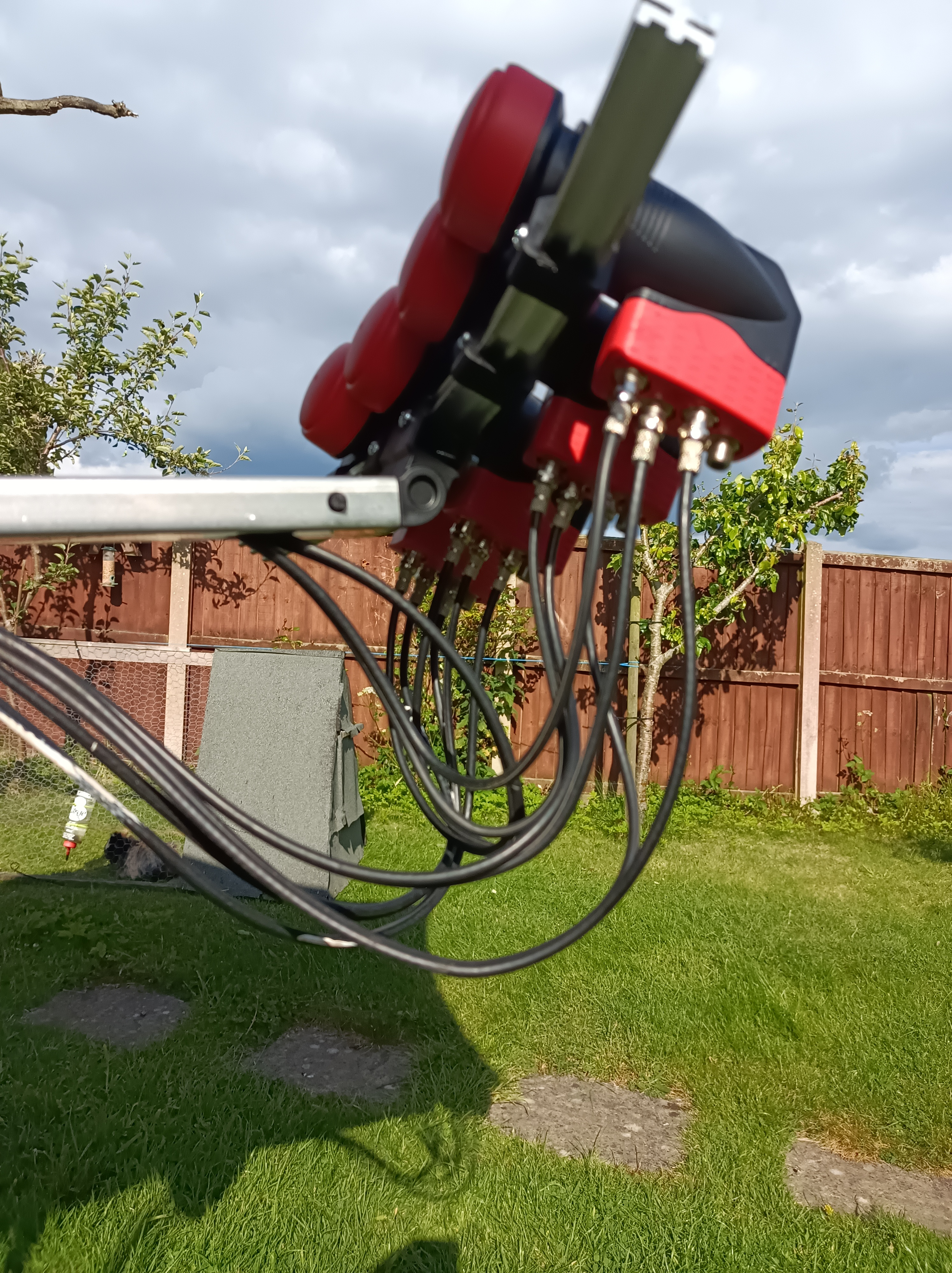

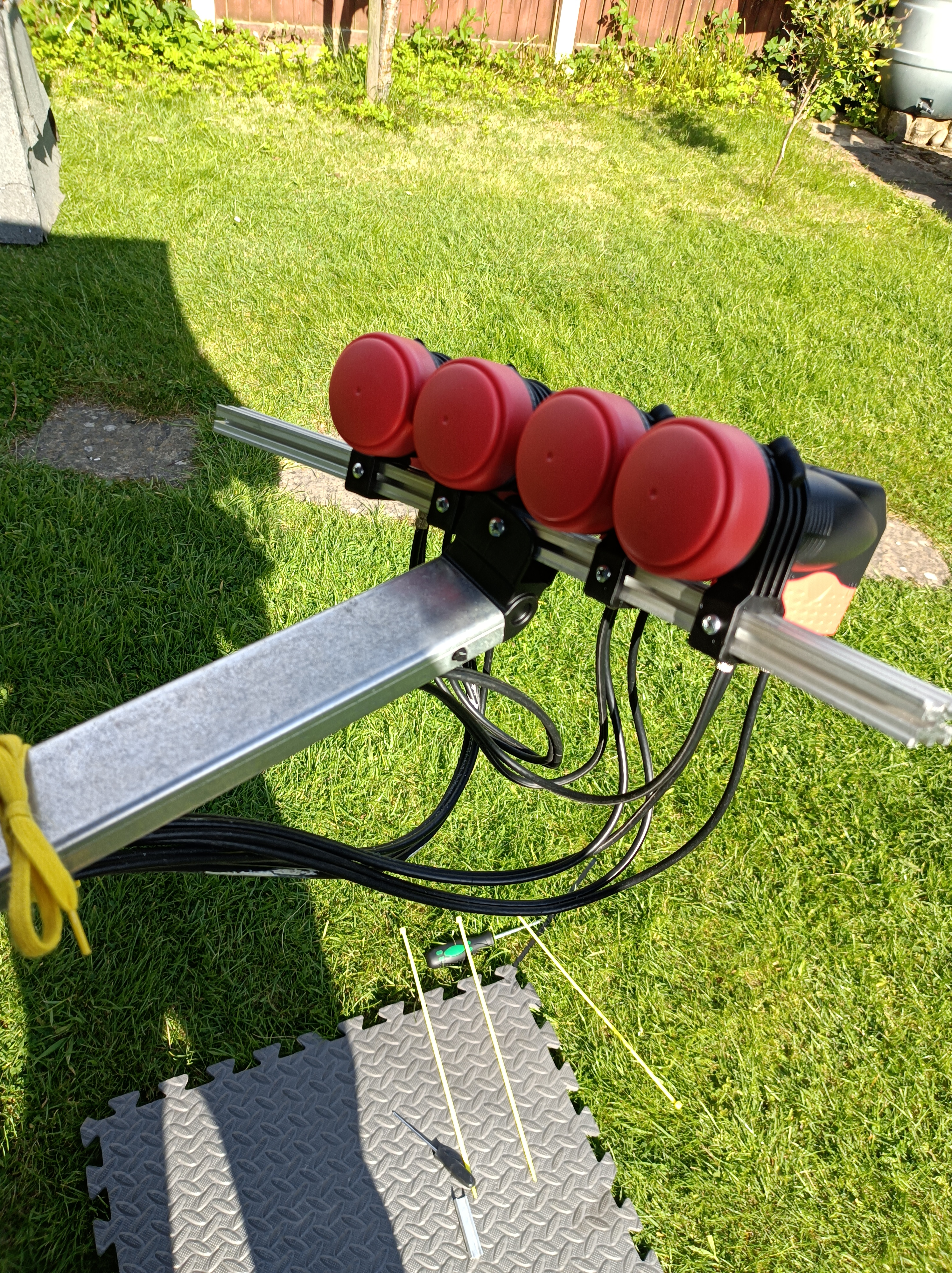

I usually modify the centre screw off the bracket
So you can push the l.n.b on 23.5 up tight to the 19.2 l.n.b for better s.n.r
I usually have 19.2 as the prime focus L.n.b
Then set the rest of the l.n.bs Staring with 13 east the weaker transponder
