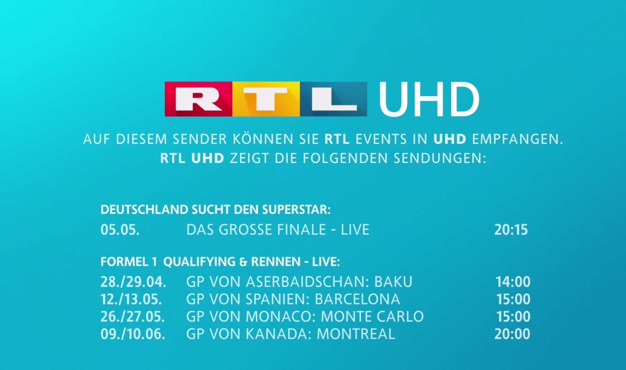

I am sure its the final, I think its the german version of pop idol.
It has also been showing the F1, HD+ done a deal with RTL and got it added to there package
cheers
cheers
Yea it’s the final
Yea it has all the f1 coming up
Been watching around 30mins or so the other half is translating for me lol
