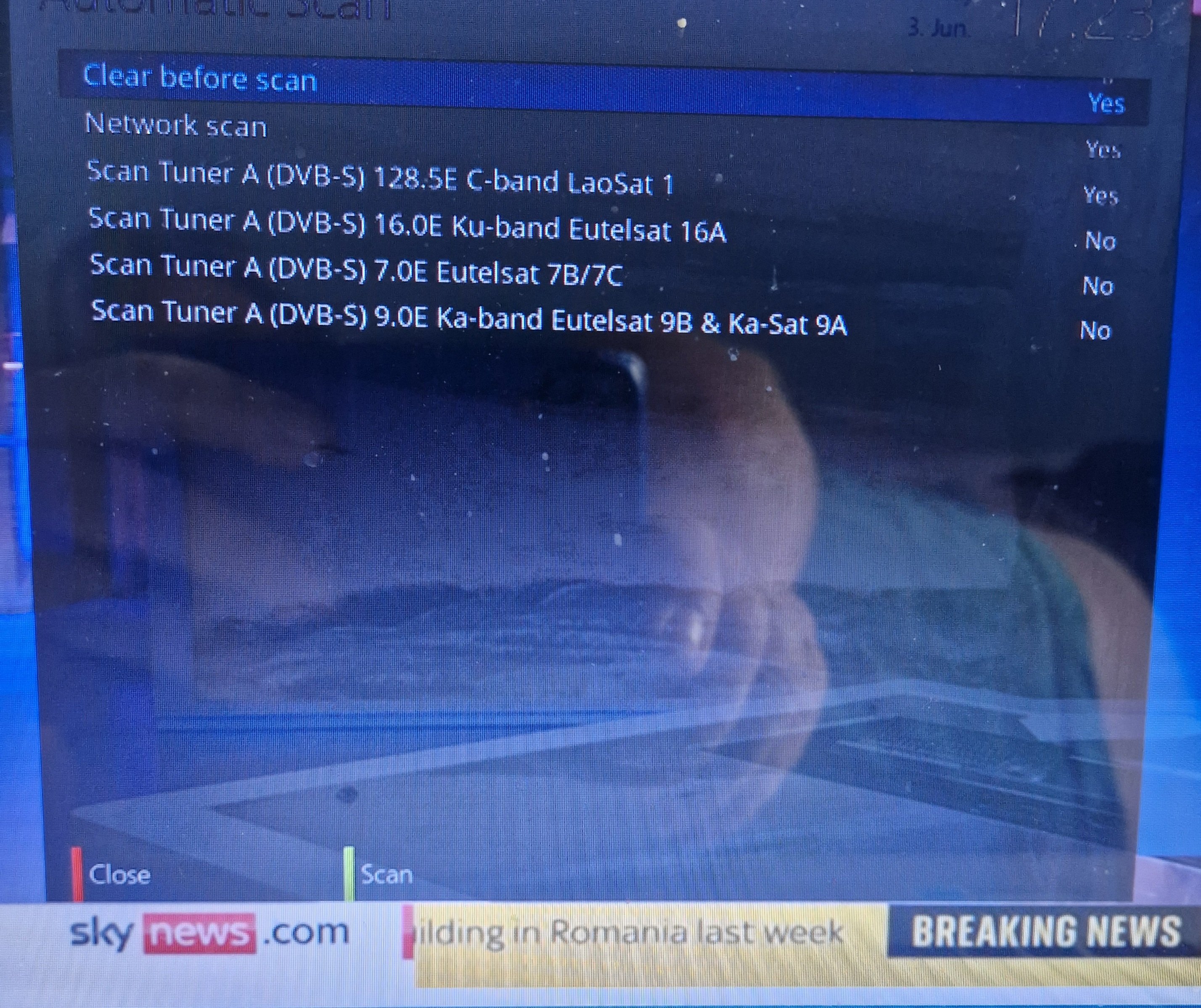

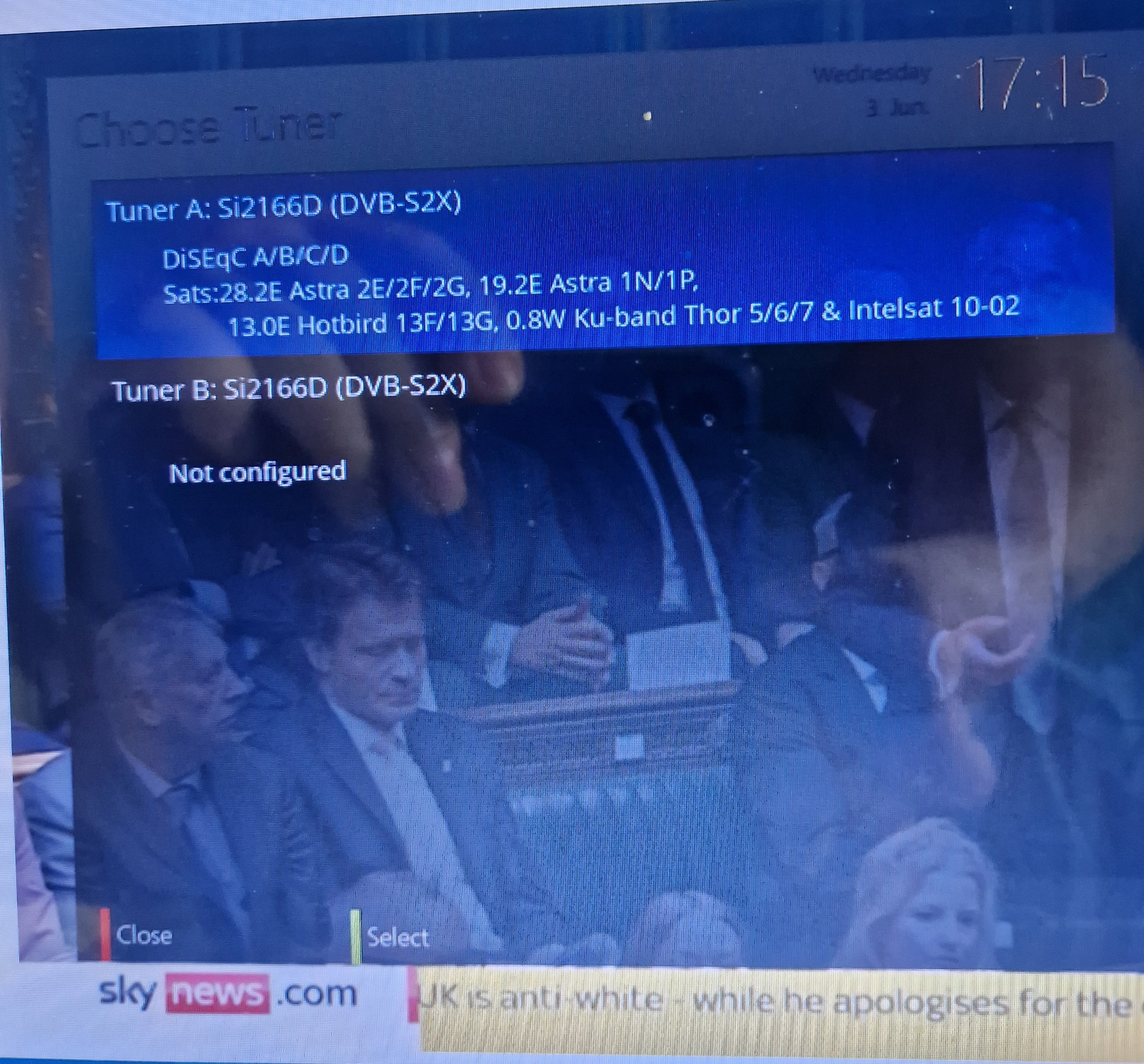

Hi all, got a strange problem on my 3 Octagon SF8008 v2 Boxes using ATV 7.6 with My Metrix Lite Skin
The A Tuner Configuration was all Set up for 28e,19e,13e and 0.8w...ok so far good.
B remained "not configured" don´t use it.
After the initial set up the A Tuner Scanned the correct Sats but after ReBoot then showed 128.5e,16e,7e, and 9e.!!!!
now i cannot Scan or check the 4 Sats for which i have a Dish because the A Tuner has mysteriously lost its original settings.
Anyone any ideas?
Thanks
AJP007
Do you have a plugin to update channels or satellites.xml? If you can't select 28.2, it has been deleted from the XML file.
System version is in /etc/tuxbox/ user version which has higher priority is in /etc/Enigma2/
