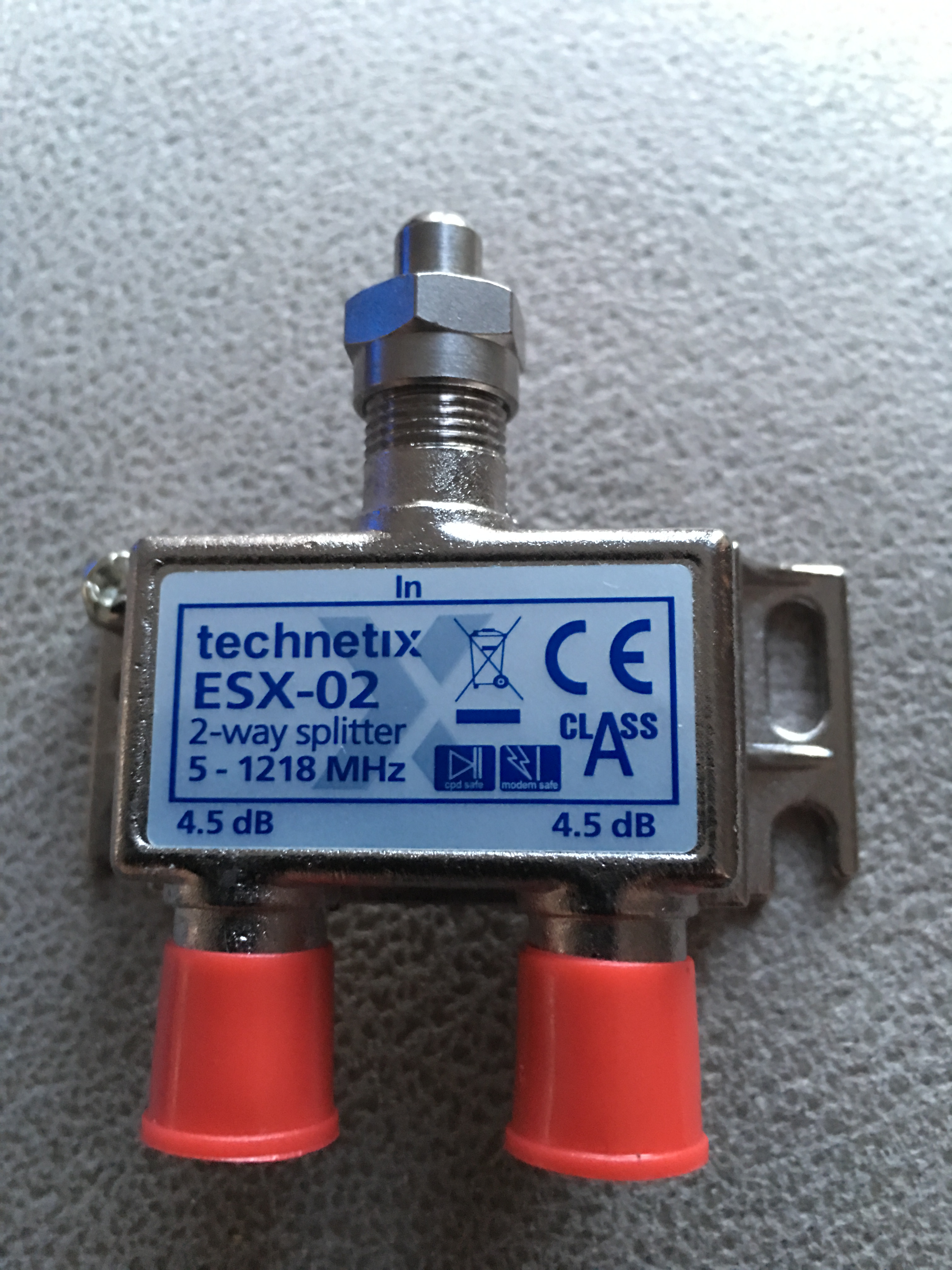

What splitter is in use?
ECO Line ESI 03N Splitter, It has been in since i moved in 9 years ago, virgin installed when got it set up originaly.
Could it be an issue with the incomer box/splitter? There is a white virgin box on the wall with a coupler inside it.
Possibly the older version used 5-1000mhz.Post up a photo of box and coupler.
