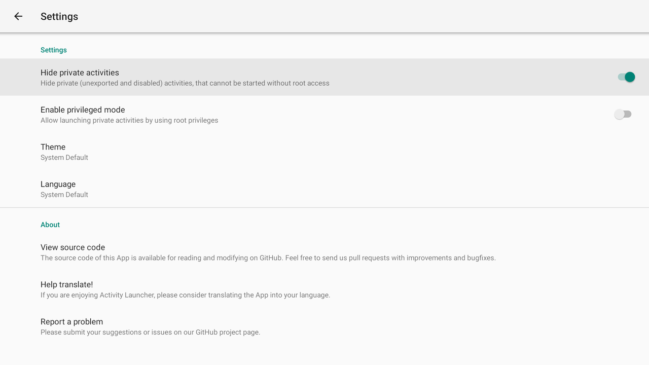

Looking for the settings icon
And you make the necessary change
Settings
Hide private activities

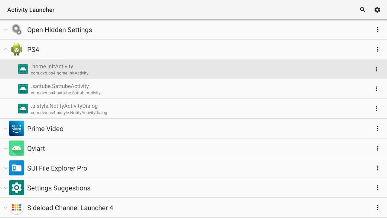

Then search for the name of the launcher
PS4
And you click (ok) on a word
home.InitActivity
I have had a play with this morning, although it looks good i don't really find it of any use. I cannot find a way for the launcher to accept the known channel list from Fenke. I have tried it everyway i can think of. I have put my usals settings into the launcher but when you go into motor to select a satellite there is nothing in there. I don't seem to be able to get into any form of scans at all. Also when messing around the language often reverts back to spanish.
If anyone plays with this and wants to swap back to the qviart launcher. Go into the app launcher and select activity launcher and select qviart as in the picture above and then reboot the device via the standby button on the remote.

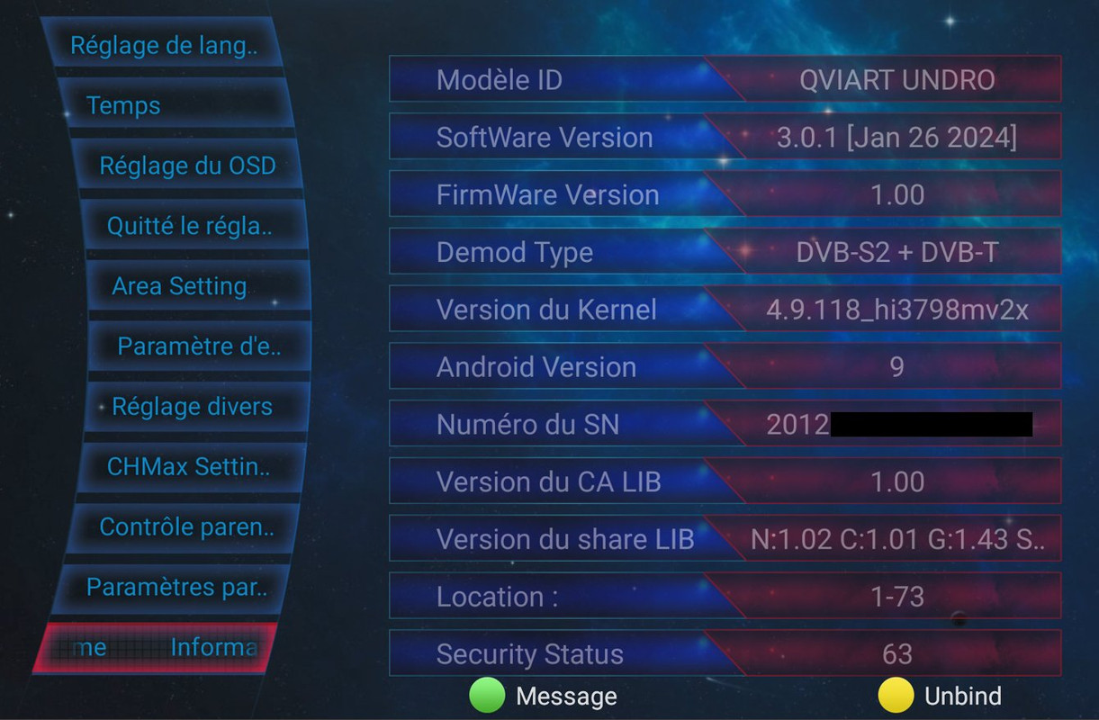

One benefit of this launcher is that is gives you the full serial number of the qviart including the second part which is often used to renew the server.

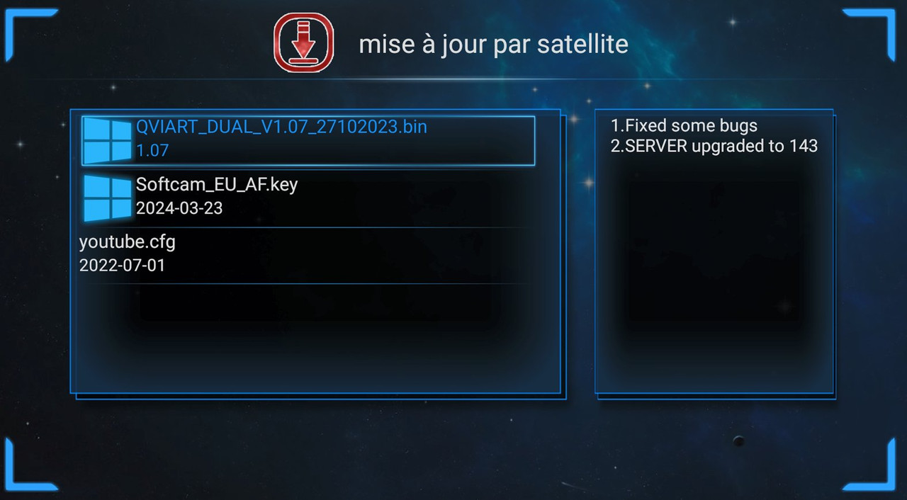

If that does not work then it will probably be reflash the software five and then reflash software 1.07. To load the software 5. I would put a zipped version and an uzipped version on a usb stick. Power off the box and then turn the box on and keep your finger on the power button until you see reco on the lcd screen, push the button again until you see update not e2 update. Leave the box on that and it should reflash the android side with the special software.

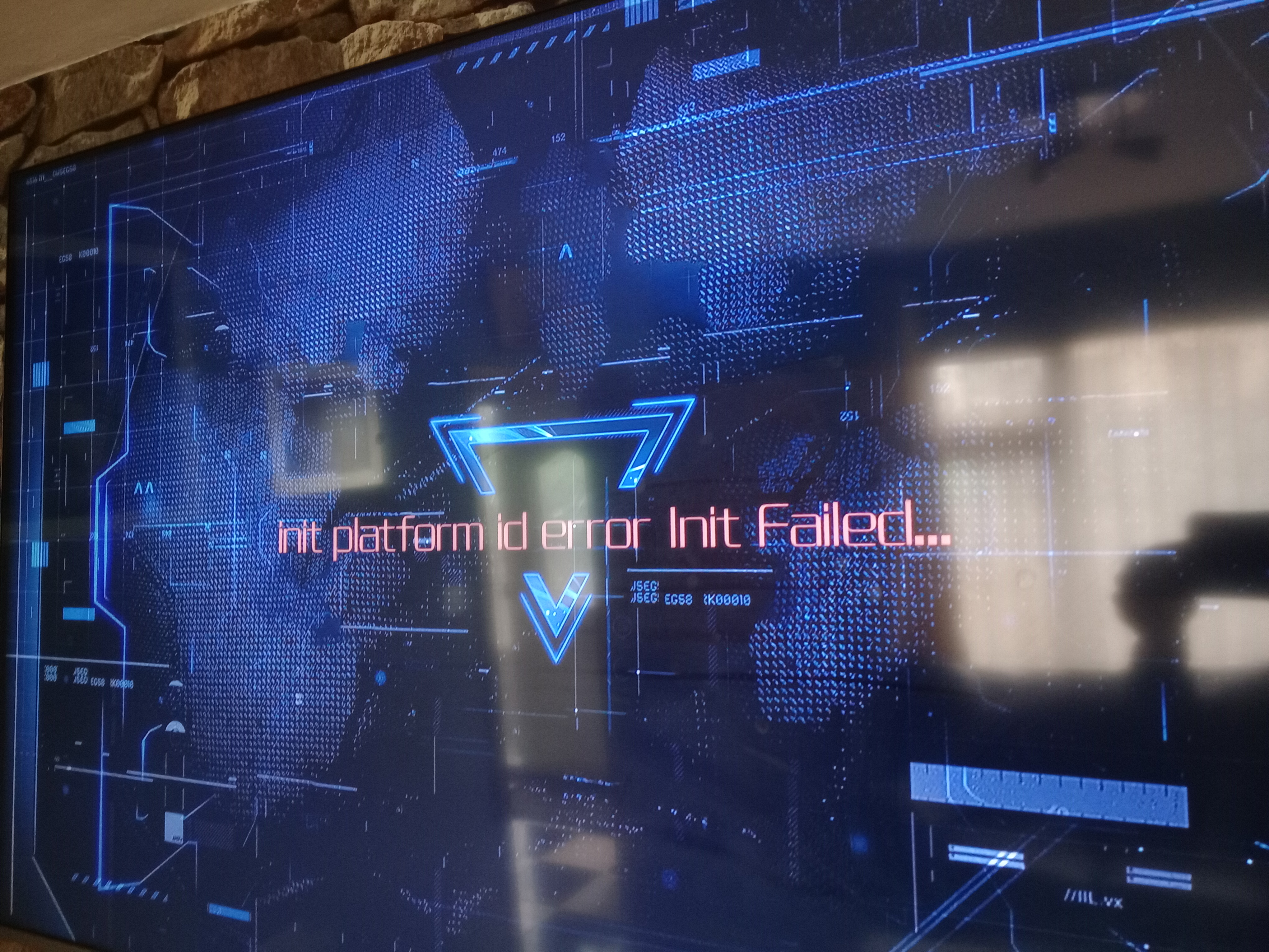

Yeah got back into E2
Downloading the recovery 5.00 image
But will try booting back into android side now and see if it boots..
Thanks
No luck getting the same error 😞
