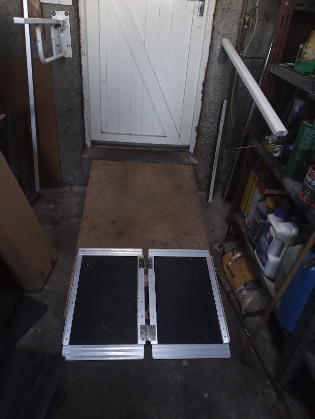

20 odd years ago i made a ramp of 3/4" chipboard about 30" wide and about 3 foot long and now is too steep to easily get up the ramp and into kitchen.
Used in getting a wheelchair up and down , sack truck with massive gas bottle back then .
With mobility getting worse i was very nervous going down with rollator as too steep.
Ramp i made up had lump of wood with 2 screws going down onto dexion screwed to step and was removable but now need a longer one to lessen the angle.
Will also have to get supports to aid getting up the ramp on either side and have got a wall mounted support i can use on one side and dexion bracket from shelving unit to wall and old grab rail that was removed from the stairs
I will also be moving a large wheelie bin with compost DOWN THE WIDE RAMP . 2 ramps not an option as walking on the centre of them

Got lucky as local had a ramp second hand for 50 euro as how can raise the wooden ramp up maybe 6" and then attach this with another extended angle.
2 holes in top of ramp can be secured to wood platform.

I got AGE ACTION out to add a few more bits like a drop down handrail used in a bathroom on a flat wall but my wall is large pebbledash and makes it more ackward to fit..
Second hand rail i had was removed from stairs and cut in house to be thrown out but held onto it.
One thing i have plenty of is dexion and was able to bolt it to an upright shelving unit and got him to screw into wall. added a few screws to hold hand rail on top.
I had leftover plywood i got him to fix under the chipbord to give it some more strength and a 4" x 3" to raise it up off the ground and less steep for rollator going up and down. Having bought short Aluminium ramps i just asked him to drop long screws into those hold to hold it in place and removed quickly if needed.
