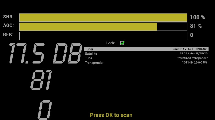

I can't seem to find the 'Sat Finder' option but in 'Tuner Configuration' both tuners are labelled as 'Enabled'
below tuner config
Yes, my tuners seem fully working, both SNR & AGC are 99% for both Tuner A & B.
