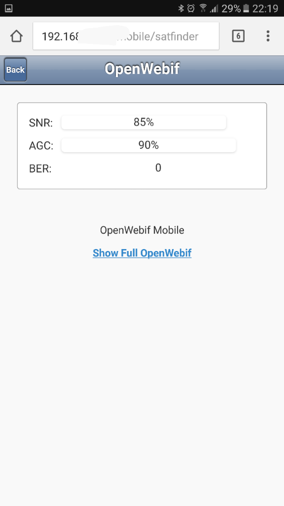

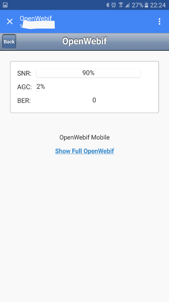

On a channel that Pixelates this is what webif shows. On clearer channels, the result is much higher.

Your signal strength isn't that good, or quality of signal I would say.
Here is meaning of those letters
SNR = Signal to Noise Ratio - which means signal quality
AGC = Automatic Gain Control - which means signal strength
BER = Bit Error Rate - which shows the error rate of the signal.
