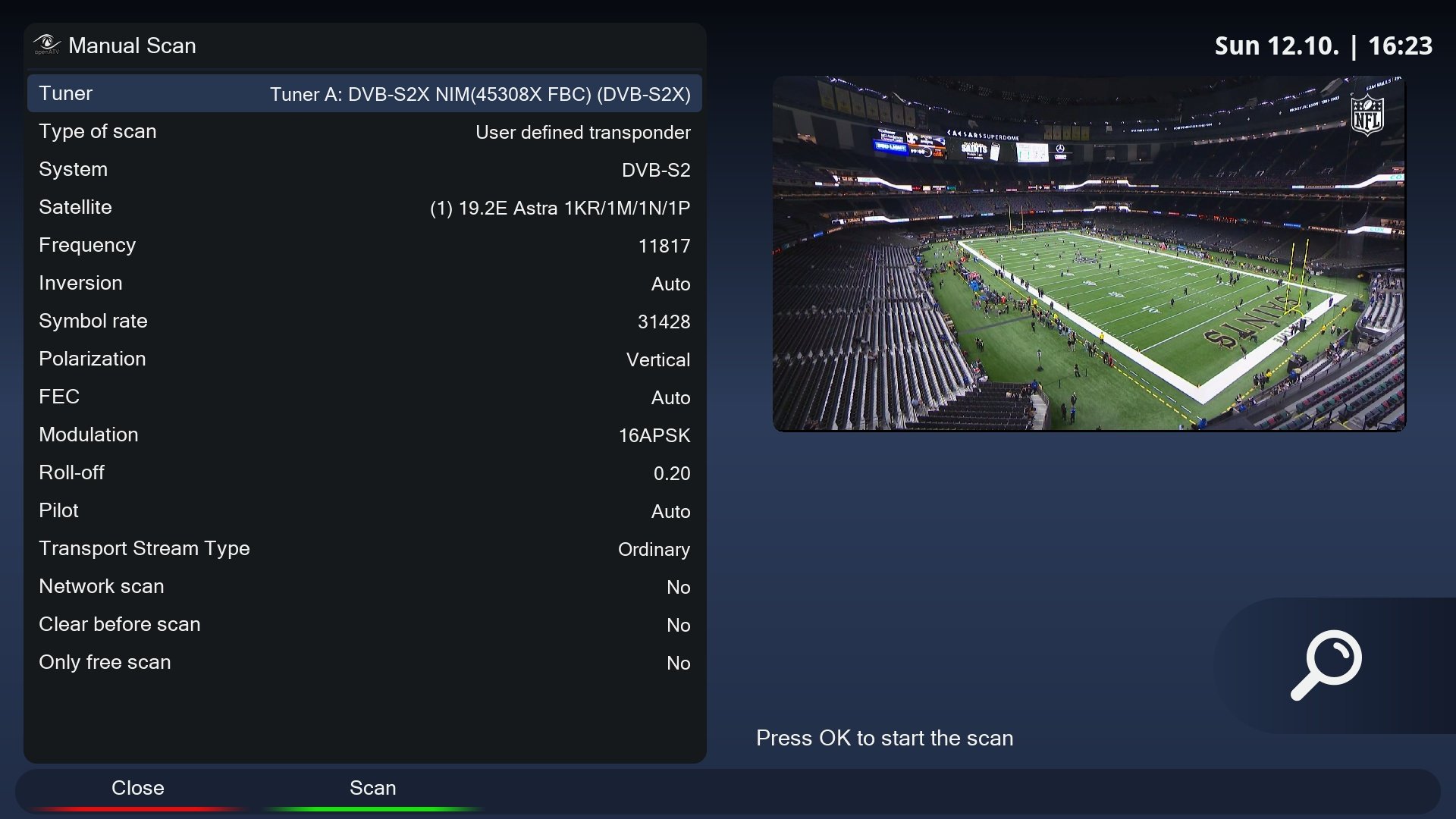

I have a DVB-S2X box (Vu+ Uno 4K SE) which has the Astra Service1-5 showing in my channel list when I ran a scan on 19.2E last Monday.
All 5 channels are showing 0% signal this afternoon.
Any ideas why?
Have tried sending dish to 0.8w, but no change in signal
Since they are feeds they probably don’t transmit all the time they are currently transmitting though so you should get a signal if you test them now.
The feeds transmit with 16APSK modulation so dish size may be your issue as they require a higher dB level to lock the signal.
I have a 80cm dish in the SE, and the viark has no problems with picking up the signal and auto updating the BISS key.
Just a bit baffled as to why the same dish setup ends with a different result on the E2 box
nfl feed live.
