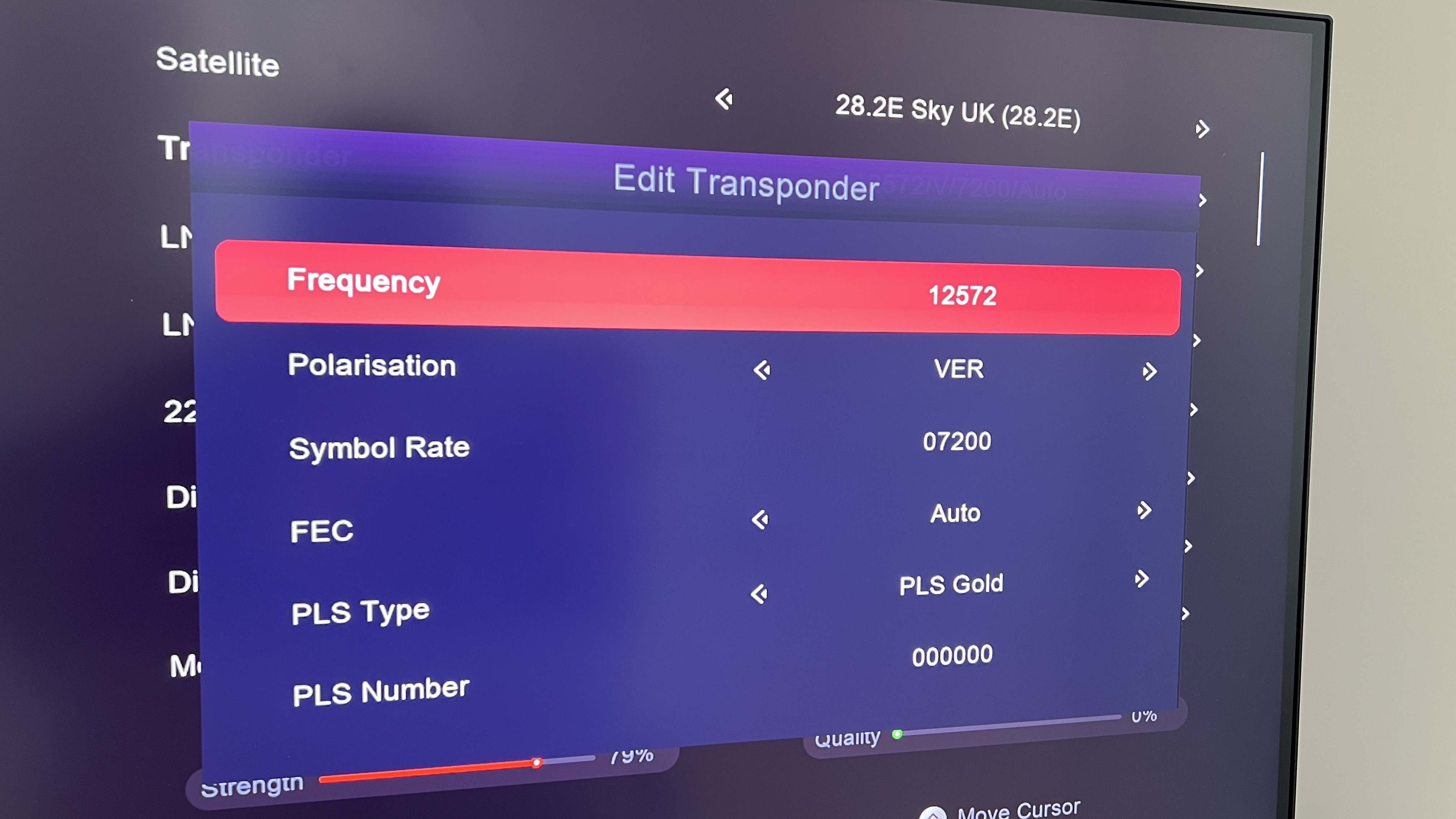

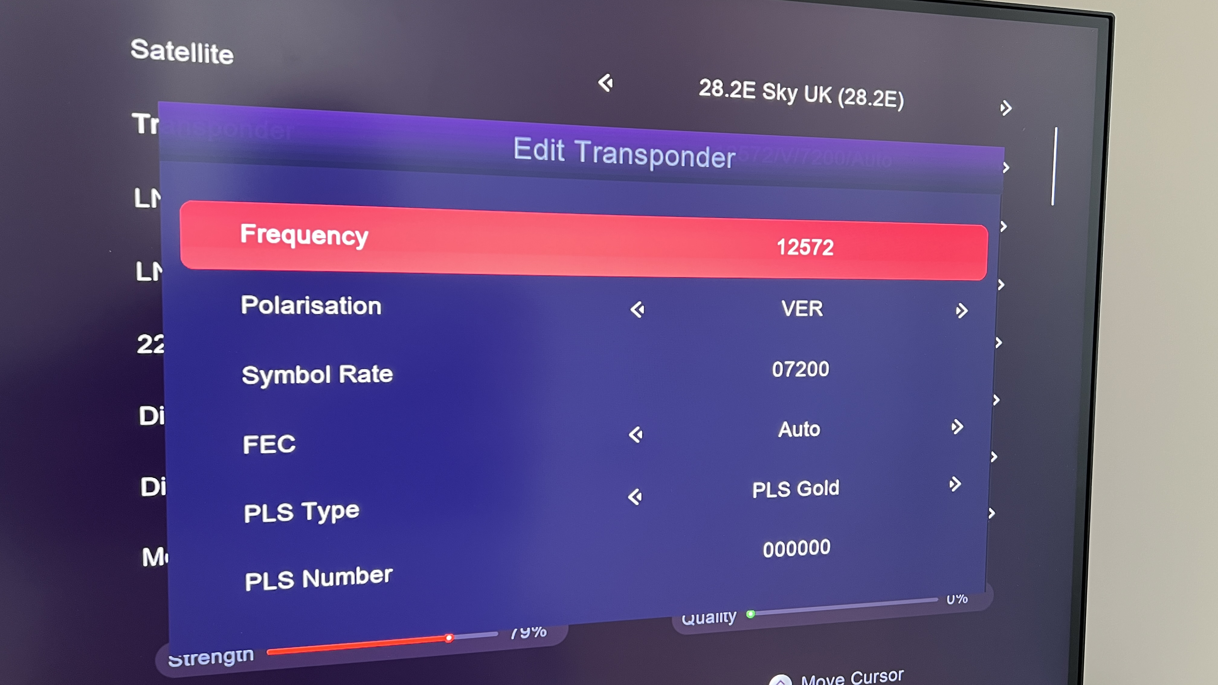

Get a channel on that's on 28.2...click menu go to installation..then scroll to right where u see what Sat your on...scroll down to transponder click red button to add..then enter details of feed ..relax and enjoy the game ...Halla Madrid🤣
Thank you mate! Weirdly I got 80% signal but 0% quality on it which was unusual.
This is what I entered and strength was 79%. Quality was 0%.
