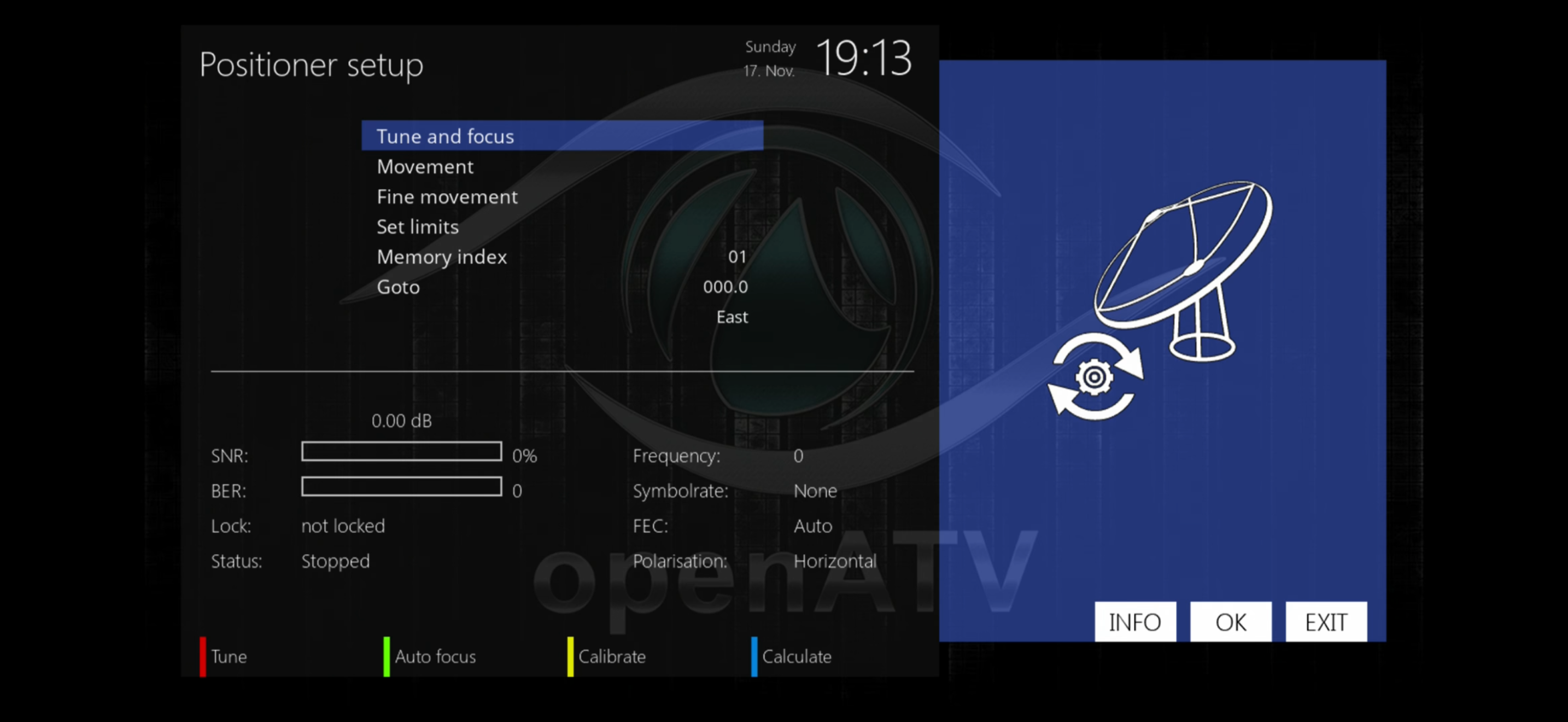

Thanks for the response. It does have a list of satellites to pick from but even in the satellite signal finder, manually telling it to move east or west does nothing unfortunately.

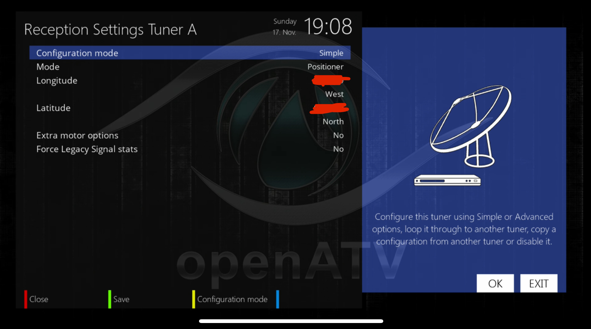

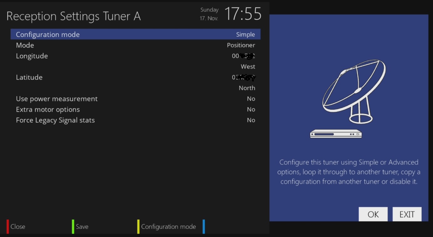

You do not need to be in advanced to get usals to work. On the first tuner page when setting up the image select simple. Then on the 2nd line down where is says mode toggle left and right to positioner. Then enter your long and lat in and use the green button to save.

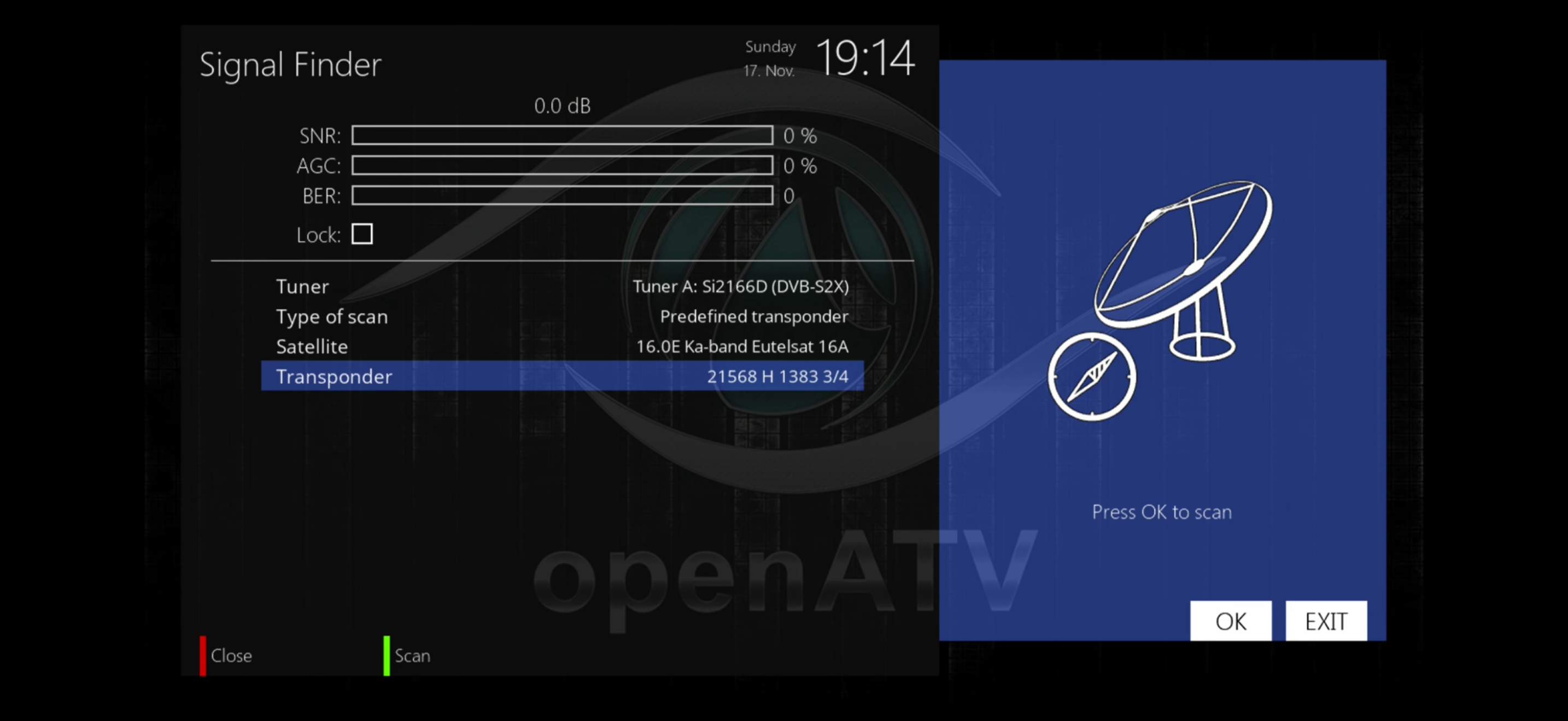

Thanks for the response. I have tried that and still no joy. This is the current config. The satellite is currently pointed at 16E because that’s what it was left on when I moved from the GT Box
There’s also plenty of satellites in the list

Have just noticed when using positioned setup the status says “Warning: no LNB; using factory setup”
Update: it’s now opening channels on 16e but when I click on BBC on 28e it says it’s moving but it’s still fixed on 16e so from what I can understand the dish just isn’t reading the commands for some reason. I know the dish is working fine because it still moves when using gt media
