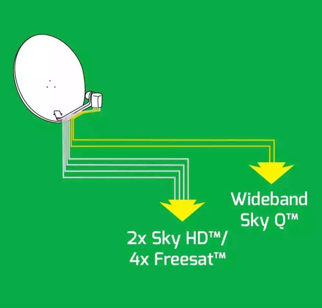

I would have thought that the hybrid lnb would have two wideband ports for your sky Q and 4 legacy ports so using a port from your Q box to the tv wouldn’t scan in all the channels as it’s connected to the wideband port at the lnb

Yes that is what i thought. I have the same LNB with 2 of them being wideband and 4 of them as legacy.

I have that same lnb. All 6 ports are hybrid. It has been discussed on other forums too. Sky only switched to the 2 Wideband and 4 legacy ports later.

[Strike]I beg to differ with previous advice. A hybrid LNB has wideband and universal ports. The ports themselves are not hybrid. The wideband ports are horizontal/vertical. They will work in a limited manner on a non-sky Q receiver for the frequency range that the wideband port works on. There is no high/low switching. You can double check by moving the wires used for your skyq into other ports. Label the wires before you start moving them.

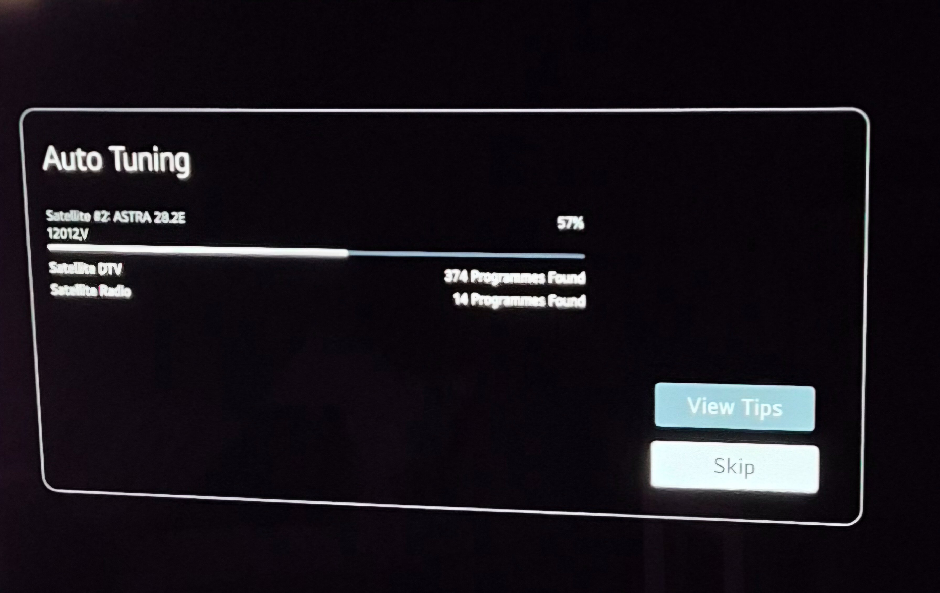

@Mr Bridger can you do a blind scan with your TV please?
So rather than set it as freesat, is there an option to scan for all channels on 28.2E rather than the limited few that are freesat?
Scanning in progress 19.2 took it to 50% = 195 programmes found, now scanning 28.2 very slow but programmes are going up.
We'll see what happens when its done.
load of channels, over 800. Most of it says No CI Module and don't work. I guess its just the freesat one that do work.
Lovely! I think that confirms it that you are getting all the channels o 28.2e and that this lnb has 6 "smart" ports.
