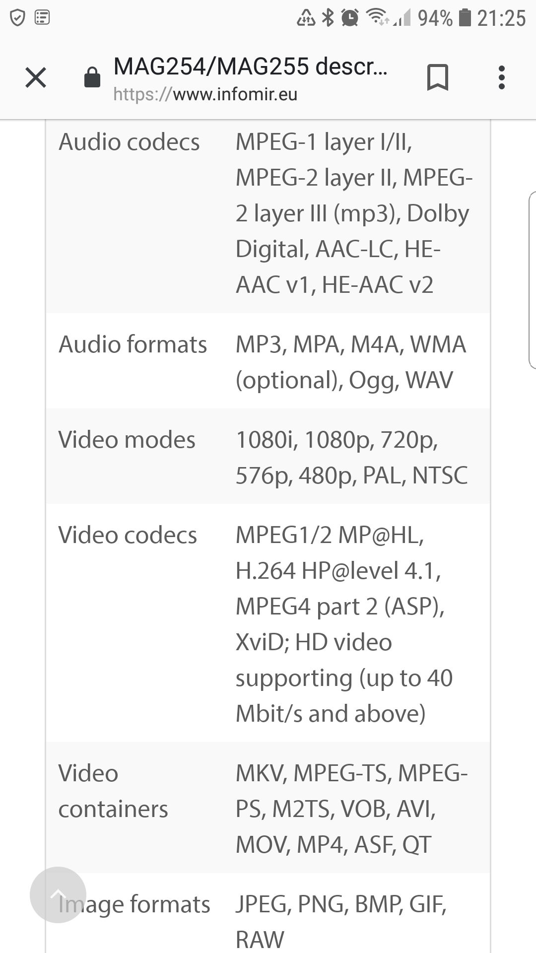

I would guess it's an audio & video codecs problem. I have had some VOD that would not play on a mag 256. It was encoded H.265.
Here is a screenshot of the file extensions and audio and video codecs that are compatible with your mag 254.
Hope this helps.

I have been in touch with Informir support & they advise that they do not support the DTS codec which is becoming increasingly more popular on VOD and I believe is to also be used on live tv.
I have noticed more & more of my VOD will not play audio because of this, i have used mag boxes for the past few years but not anymore unless they release a patch/firmware to fix.
