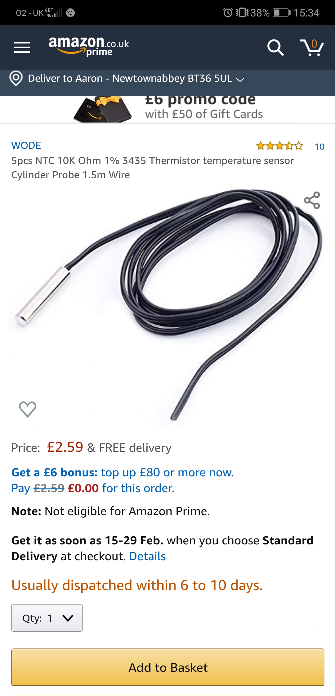

Is the sensor built in then?
Also I noticed the one with wireless control is £22 not £16 is this the one you got?
As rapture has pointed out it’s live, neutral, earth which are straight forward then your yellow is your ‘switch’ wire which will fire the boiler up when the stat asks it to.
This is the spec you need
NTC 10k 1% thermistor
There's like surface mount ones you could prob get away with.. would save cutting back that lead etc
