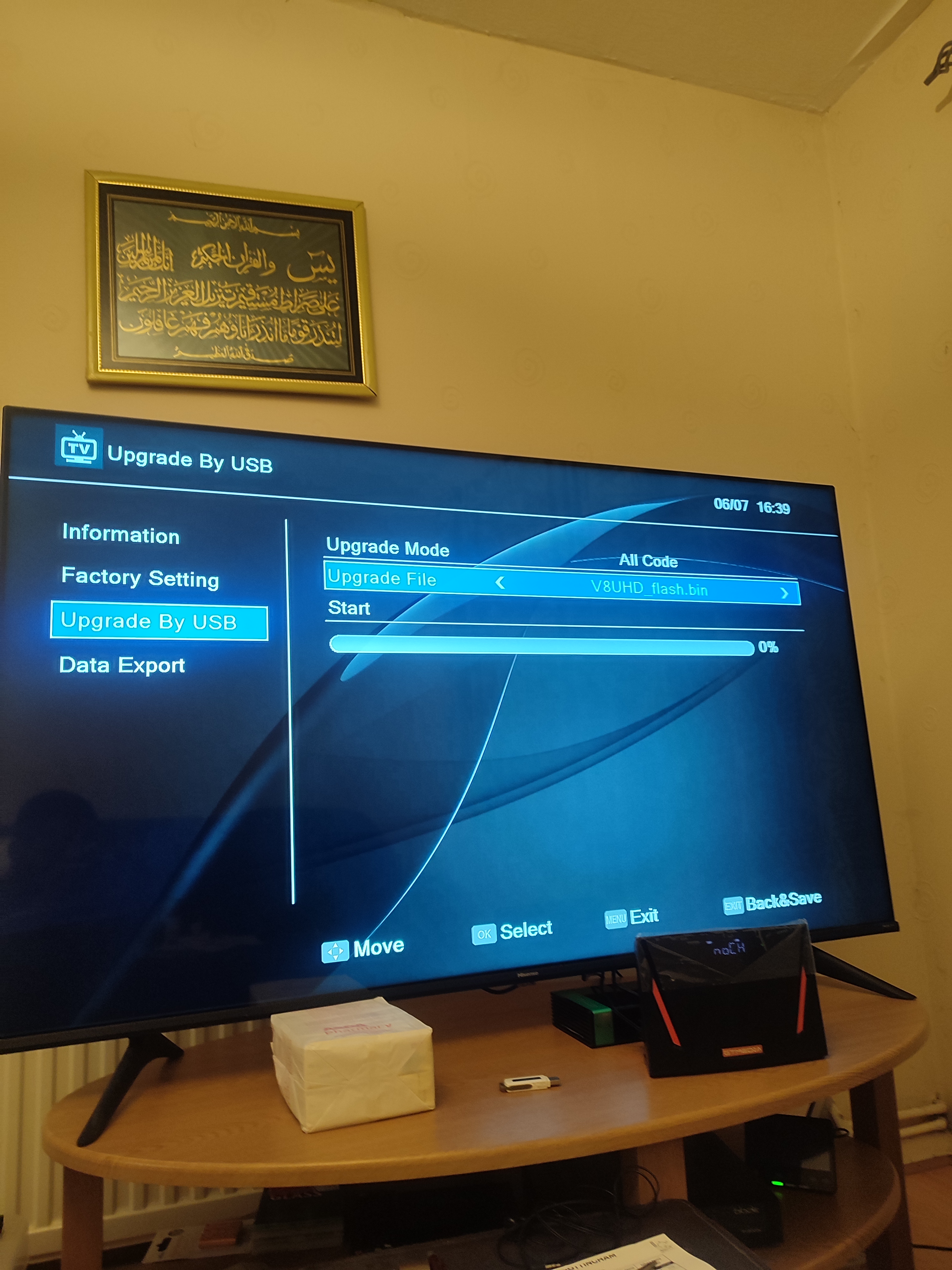

Usb fat32 formatted
To upgrade the mars v8uhd firmware from the original v8uhd firmware, you need to copy the backdoor.key and mars v8uhd.bin firmware files into the usb root directory.
2.then enter the "upgrade by usb" menu, select the upgrade mode as 'All code', to upgrade.
But assume this is what you did
Possibly a corrupt bin , maybe try and older fw as suggested. Good luck

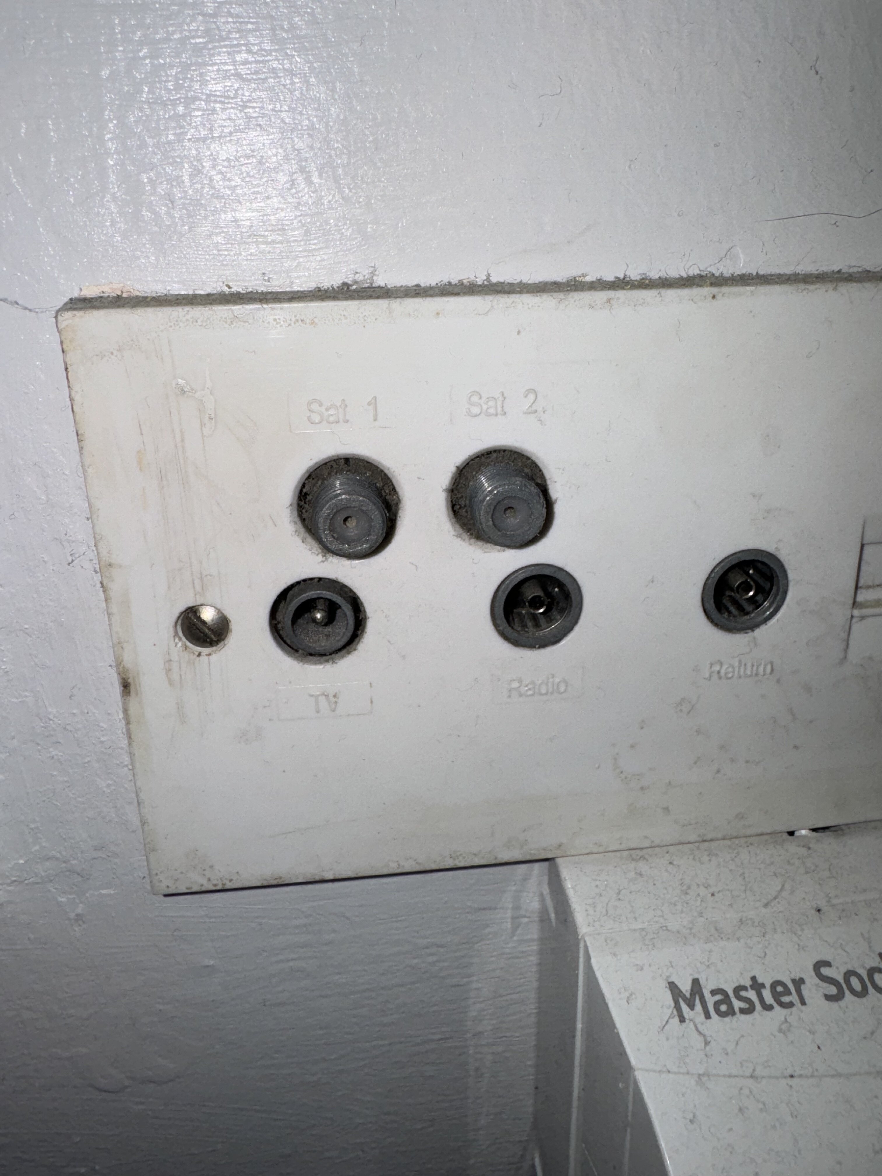

Does anyone know if viarks can be used in a communal flat system? The ports he has are these. Dont have a sky box to test it unfortunately.

Ask your neighbours if they have had anything working on it ?
Otherwise it is hard to sat it could be a skyq setup or just bog stock hd setup.
It should do get him to ask a neighbour if they have a sky box working via the communal dish. Viarks can get various sats but he will only get 28e if in the uk.
Cheers for the fast reply guys, much appreciated! I’m gonna try borrow a friends to test it. I imagine it will just be using a f connector from either the sat 1 or 2 port into the Viark?
F type Fly-lead get it for couple quid is all you'll need and Ethernet cable or worst case scenario WIFI Dongle which will only support 2.4GHZ
even worse case scenario you'll FOR SURE get UK Freesat ..Good luck : )
