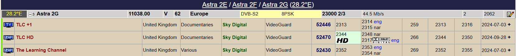

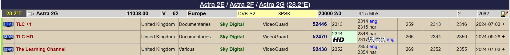

Symbol Rate is wrong, it changed along with a lot of others a while back. Change the 21999 to 23000. Personally if I was only using 28.2e I would just do a blind scan.

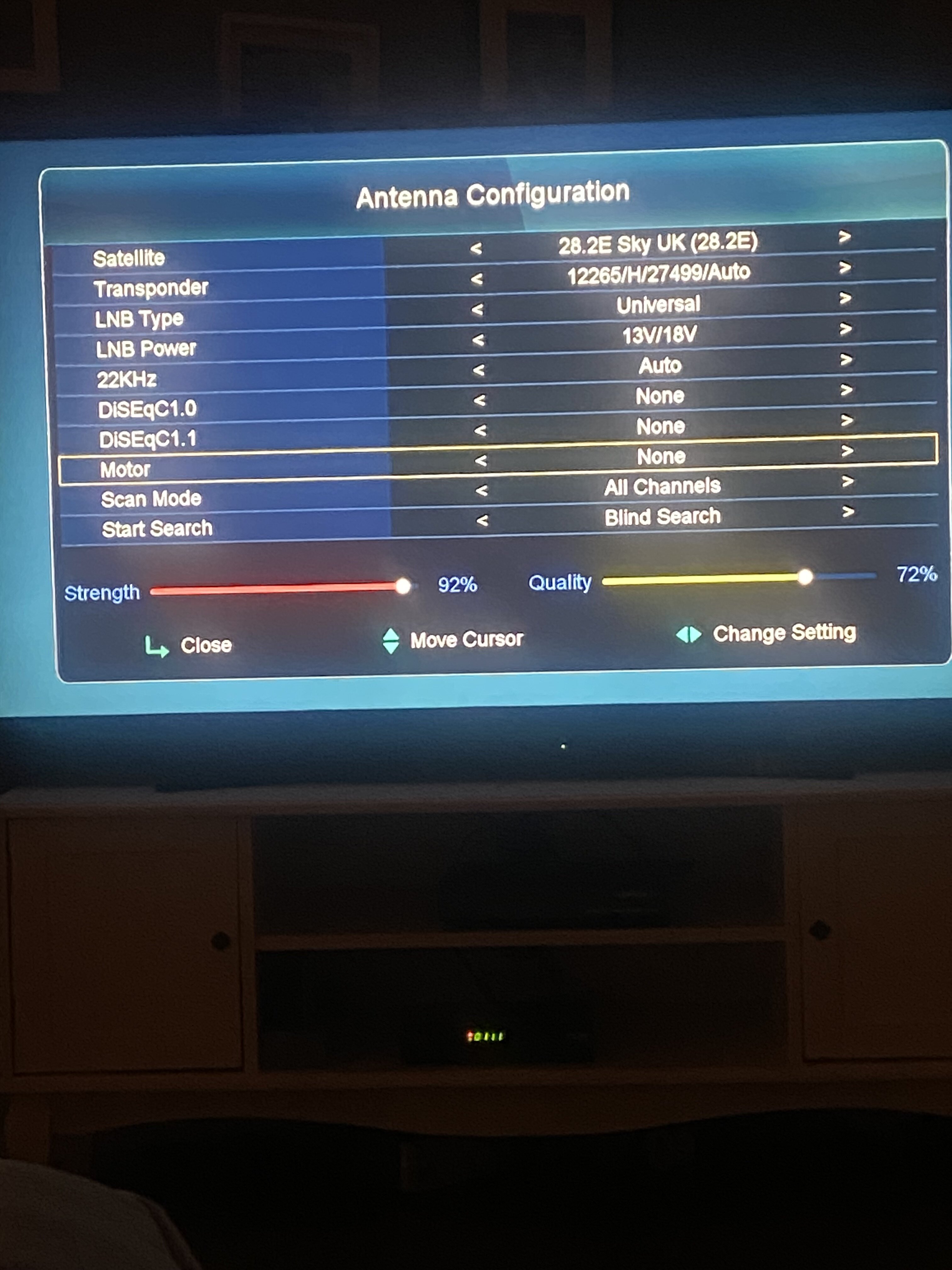

Am I right to go ahead with the scan now ??
Should be OK you'll just have to go through the channels and put them into some sort of order.
