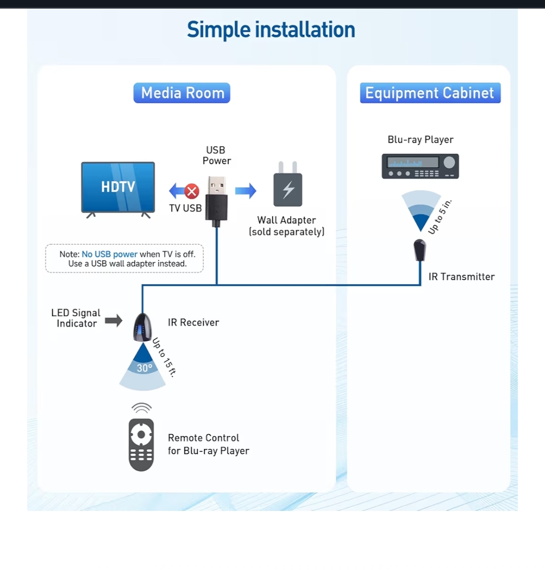

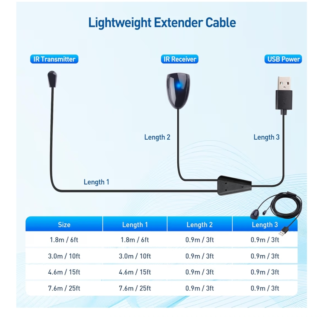

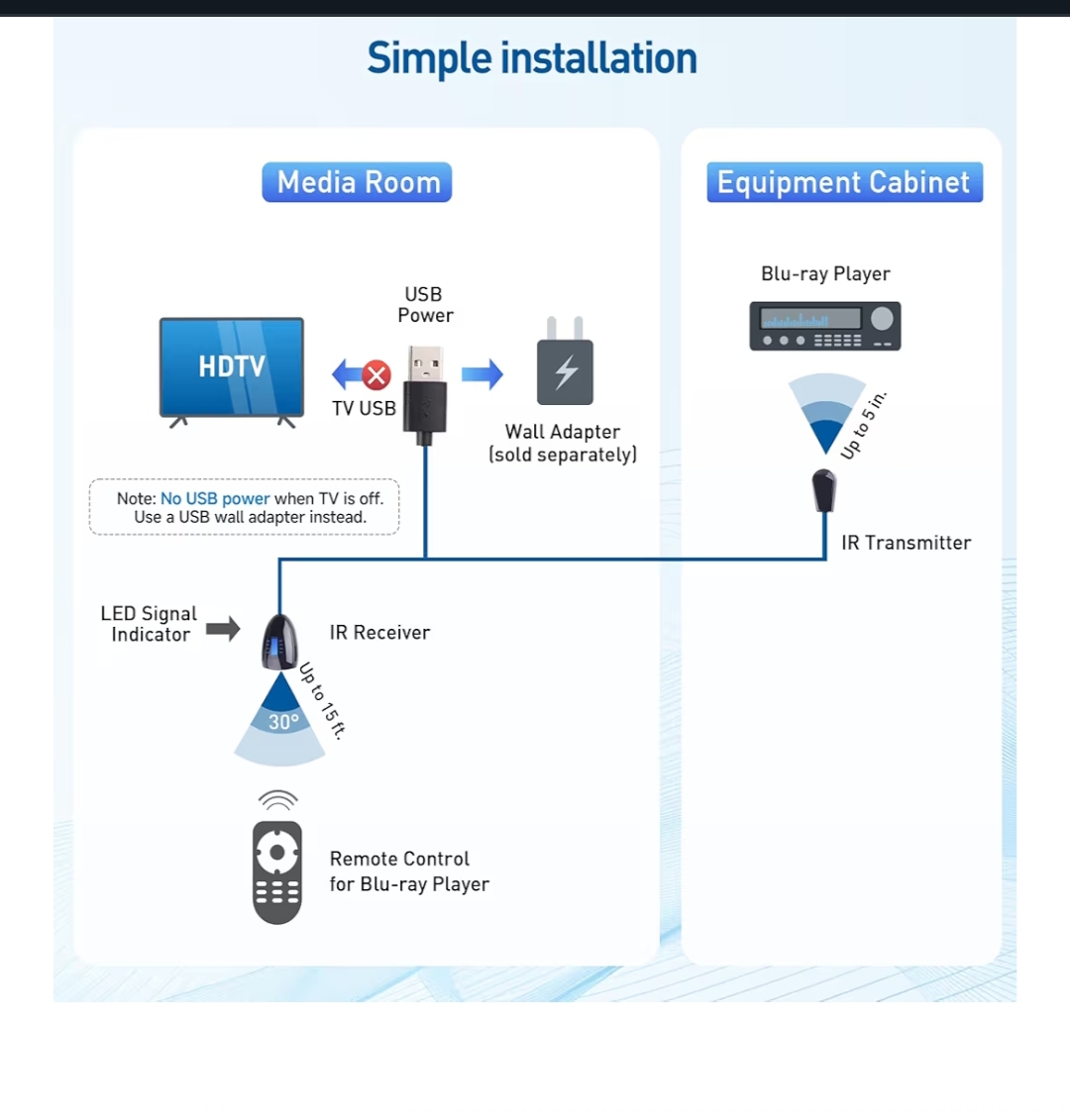

He wants to hide the viark completelt behind his wall but still be able to control the receiver using the IR blaster. I remember on the forums someone said this was compatible.
We tried plugging at the back of the USB but it was not working.
Where do you stick the smaller part of the thing on the box? If someone can show me a diagram of where to stick this i can let him know.
There is already a picture on the Amazon link if you scroll through them.
I also have the same setup for my box.
The USB needs to be plugged into a wall outlet and not the TV.
The small IR sensor goes on the front of the box, and the larger one needs to be visible as this is the one that receives the signal from the remote.

Can i use the USB power from the VIAKR itself?
You can try it, but when I tried to power it from either my TV or the box (I can't remember which as it was so long also!) it didn't work as there wasn't enough power or something, so I used an old Apple phone charger and it worked straight away.

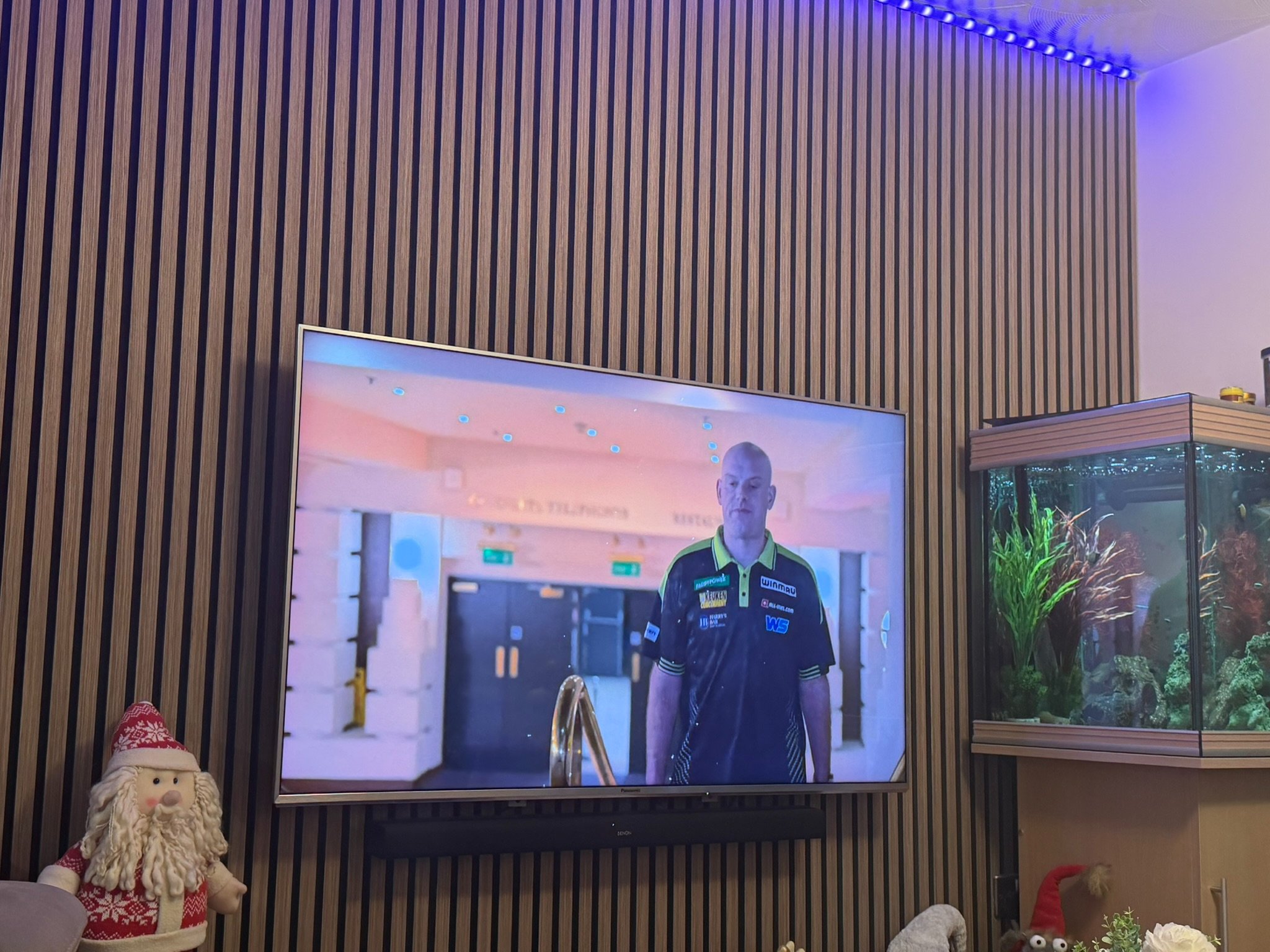

Yes, I have an IR blaster to control my VIARK that's hidden behind my TV. The USB is plugged into a port on my extension lead, not tried it on the Viark as I regularly put a USB drive in there.
