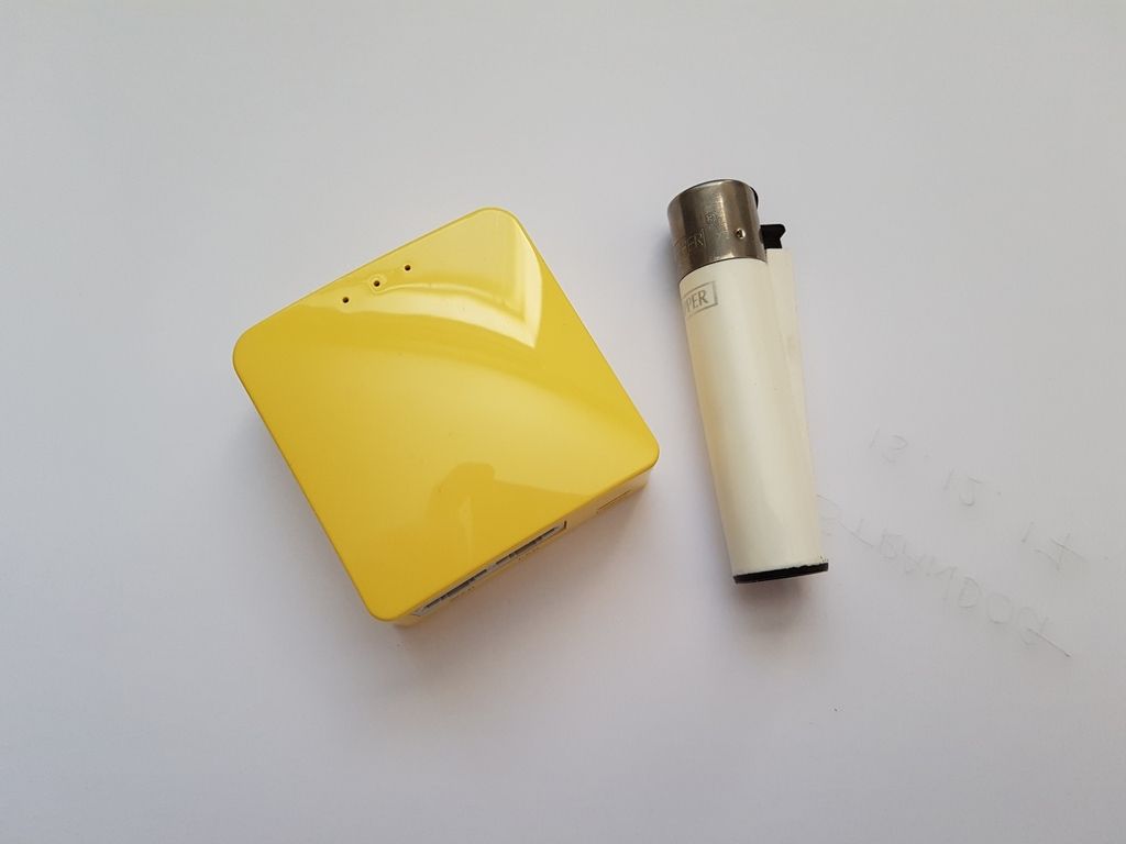

absolutely mint for the price..tiny little thing as well, powered by a USB lead...dead easy to use, load your openvpn config file, mess with a few settings and wallah! all done...what ever device is connected to the LAN is now sitting behind the VPN. :)
hmmm...posted a pic in the "for sale" section and got a like of the admin? i can see the above pic? it's hosted on photobucket? any way can post it again using that link....

any way i thought i'd drop by with an update on the device.
it's not as easy as i first thought, once you give it a static IP address (for example i gave mine 192.168.1.222) you can't access it via your network, (so you can't get access to the web page via 192.168.1.222) you can how ever access it via your network using the web access IP address and your port (yes this sounds dutch) so for example 192.168.1.22:83) what I mean is you have to open a port on your router (i have 83 opened and have also added the static IP address of the router to DMZ.
you also get an external link that you can access but i'm not really wanting to open a port and leave that open via the WAN.
Have fun, up and working here for me via the VPN

Quite easy to do, i bought a VPN for £2.00 a month over at https://digibitdesign.com/vpn/ and they will send you the openvpn config files.
attach the new router to your LAN and access the web interface of the router, (192.168.8.1) then give it a static IP address of what your network uses. (so i gave mine 192.168.1.222 rather than the 192.168.8.1 address
Under settings there's a "allow access via port 83 on the WAN that you enable.
Then in your normal router allow it either to be under DMZ (192.168.1.222) or allow port 83 to be open on your LAN.
Then simply attach the WAN port to your network and the LAN side of the router to your device that you want to use the VPN.
Then you can log into the router using 192.168.1.122:83
From there, go to VPN and upload your openvpn config file of choice. (good idea before you do this is to experiment with openvpn on your PC and the config files and see which one gives you the best upload and download speeds)
then in the router you simply upload the open vpn config file and input your user name and password that you get from your VPN supplier, as per screen shot above. then enable and wallah, away you go. the device that's connected to the LAN side will use the VPN.
Hi Strawdog can you explain why is it necessary to implement these steps? In my experience all one needs to do is to power up and connect the wan port of the GLi router into any of the ethernet ports of the ISP router, and the GLi router's control menus can then be accessed by 192.168.8.1.
To secure the protection of vpn tunnel (after putting vpn on these routers, which takes under 5 minutes with a set of openvpn files from any decent vpn provider), all one then needs to do is select the GLi router as internet provider for the device (and the device would then be given an IP address of 192.168.8.X).
hmm.. i'm not using the ISP router, maybe that's what I missed, I have the virmin hub in modem mode and have my own router..with it's IP range starting from 192.168.1.1 to 192.168.1.255
When it was connected to my network with the IP address of 192.168.8.1 i could not access the web interface, only way i could was to give it an IP address as mentioned within the range of my network. as it only has 1 LAN and 1 WAN then i figured that your accessing it via the WAN (192.168.1.122:83) as the LAN is connected to the said device of choice that you want the VPN to work on......so it has internet access set the default gateway to 192.168.1.1
