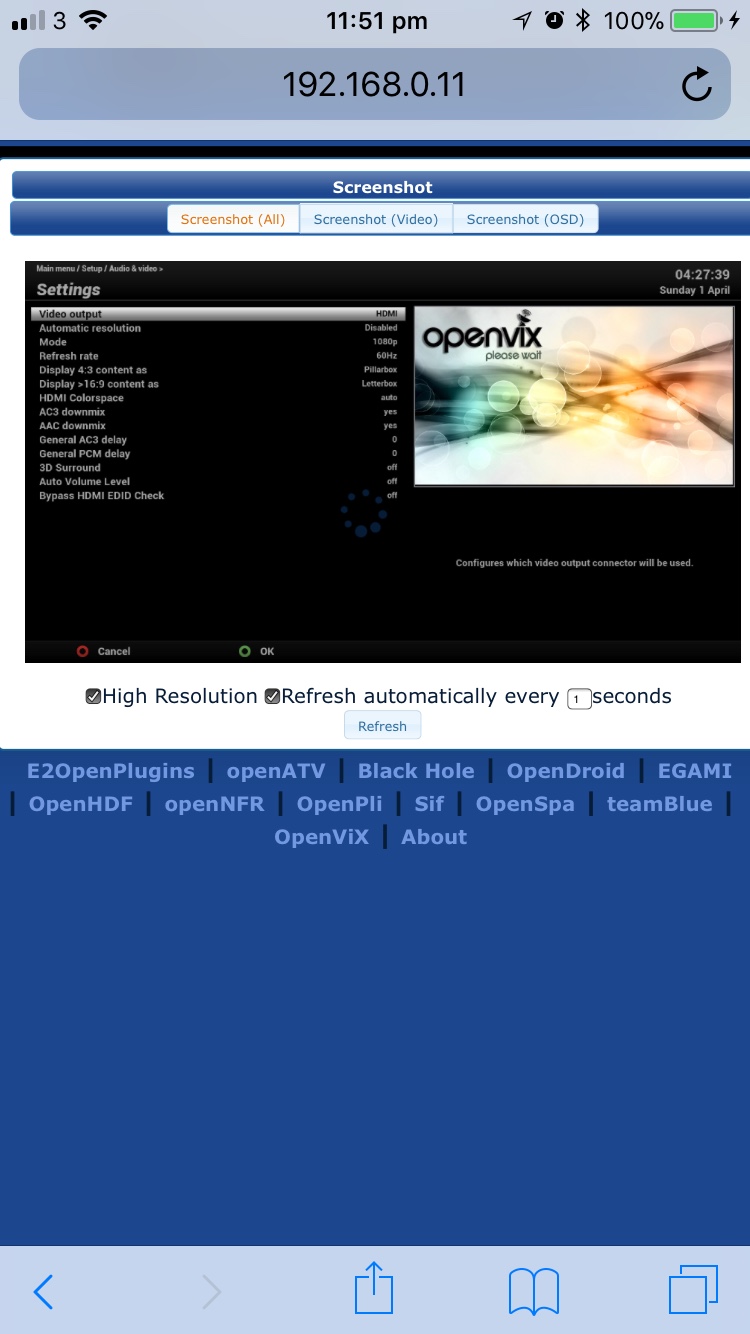

do you get the splash screen on tv also,if you do box is giving out a signal as no hdmi output will give a blank screen and using remote would not see any change?
Splash screen? What’s that? The only image I see is a vu+ Linux logo for about 2 seconds and then nothing
Post 27 shows 'mode at 1080p' and refresh rate at '60hz' maybe your tv wont support that...... try 'mode 1080i' and 'refresh rate 50hz'
