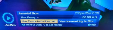

Hi everyone put willobuild with openvix but i am still having a problem with not being able to see running time and remaining time any
help will be great.
