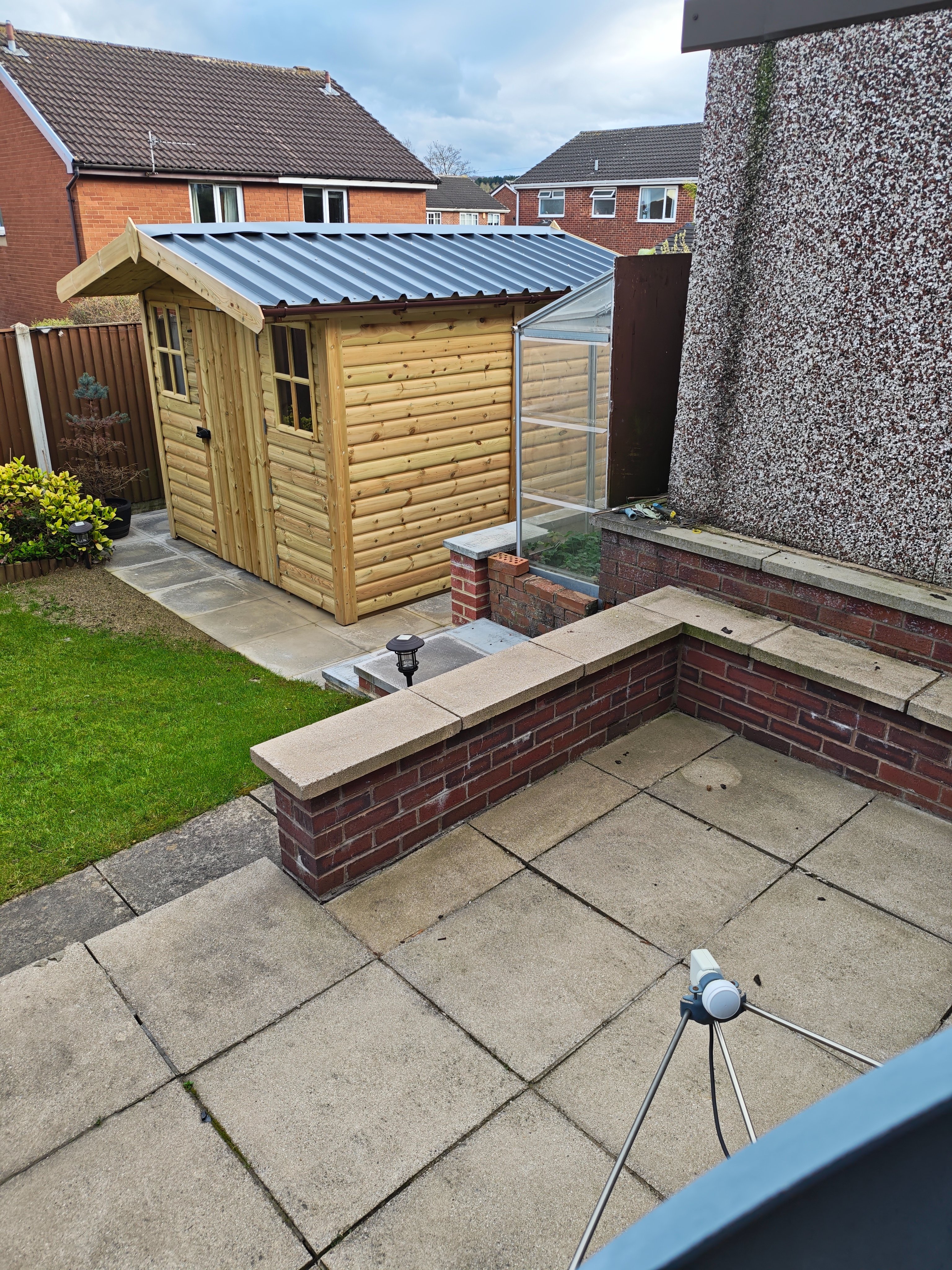

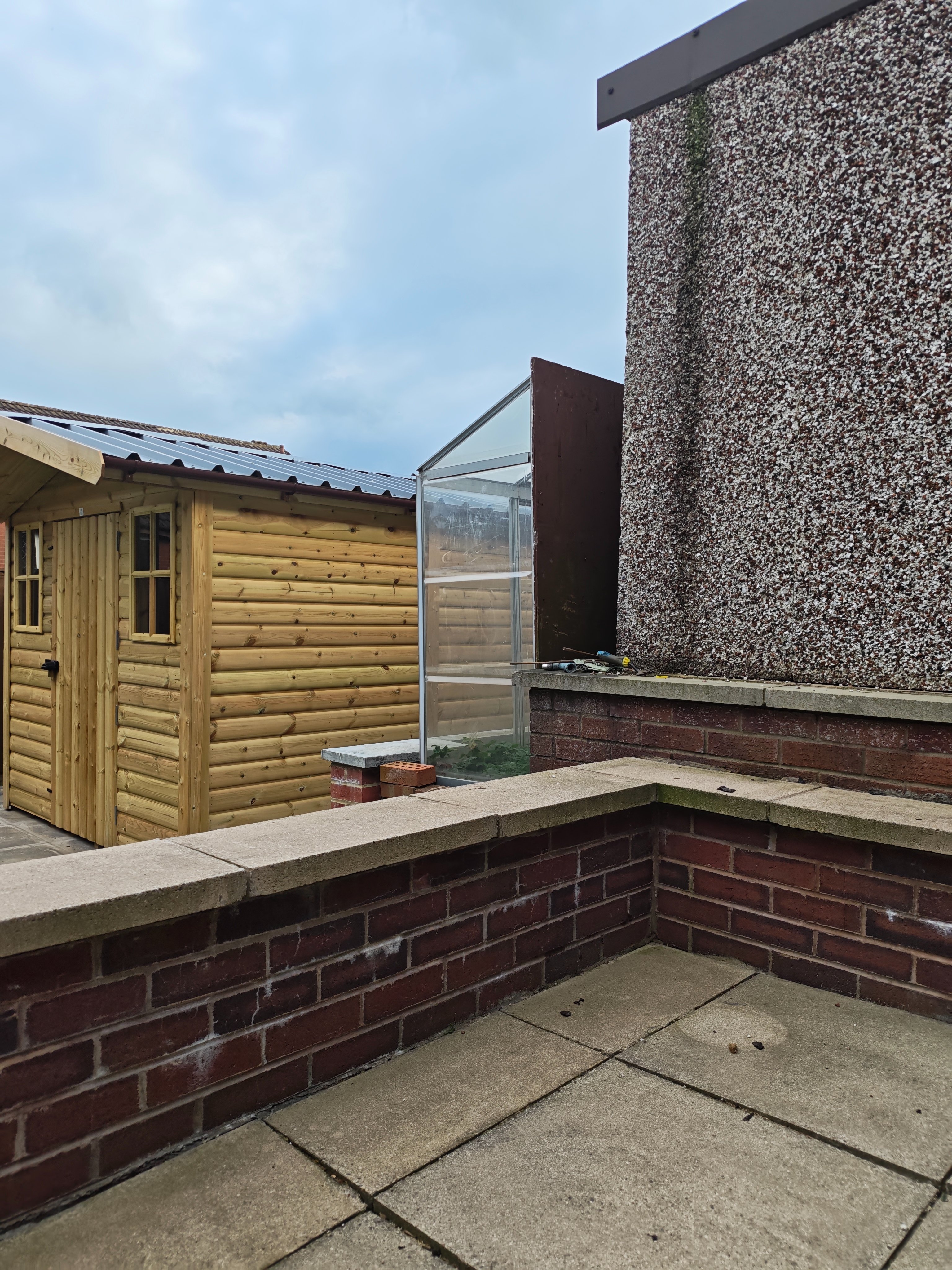

I'm struggling with 7w at the moment not getting a lock with either the 1m or the 1.3 x 1.2m. I have tried qatar hd but no good. Bigger dish might no longer be able to get a signal as I put a new shed/summer house in and I think it's got a higher roof and it was always super tight to get a signal. Pictures show why. I live on a south side of a hill, If you still get 7w what channels you tuning too.
Try Dubai One on 12418 - H - 30000 FEC = 3/4 , DVB-S2 8PSK.
You should get a signal with your 1.3m
