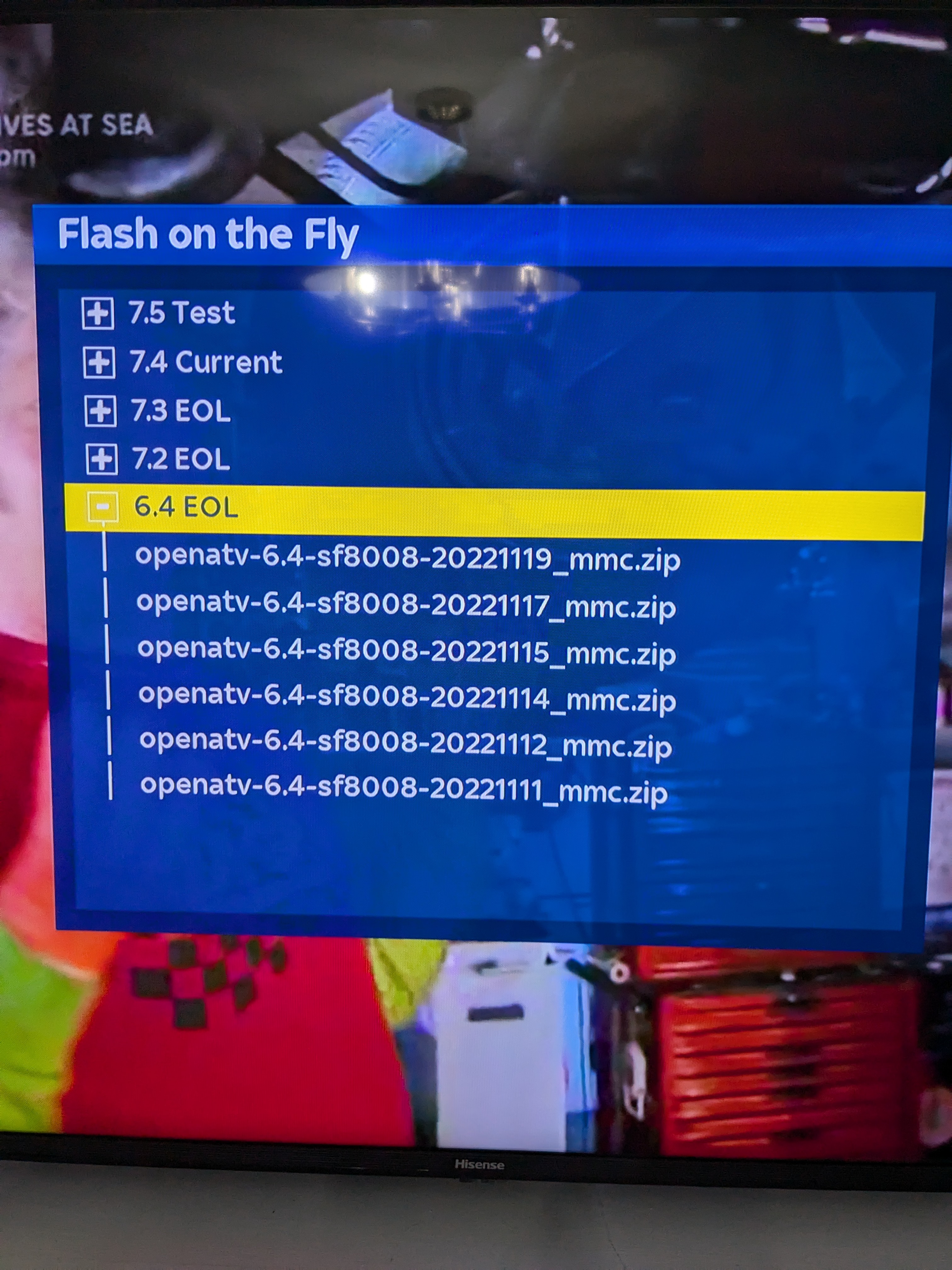

Just got back in and had a look at this. If I press the blue button on my remote control I can see an option for flash local/online image. If I press ok on this I get into a screen that says flash on the fly but have no options other than cancel (red) or expand (green). No other detail on screen. If I press green to expand it doesn't add anything to the screen???
I can't see anything else like Image Manager/Flash Online in any other menus. Is there anything else I can do? Thanks
Try changing skin. Menu… setup… Usage & GUI… skin setup
Change to default skin. If still don't see any images I think you can send the downloaded zip file to media, HDD, images. Then try to see if you can see it in flash on the fly screen or downloaded images screen.
Thanks, seems to have worked to an extent. I now see the following screen. If I select any of the MMC.zip files it just says are you sure you want to flash this image, makes it look like it will just flash ATV, not Openvix as I hoped?
Try sending the zip file as posted above
Thanks. Downloaded the latest Openvix release MMC for my box. FTP'd the file to the folder as you've mentioned but still don't see any change.
