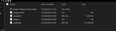

Thanks! I used bootice and followed the instructions pdf. I then downloaded openvix-6.6.005.release-formuler1_usb.zip and extracted it to my USB on the E drive, the contents showed as follows when complete:
  1. I put the SanDisk USB stick in the back of the formuler f1.
  2. I turned on the power switch. the front of the unit shows formuler on the screen, then booting, then it shows the OpenVix Logo with WilloBuild underneath and hangs on that 🤔

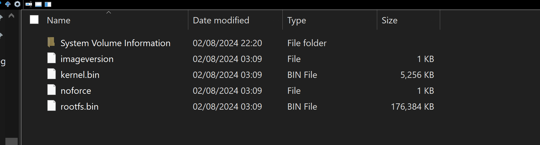

Low level format the stick with HDD Guru then fat32 that should work.
You should extract the zip and copy the formuler1 folder to the stick.
