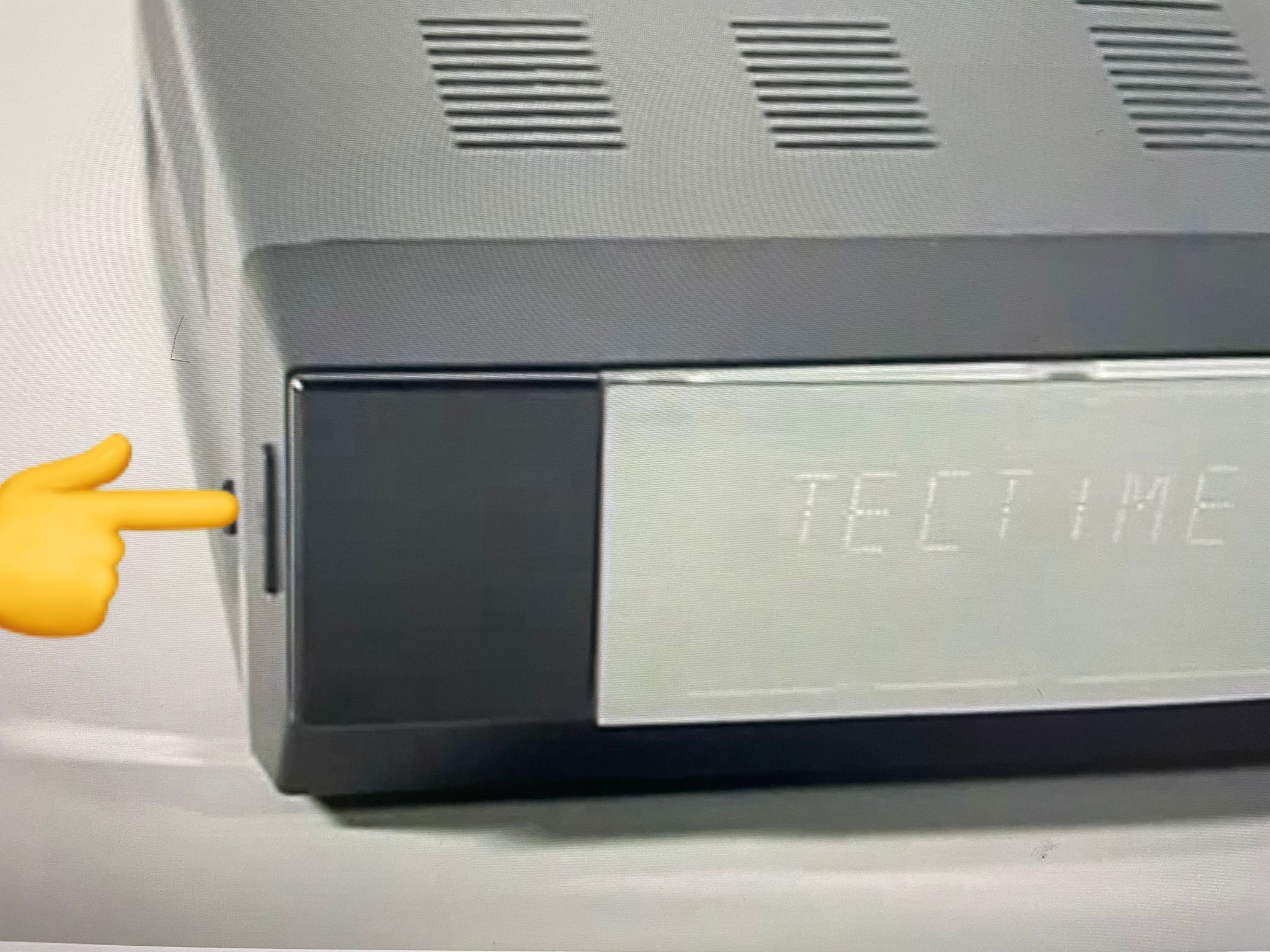

Press the power button as its booting up and the box should start flashing
Mine didn't have a power button I just unplugged it from the wall, put the usb into the back of the box plugged back in and as it powered up it went into flash mode.
Its on the left as you look from front, not the usual place. But I think box may have reached EOL and may be better to try Openatv as a last resort.

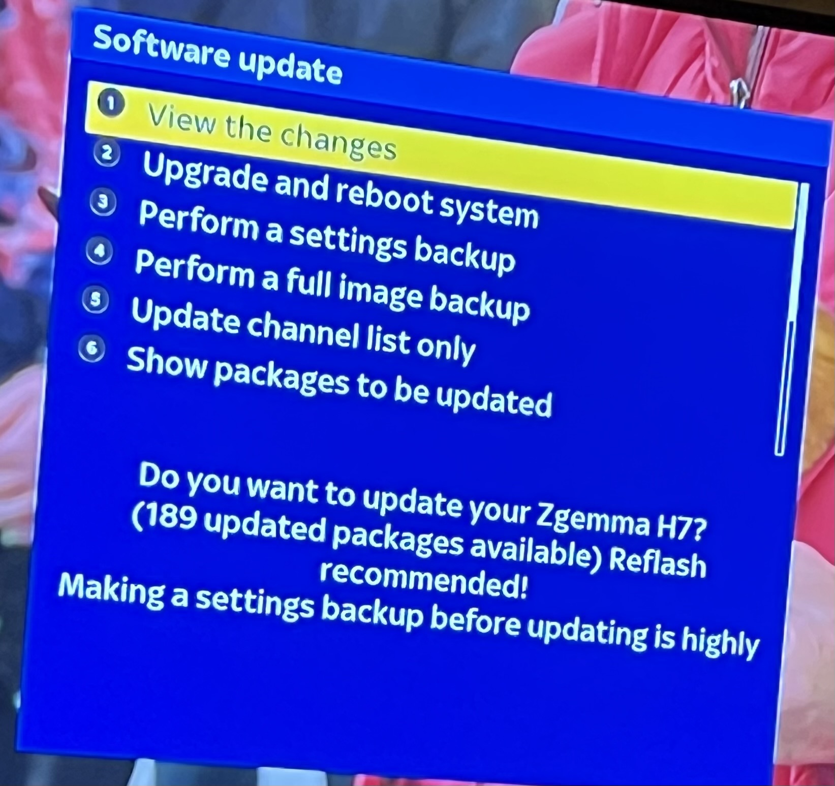

Hi guys very strange thing happened last night when press the menu and then information my box (H7C Willobuil Openvix 6.6) crashed tried three times all same Keep crashing I have willobuild updated from plugins but no luck I dare to say it may be the skin but I don't know here is the crash log if anyone make sense please.
Thank you in advance
Regards
G......
