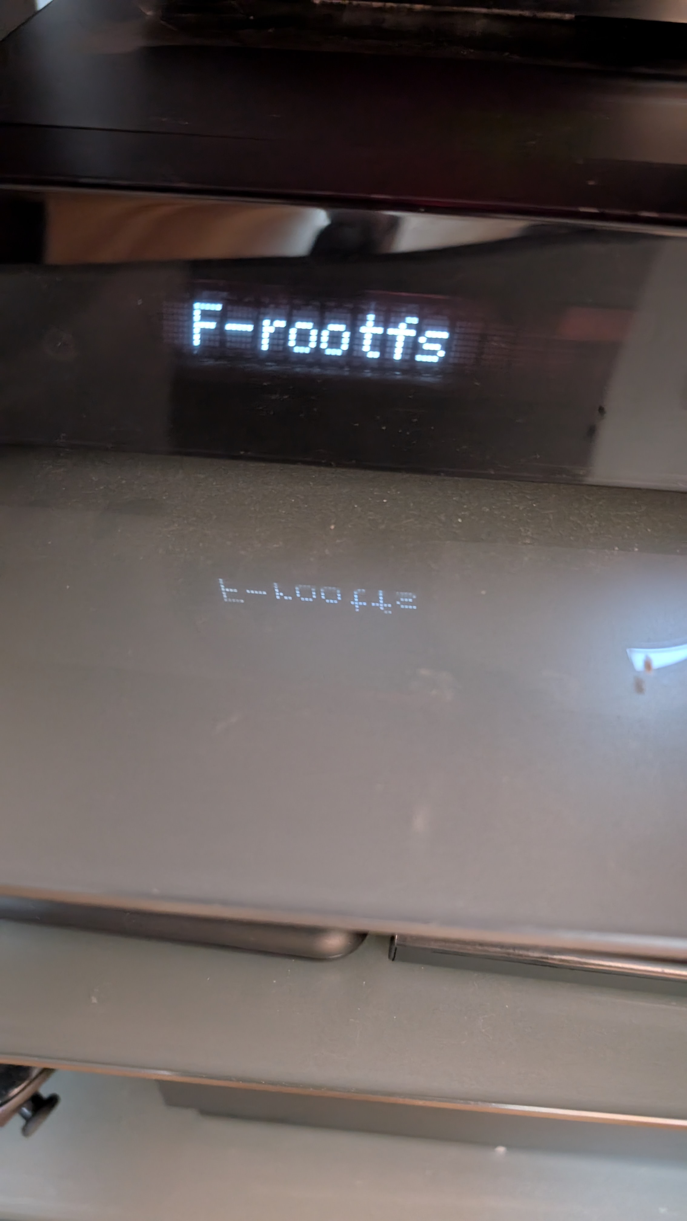

Hi,
I was hoping you could provide some support. I was currently on 6.4 which has gone EOL and was experiencing some issues so I flashed the lasted Nightly build of 7.2 and then used terminal to load Woosh. However Woosh now gets stuck at building on my Tiviair Box at 49% and does nothing. I've tried to reflash thinking it was an issue with the latest nightly build back down to 6.4 but it won't let me resulting in the attached error. Do you have any advice on how I can resolve this please?

You should really do some reading up before flashing these pre builds. Whoosh has had no support for the last 5 years or more and its not compatible with python 3 which open atv 7.2 uses. What box are you using i suggest a usb flash to wipe the box clean.

Damn, but when I try to flash back to 6.4 I still get that error I posted. I'm using the USB flash to get back to 6.4 I've got a Tiviair
