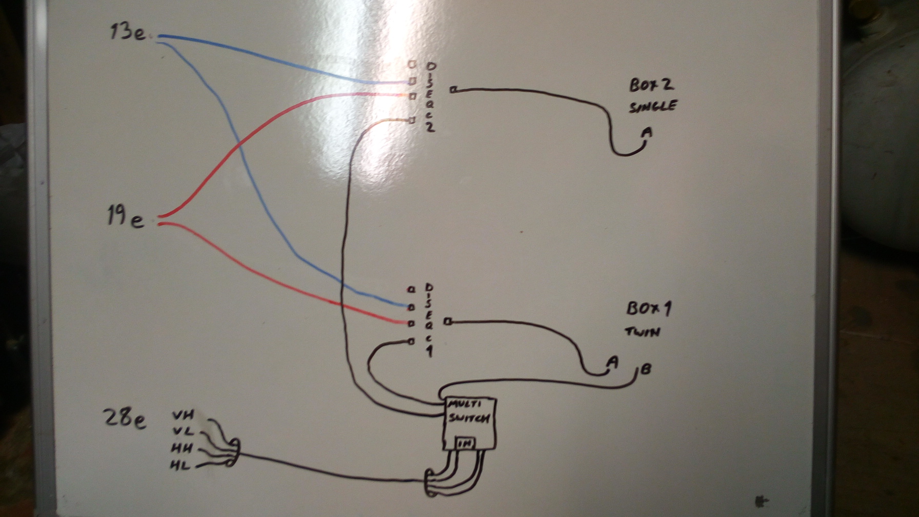

Cheers for this i need to work out the flow of signal, how much cabling, where the switches get sited and what they look like!

my switches are in the loft beside my multiswitch,
the switches I used
https://www.world-of-satellite.co.u...switches/Technomate-TM-4S-DISEqC-4-Way-Switch
other switches are available, but I cant vouch how good they are or if they work via a multiswitch
