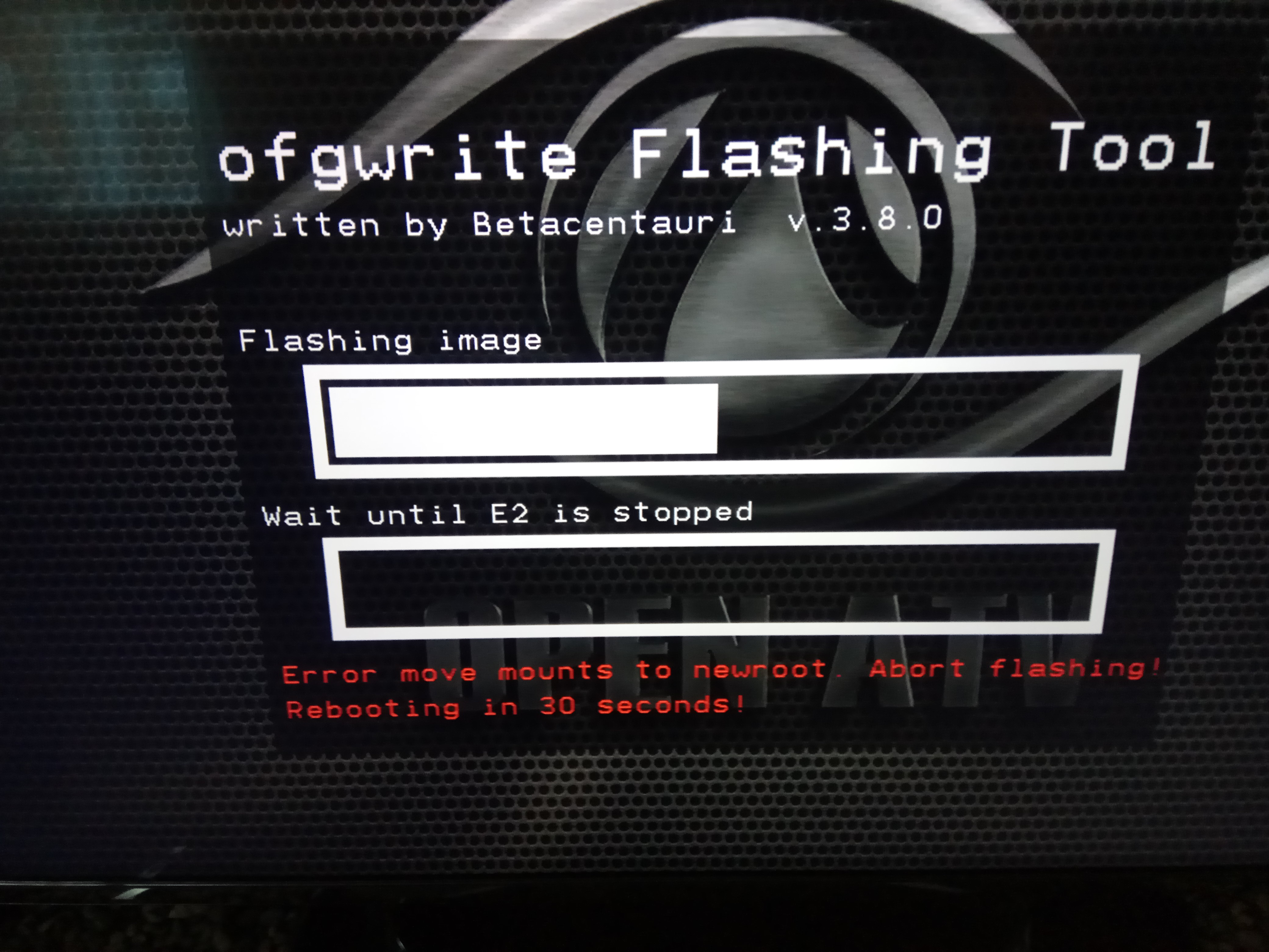

After some advice from wooshman, I'm posting in this forum as I have a problem flashing open ATV 6.1 on my ZGemma H5.2S. I'm getting an error and can't get any further. Any odeas guys ? :-
Try using a different USB to flash from and see what happens.

Hi wooshman, I've got the ZGemma H5.2S. I've actually managed to flash the box using V7.0 It worked first time so not sure why I can't get Infinity on there ?
When you try to flash with just the latest version of openATV 6.1/.2 are you pressing the front power button when the LCD on the front says USB / UPDT ?
It won't just flash on its own, you need to press the front power button when you see the above. WooshBuild pre-made images are set to flash automatically, openATV on its own isn't.
I tried pressing the button wooshman but it just continued to "boot". Is it a press and hold job or just one press ? I'll give it another go tonight.
