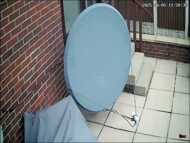

Thank you, do you think giving the 1m a go is worth a shot?
The bigger the better. But, is anything above 1m practical for you? You’ll probably need a vbox to drive a 1.2m dish, a stronger setup as it’ll be impacted by the wind more, etc. Plus, you also technically require planning permission for a dish that size.
I guess it also depends on how big a dish the other half let's you get away with. 😂
I went from having a 1m motorised dish on the wall of the house to having it on a pole in the garden but 7e was always difficult at times, I am in the south midlands.
I am not far from you and have a 1m dish, I get a reasonable amount on 7e but the alignment of the dish needs to be spot on.
