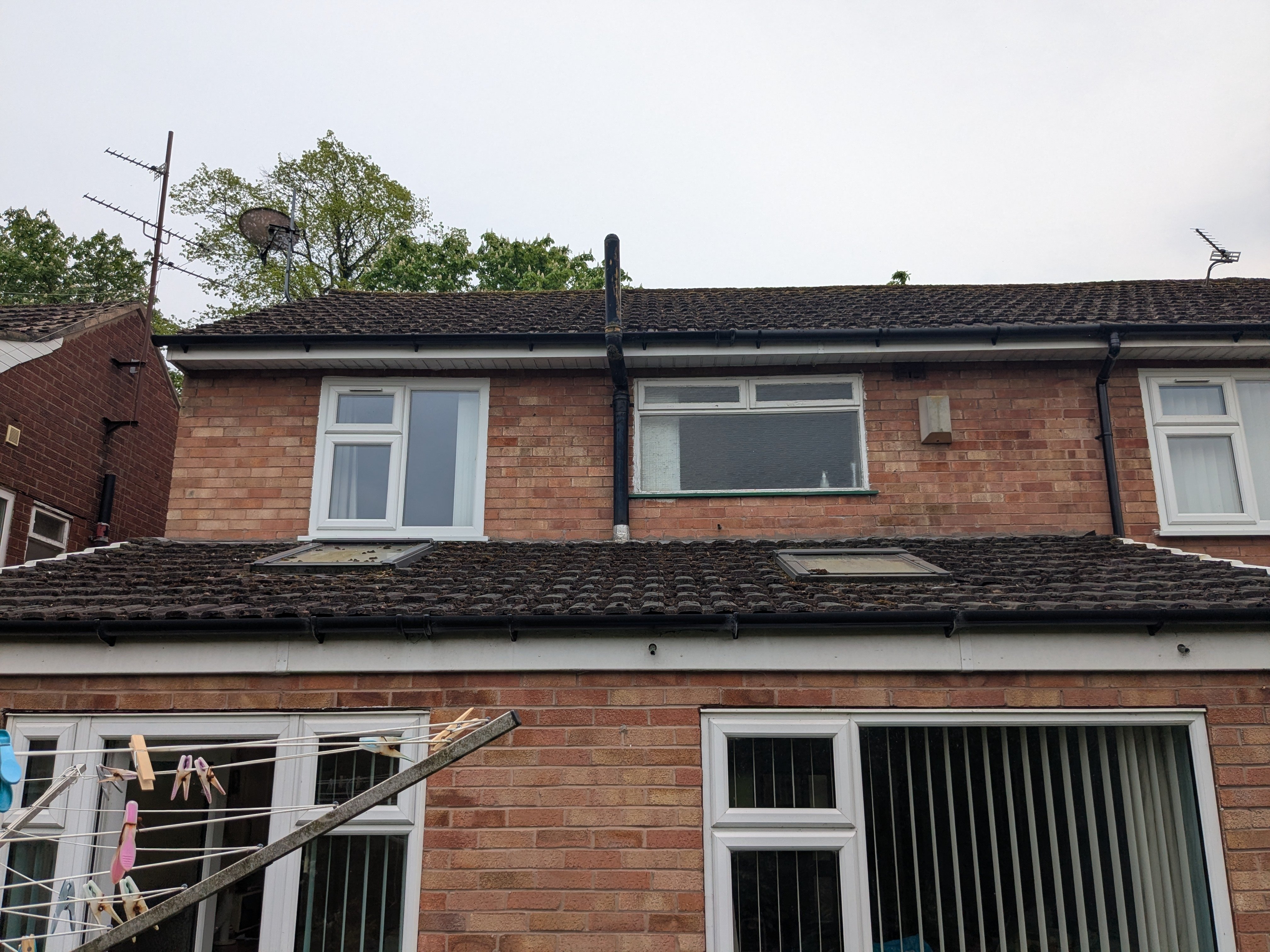

I'm planning to replace a zone 1 dish for my Dad that's above the gable and suffers severe break ups on 28.2e from leaves on trees opposite.

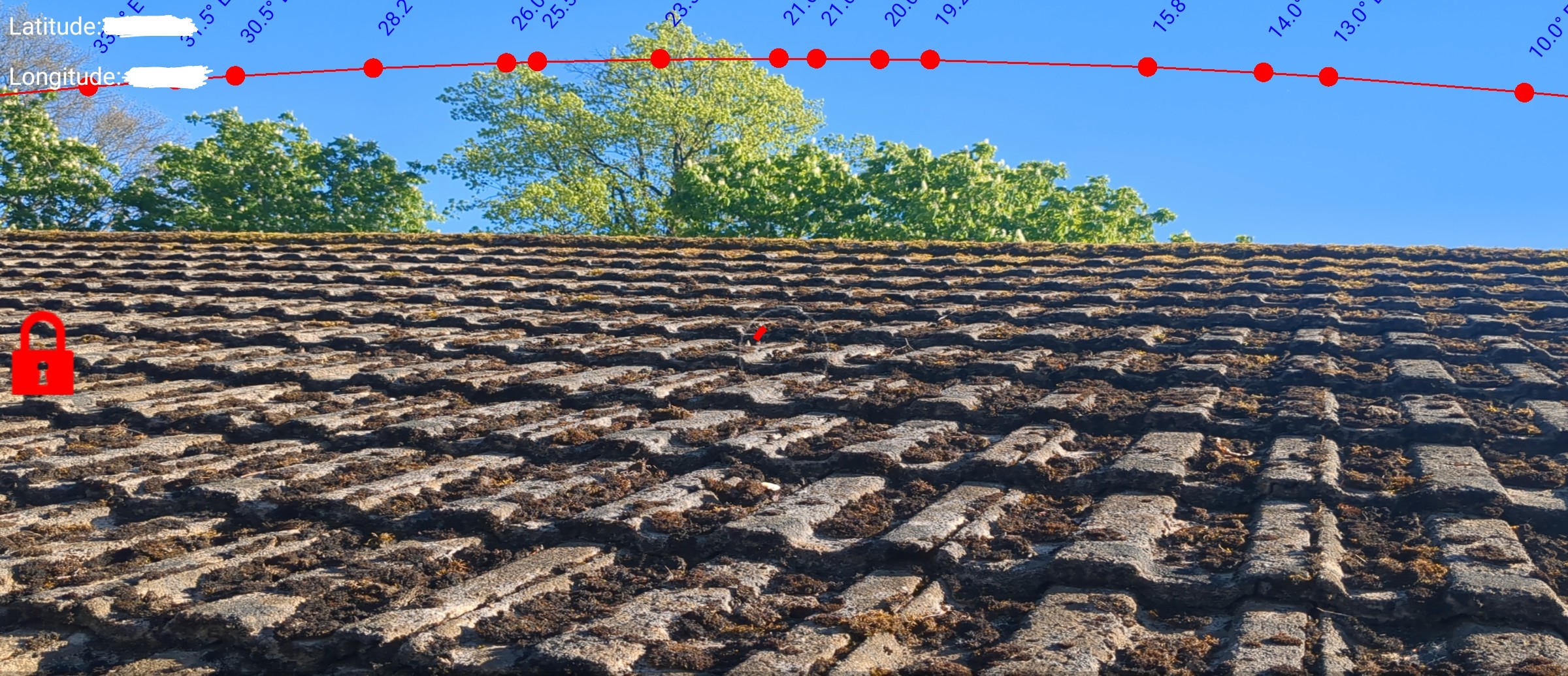

With a LOS for most of the easterly sats from the front of the house extremely difficult, I'm considering installing a motorised dish on a north facing wall round the back overlooking the main roof to gain distance.
He was using Satback when it was on 27.5w due to a lack of options as there aren't any trees at this end of the arc. That was with a zone 2 dish on the front which could be moved to 30w and combined with the new install.
We have a Technomate 2300 motor and a Gigablue UE UHD receiver already.
Considering a 65cm Triax dish, around 24" t&k's, around an 8' x 50mm pole, V bolts and wall bolts etc. Also been recommended a 68cm Fracarro Penta aluminium dish and an 'H' type bracket.
There's an extension roof at the back that I could stand on to do the work where the main gutter is at around chest height. Any thoughts appreciated.

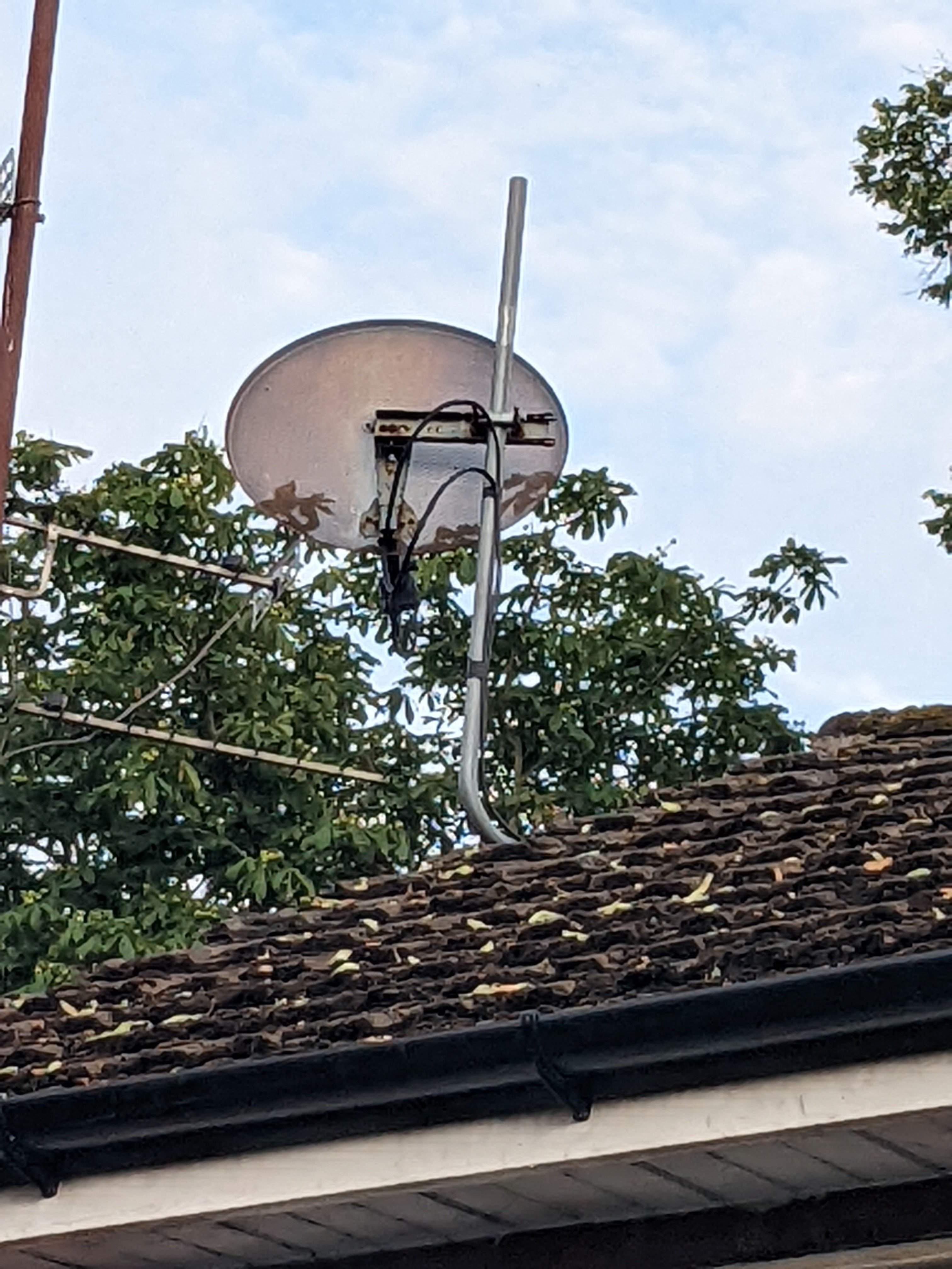

It's the zone 1 minidish seen in the pic in my OP on the pole above the gable end.
It was originally installed underneath the apex on the gable but has had to be moved higher and higher over the years and the trees have caught up once again.
It could possibly go a bit higher still but we can't reach it especially as the gap to fit a ladder is extremely tight and also requires a fence panel removing hence this new install.
Here's a picture of the existing 28.2e dish taken from behind, which you can see faces into trees.

Unfortunately, anything further east of 27.5w including 15w hits trees when it comes to dishes at the front of the house. It's why we didn't move the zone 2 dish on the front to 15w when Satback moved there as that dish now only really has a LOS for 30w where it's situated. Could easily get a LOS for 15w from this new install on the rear though.
