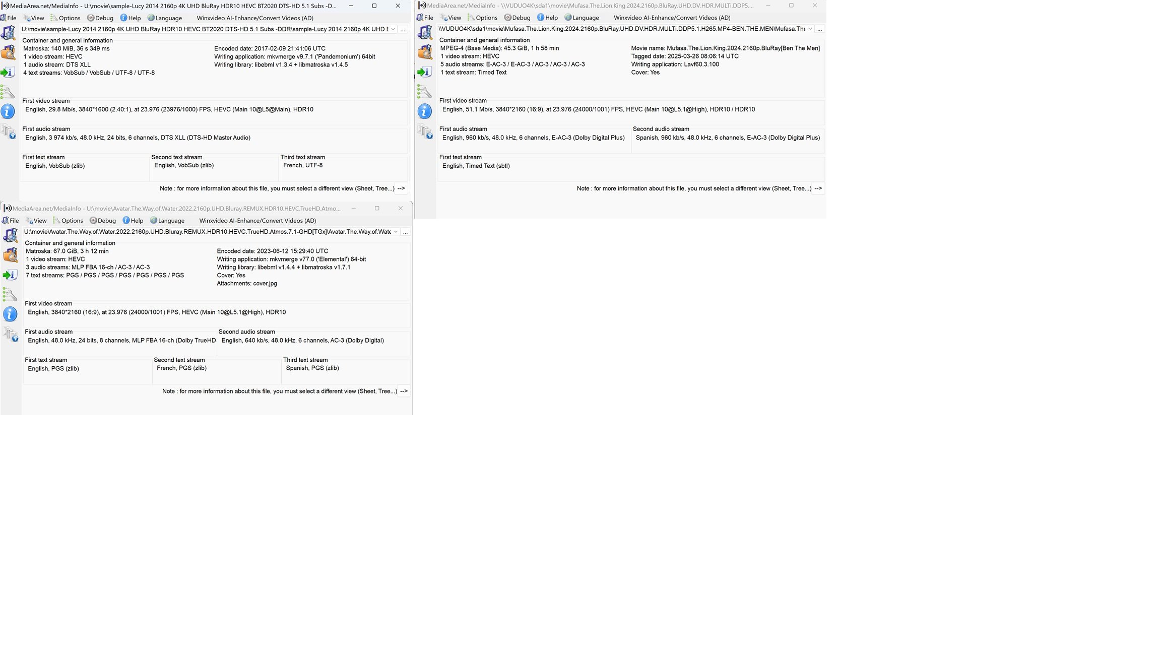

So i am also after media player that can play a lot of the files that my cousin has given me. He has a good VPN and torrented many remux files that i want to be able to watch but i dont have a dedicated media player.
I was thinking of getting the firebube gen 3 which i think would be able to play the files i have. I have uploaded a photo of them. Now i dont think torrent remux files are dolby vision from what i can tell so.

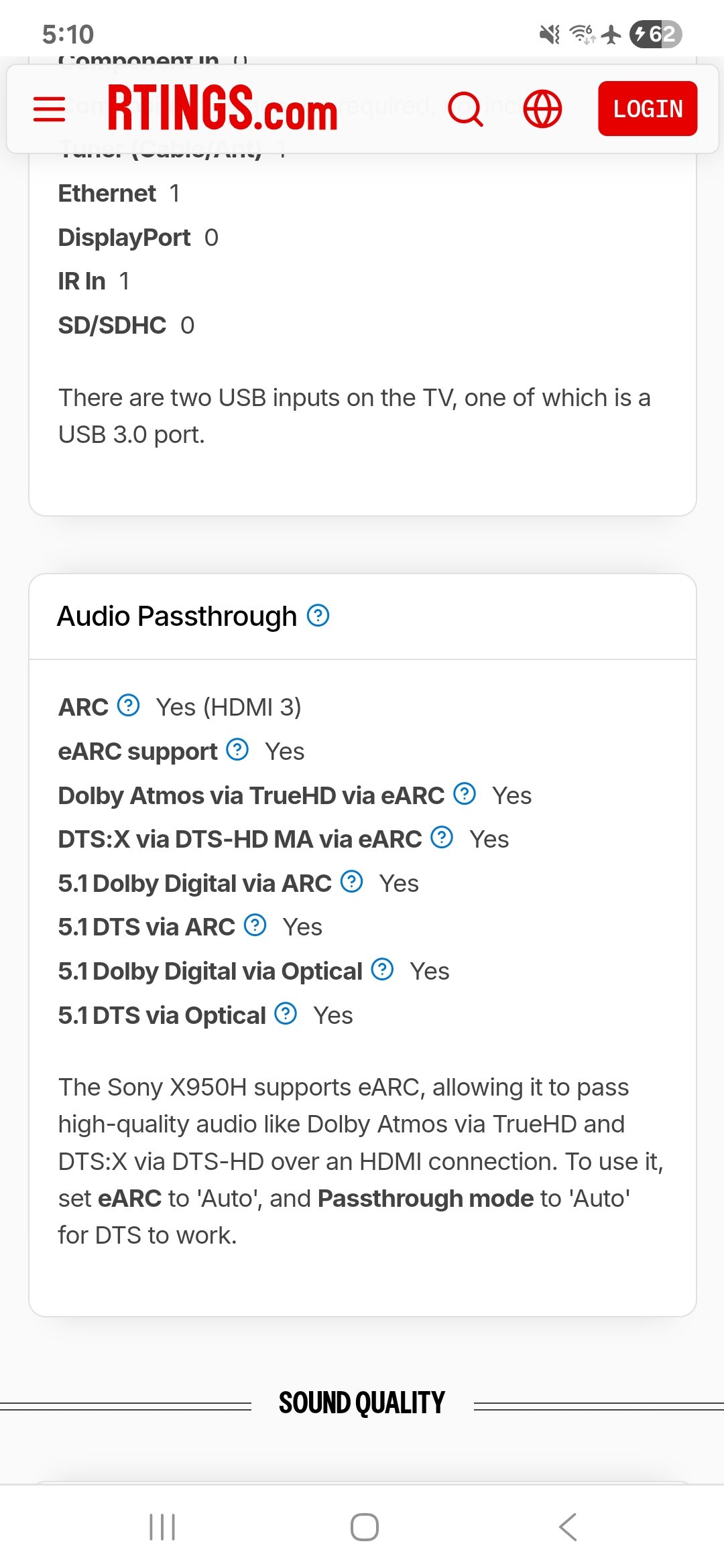

You can pass through lossless audio on a TV from a device that supports full audio pass through connected to any of the hdmi ports on the TV to an AVR or soundbar connected to the eARC port.
The device doesn’t have to be connected directly to AVR or soundbar.
But you will need an eARC port on the TV as ARC doesn’t support lossless audio.
But you can’t pass through lossless audio from an app eg kodi or Stremio running directly on the TV using an AVR or soundbar connected to the eARC port.

My bad I should have stated the it depends on the model of TV also.
So basically plugging into the receiver directly is always better than the tv I guess
Just depends on your setup but if your receiver supports all the formats and codecs then I would plug the streaming device into that.

This suggests that inputting the cube directly into the tv should still mean I get the best audio outputs on my remux files right?
