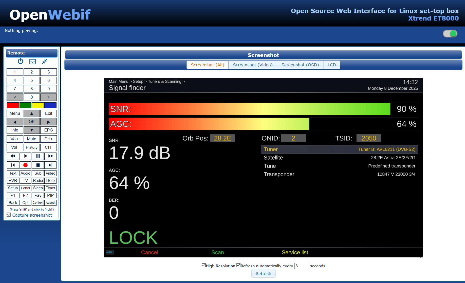

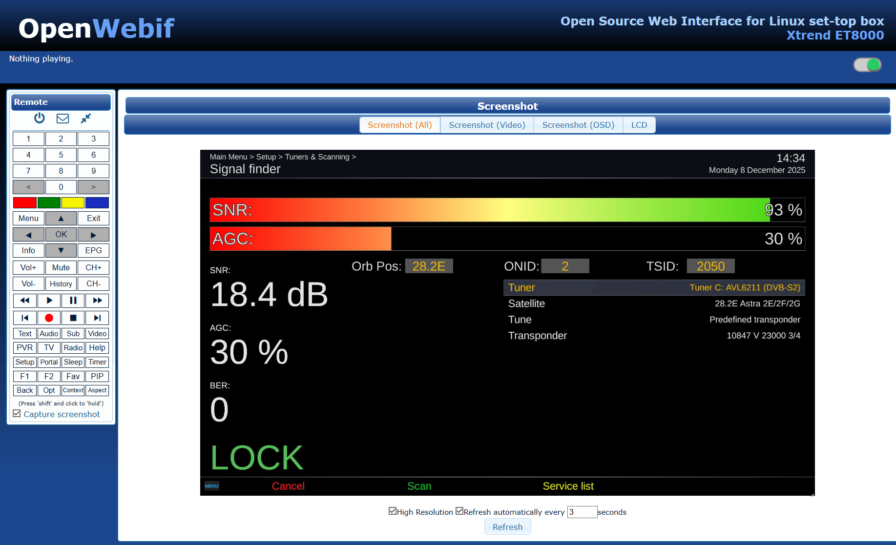

When i need to see if i have a bad signal and strange 2 different readings and might be from 2 dishes.
