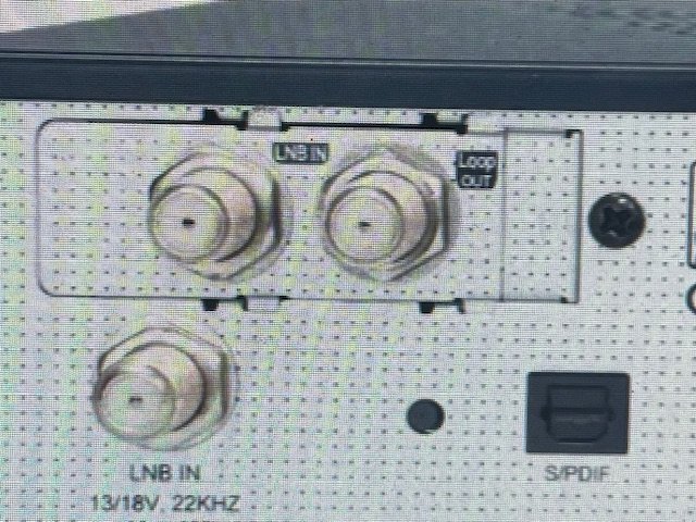

That box has 3 f connectors at the rear and one of those is loop out. Its easy to think the 2 at the top are the tuners but its only the one on the left see pic. Can you confirm you have the 2 on the left connected. Its an easy mistake.

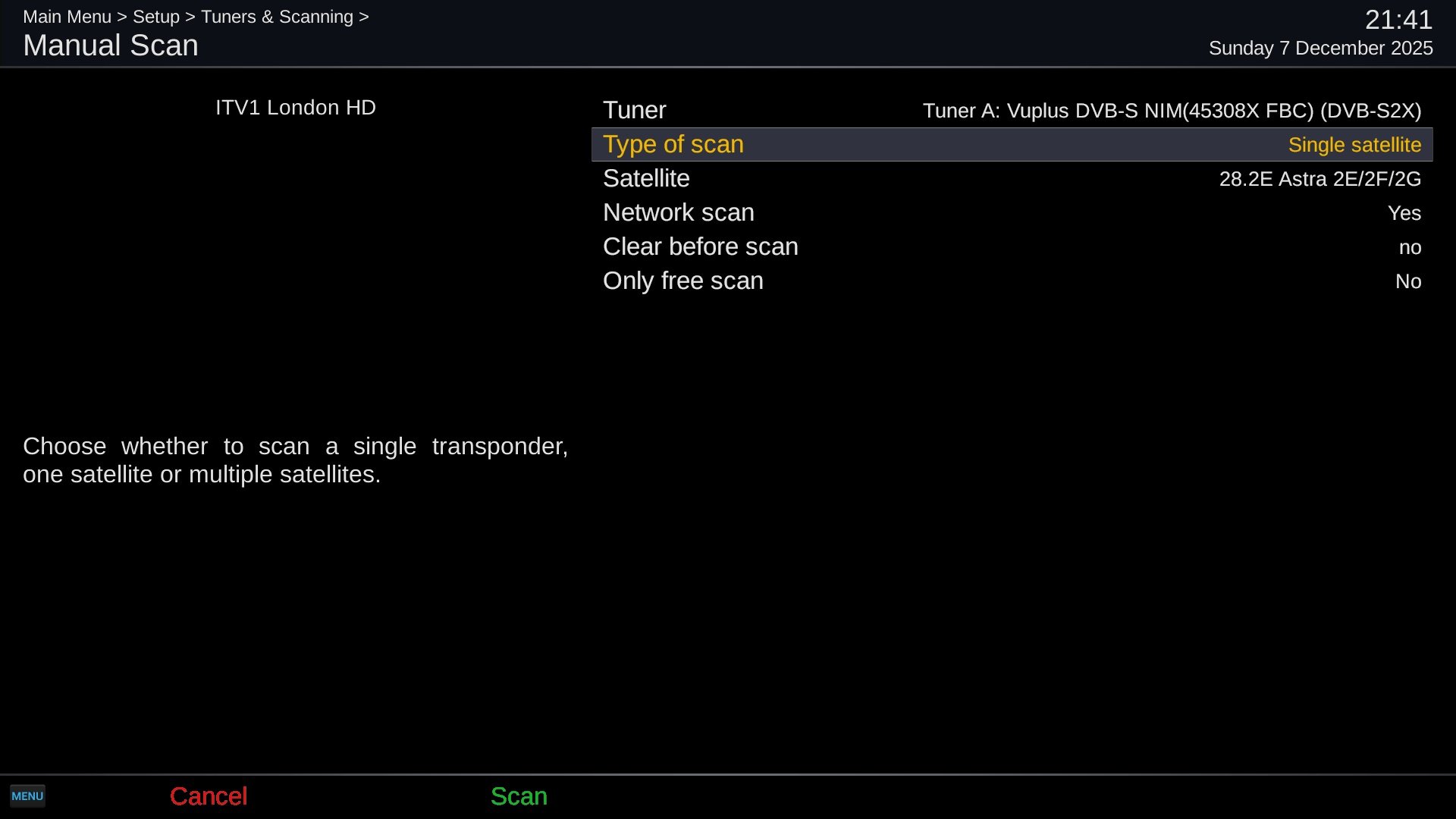

The scanning options should be as pictured here.
If you are getting less than 670 channels on a scan from a tuner, there is a reception issue with the equipment connected to that tuner. This could be dish, cable, lnb etc.
Change the scanning option from a single "user/defined transponder" to "single satellite".

Please change it to single satellite. Press right or left to change it. Post a screenshot of the scanning option you are using.
We want to establish if you have a reception issue. Scanning a satellite is the simplest way we are going to do that. Lots of people check one or few transponders and declare they have "good signal" when they can't receive other transponders properly.

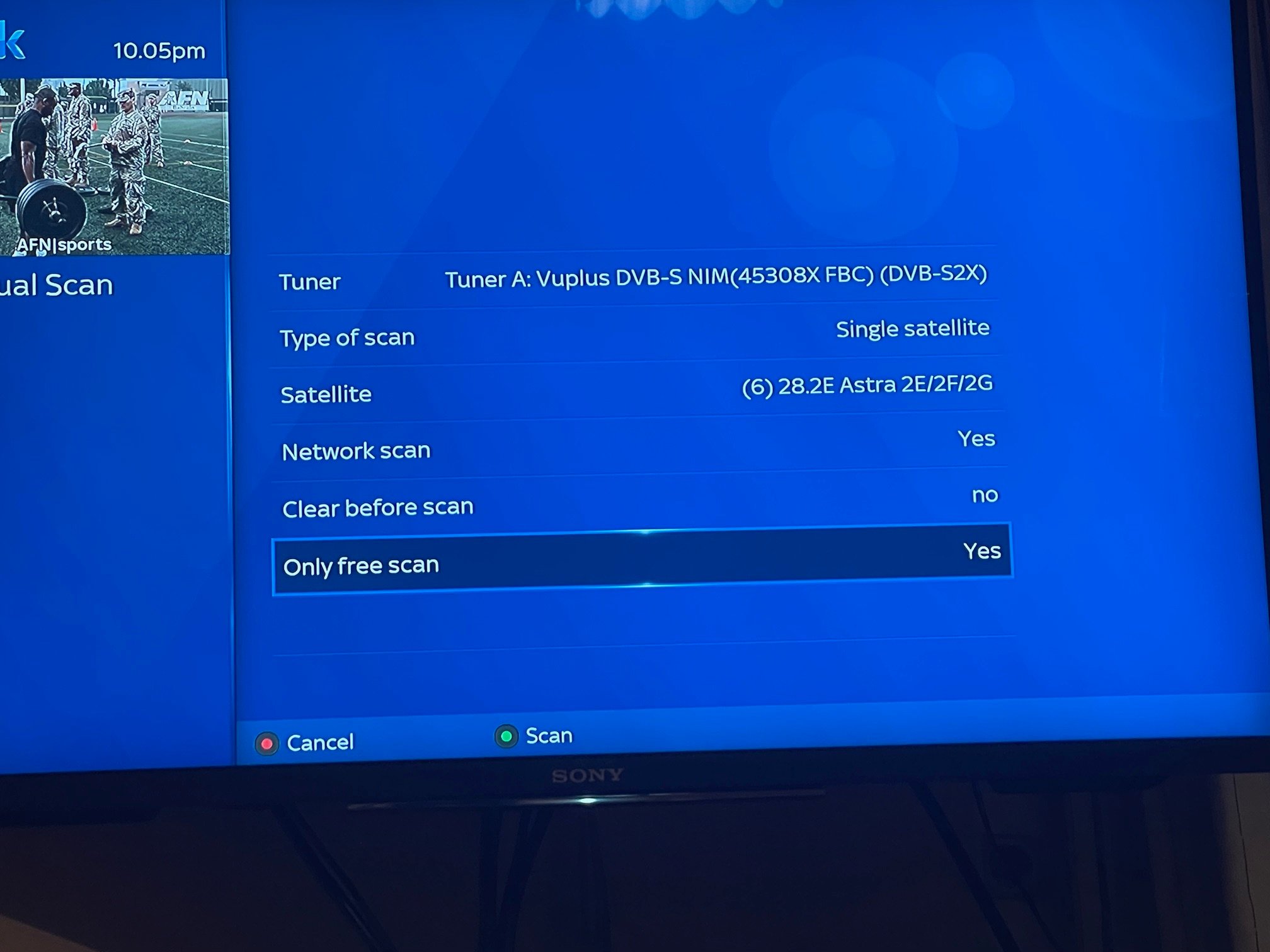

When did you change lnb? It appears to be a signal issue or you are on wrong pararmeters, ie scan the satellite not just transponders as Abu shows. Here is my pic and I would say FTA Yes, you dont want all the encytpted channels,
Type of scan toggle to single satellie ie use rght arrow
Please don't enable the FTA option. It's going to skew the results. We are diagnosing an issue, not setting up you receiver!
The encrypted channels will get added in by background scanning anyway.
