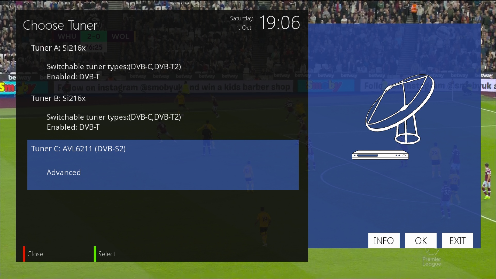

Have you setup the tuner similar to this
Simple
Positioner
And then enter your coordinates

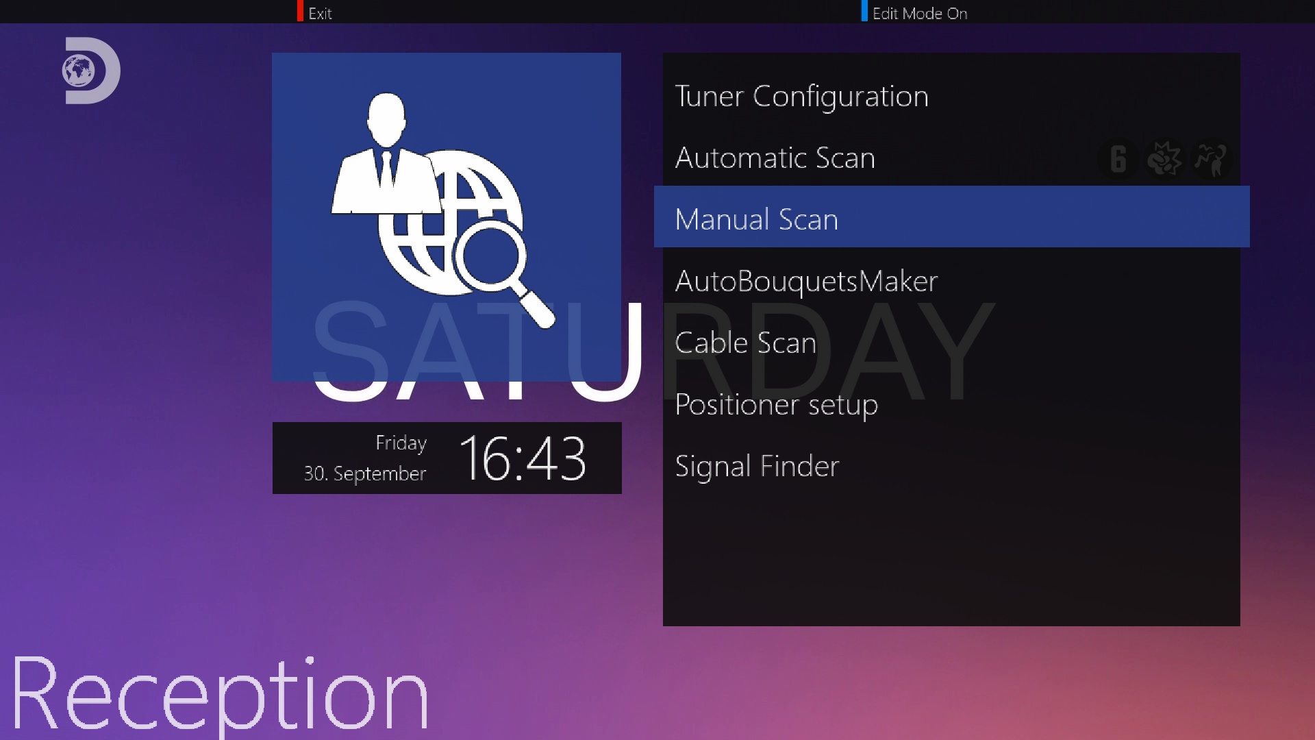

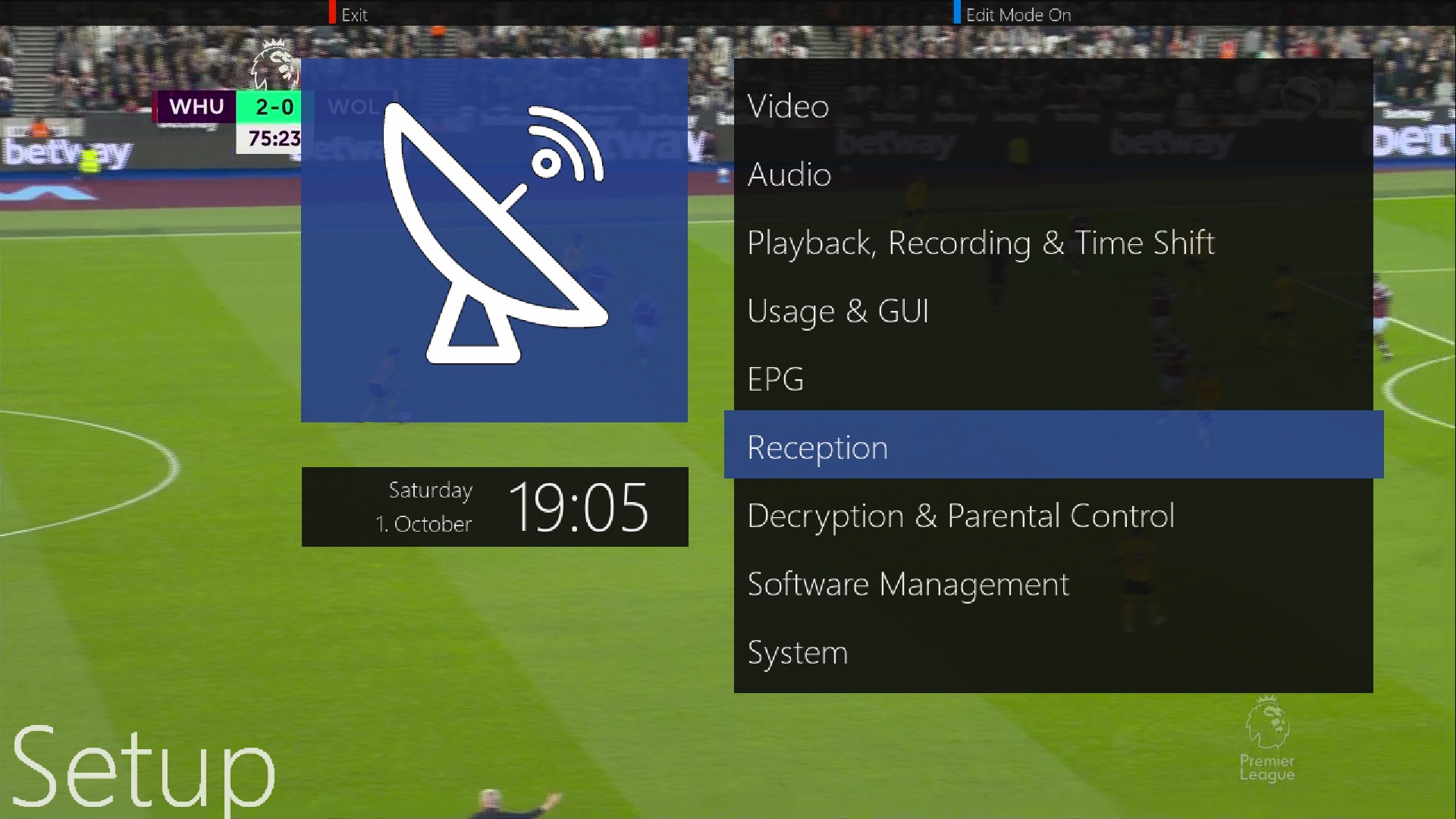

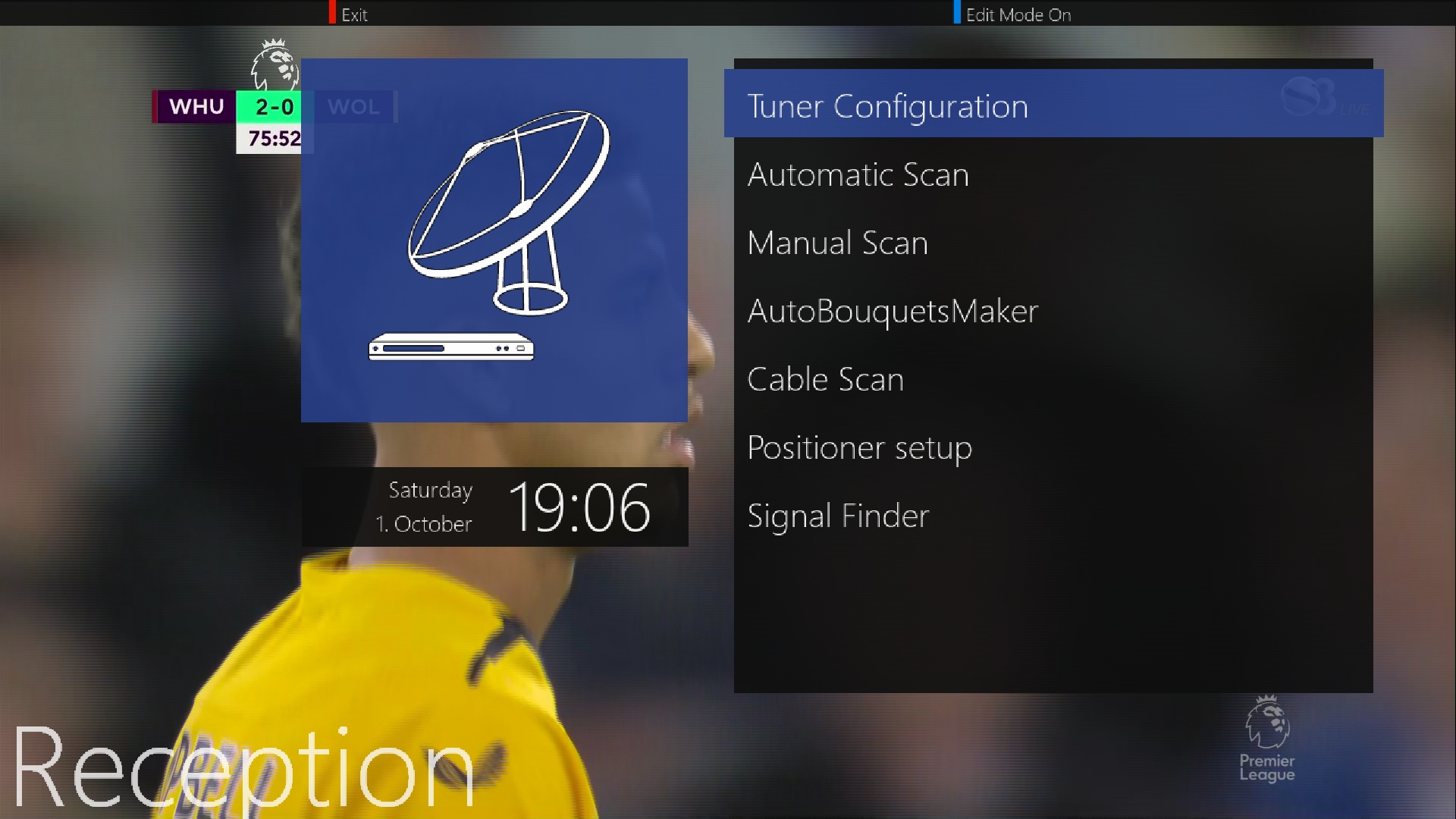

I can not see Setup-Reception-Tuner configuration-select the tuner DVB-S2

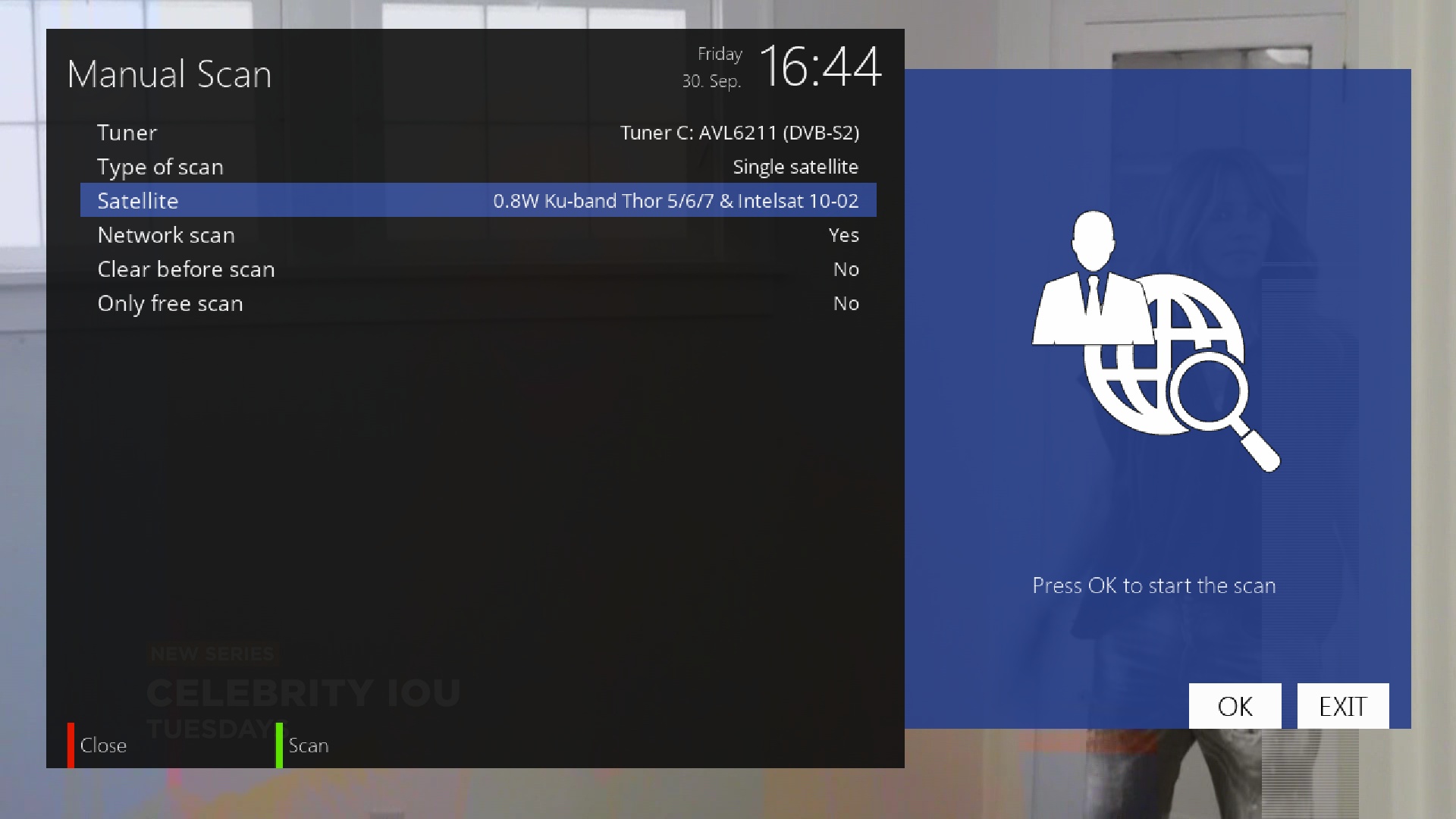

I only can see this in manual scan
So when you try to scan a sat does the dish move to the selected sat?
you are choosing KU Band?
I think no,but works manual.

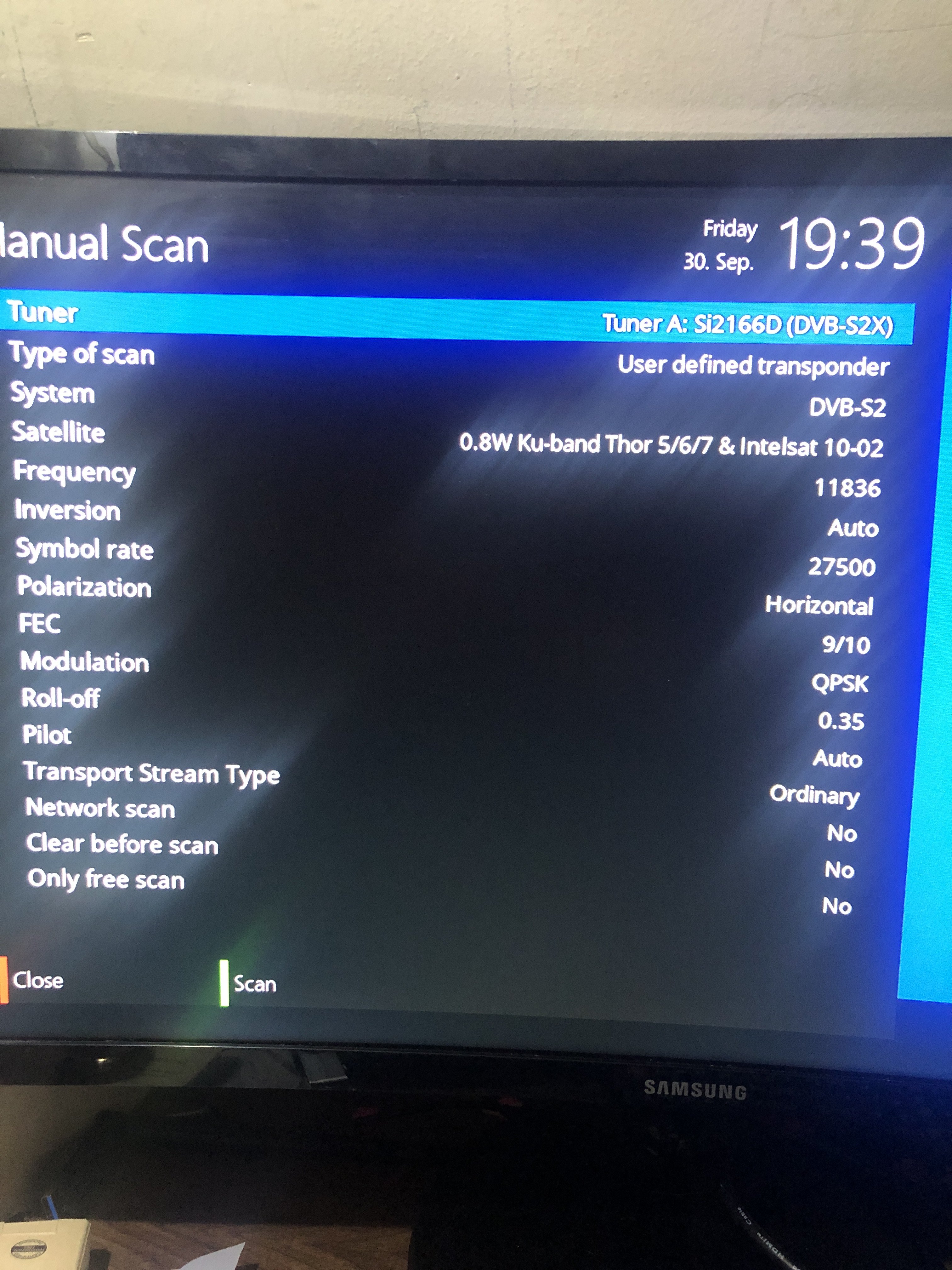

the softcan works fine now, thanks, I have tried the simples mode and nothing,if I put my old box is working very well,I have noticed on Tuner configuration is DVB-S2x when I scan any channels also in signal mode there isnt any signal.

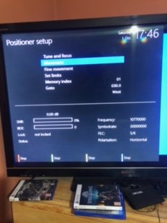

Just select that tuner and set it up for the motor,at the moment it is set for a single sat on 30 west.
I have set the motor before like you said at begin but did not work so I tried just single too.Also I have tried move the motor manual to find signal, but signal

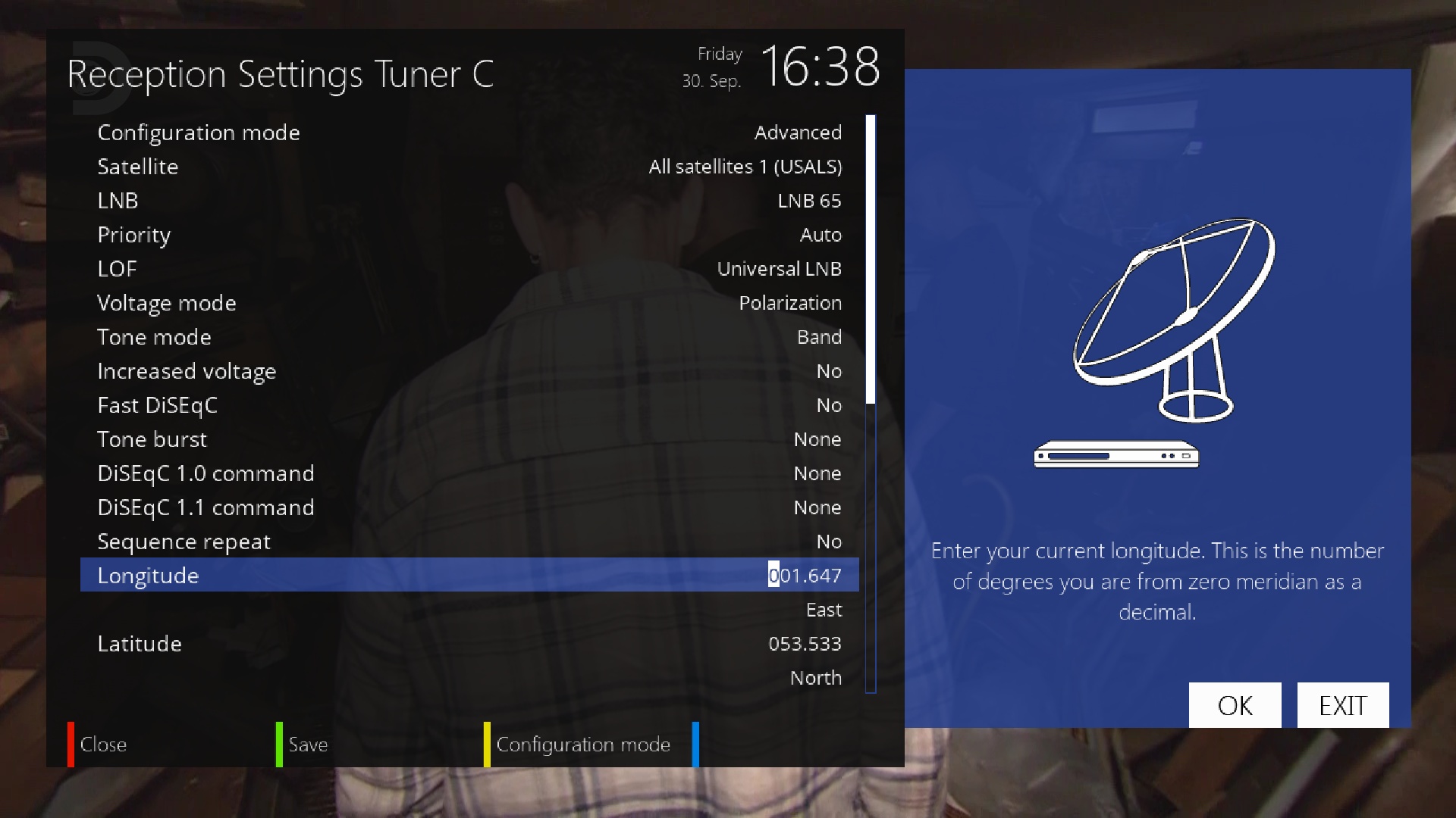

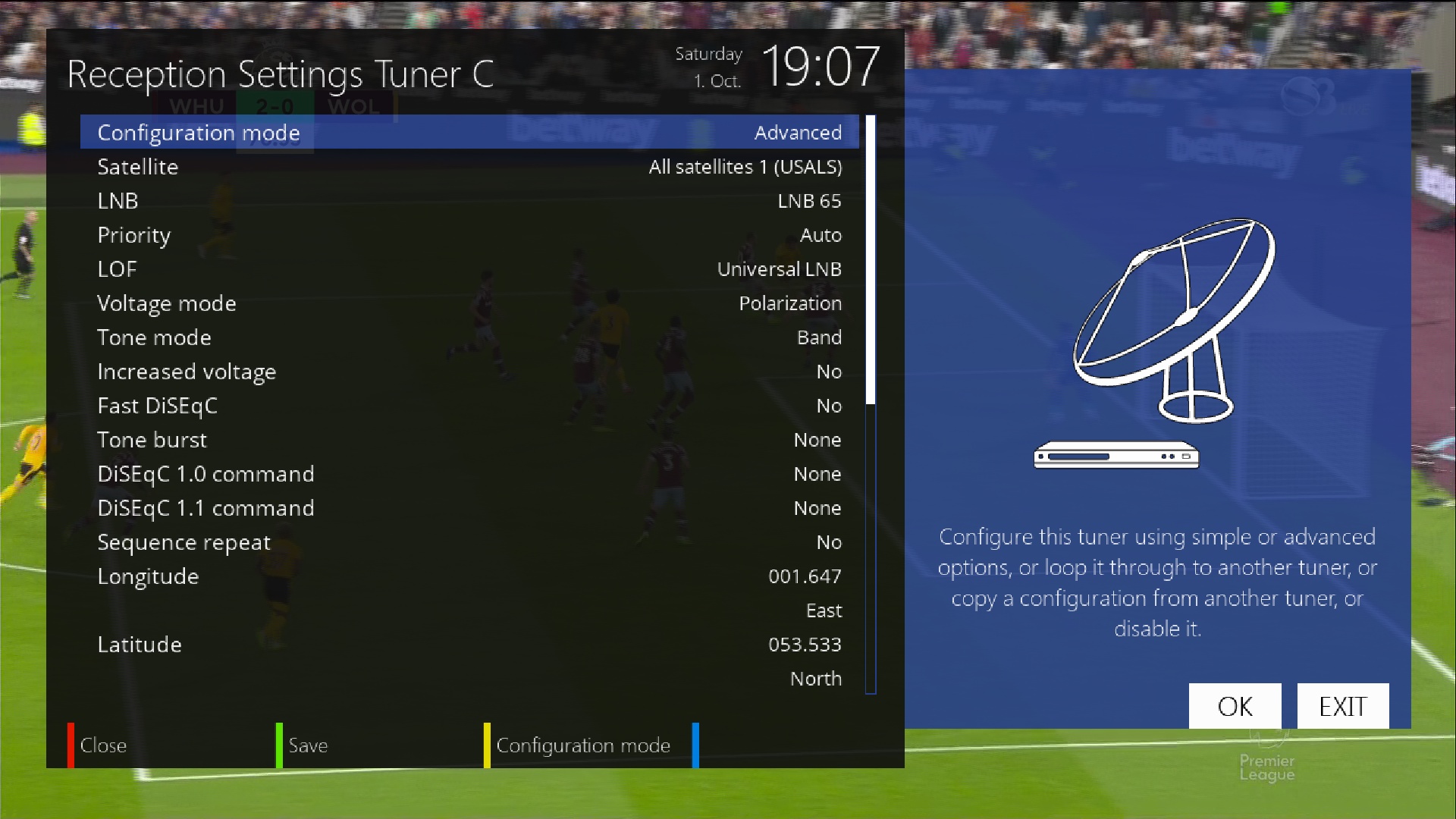

Set the tuner up like this with coordinates for your location

When you setup like this and saved your coordinates. Did you physically check the dish moved when you selected a channel from your channel list ?
Sorry no, because don’t have any channels on,before I had openplin in single mode because I couldn’t setup the motor, last week I decide to try again, but when I move the dish I couldn’t put back the single sat, that is why I decide to try just Openatv, but still no channels and no signal
